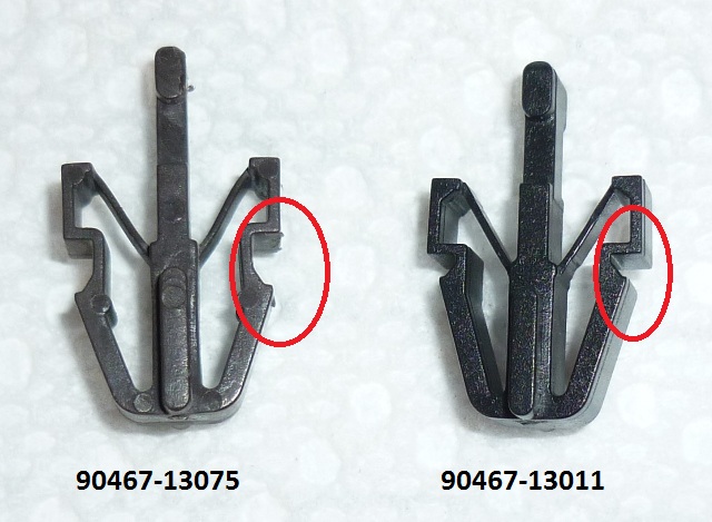

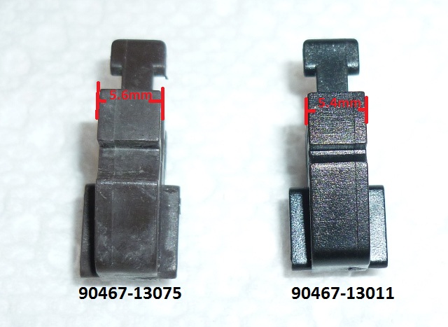

I ordered the much cheaper 90467-13011 clips - $11.38 for a box of 25. They work perfectly. In the photo you can see that the part of the clip that locks into the bumper is narrower on the 13011 clips but they snapped in solidly. Looking at them sideways, they are also .02 mm narrower but that could also just be within manufacturing tolerances.
