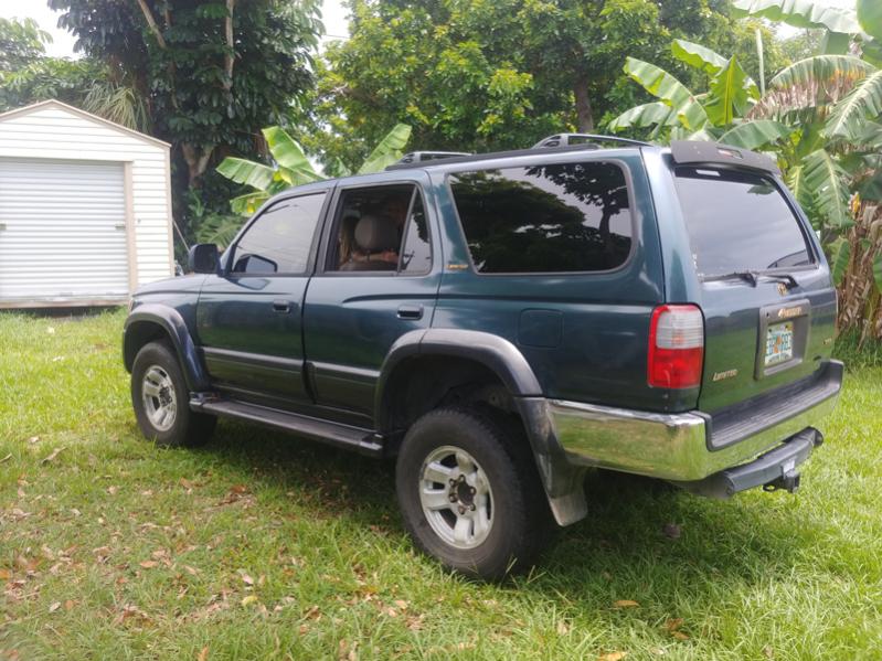

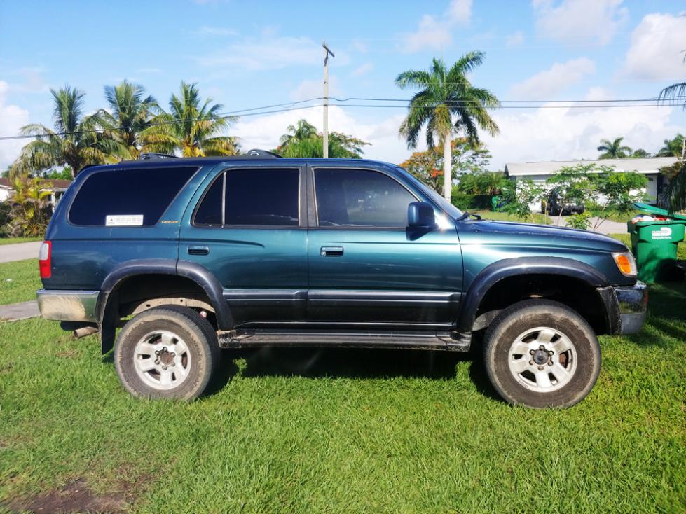

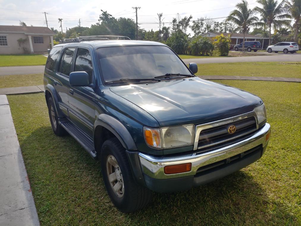

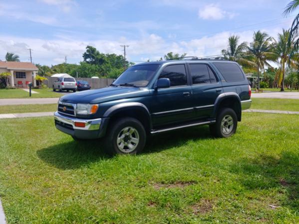

Hello everyone. This will be a long term slow build. I have owned this 97 limited 4x4 for 4 years now.
I need to address repairs first and then upgrades can begin.
First two repairs are adding a whip antenna. The motor went out on my power antenna and I want a simple replacement antenna.
Second is my sunroof. The adhesive failed and it popped open on the highway one daym after teying different adhesives I had had enough and decided to jbweld that mfer shut. I want to take it apart and get it working properly.
I also need to replace the tired hatch window motor.
Eventual goals will be to maintain oem reliability while adding as much off road capability as possible.
My rear end seems to be sagging. I may have to adress this soon.
I want a truck that is Toyota dependable while being a capable truck that will get me into a hunting camp and back. No mudding wheeling or fun stuff just rock steady dependable and capable.

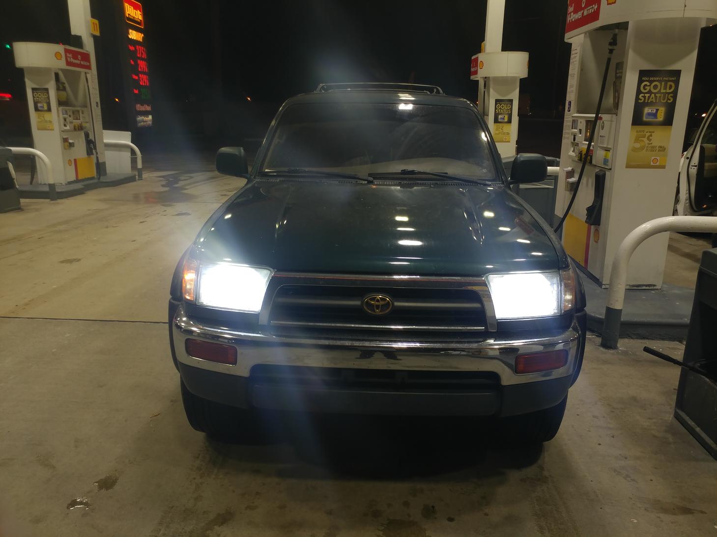

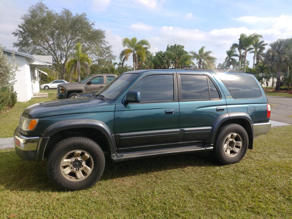

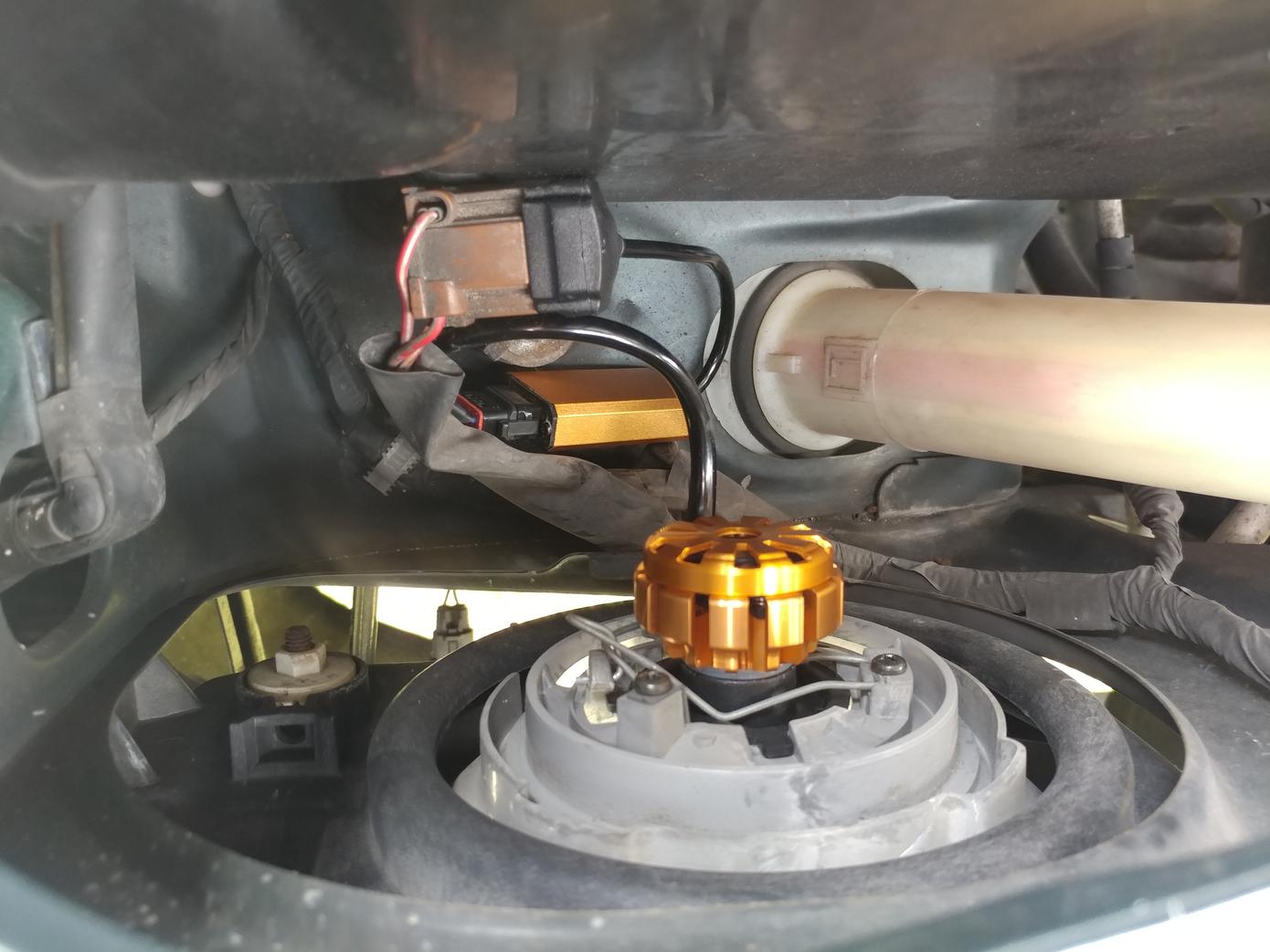

More pictures. Only real upgrade so far is the Auxbeam F16 LED headlight bulbs.
So far I haven't been flashed for glare and they are brighter than stock.

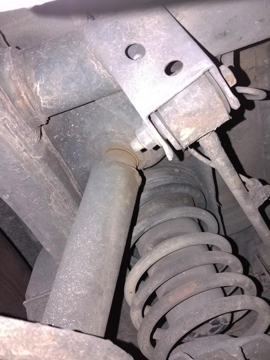

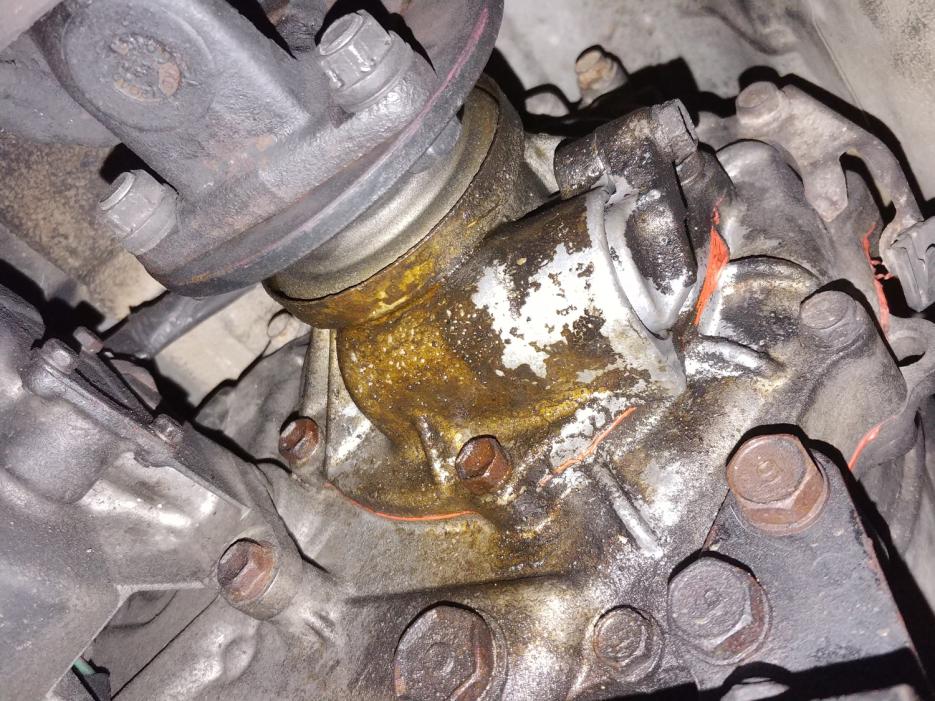

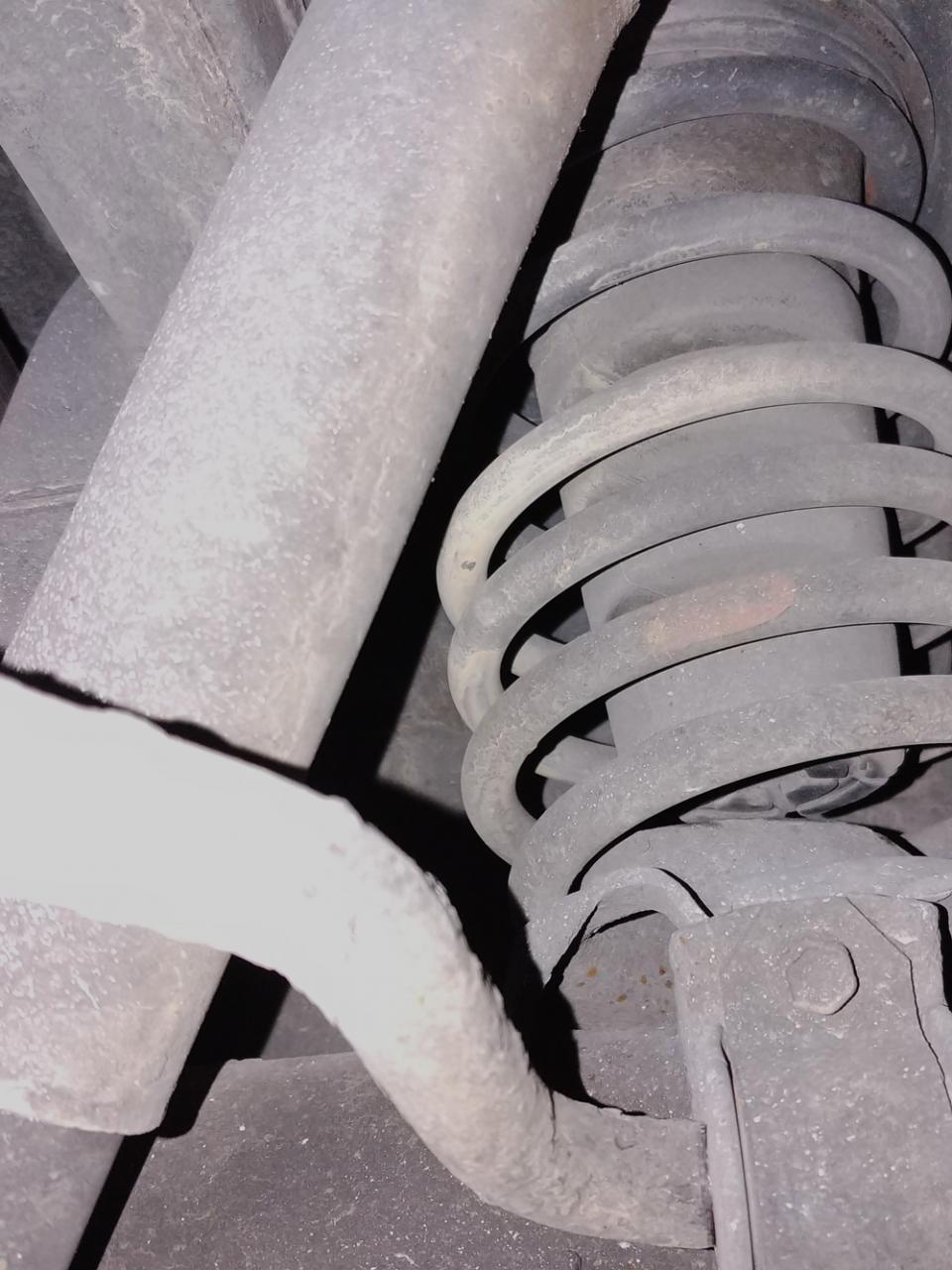

I had to replace the seal on my rear o2 sensor and while I was down there I noticed a few issues that need to be addressed.
My transfer case's rear output shaft seal needs to be replaced, it's leaking bad. Also my suspension can no longer be ignored. What I thought was just rear spring sag turns out to be a completely shot suspension. I am going to need new springs and shocks all around. I have already ordered some LC 9 wraps for the rear. For shocks I am not sure out back but fronts will be 5100s with 99 talls.
I also need to take real good look at the front end and see if anything needs to be replaced immediately, TRE etc. Lot's of maintenance issues at this point.

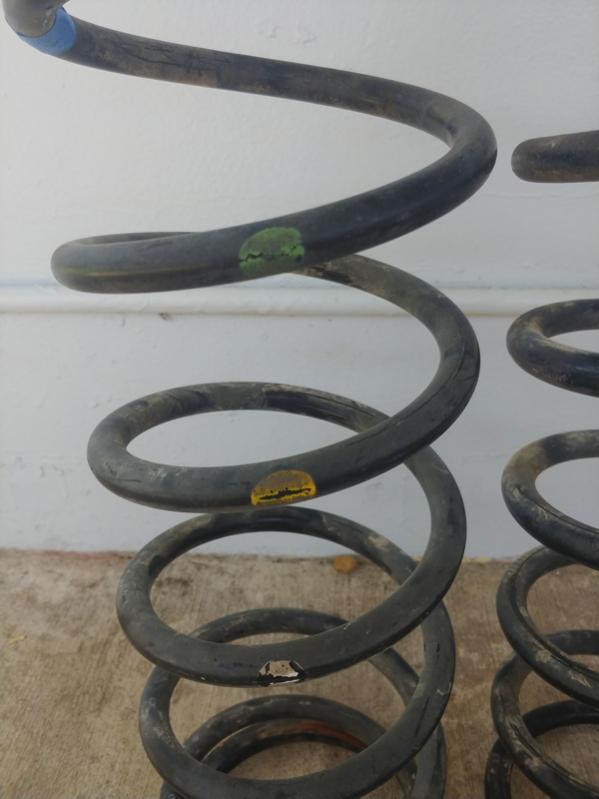

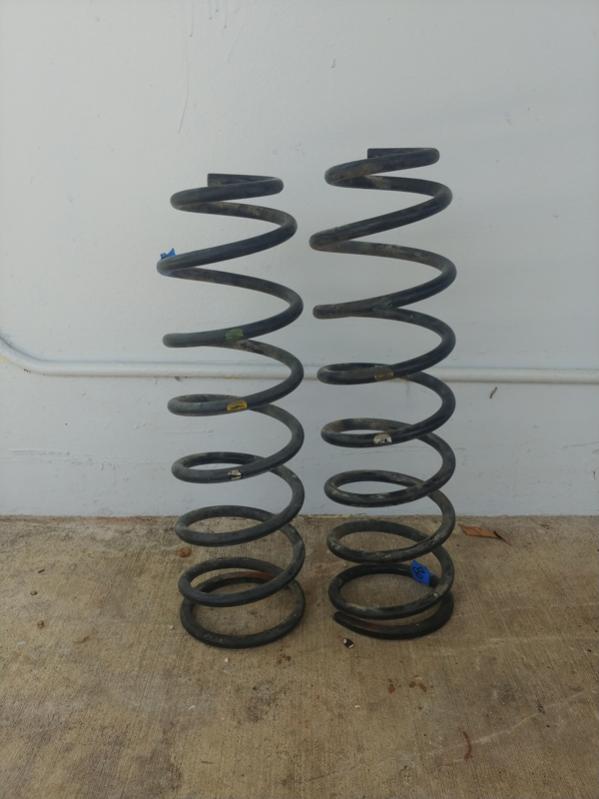

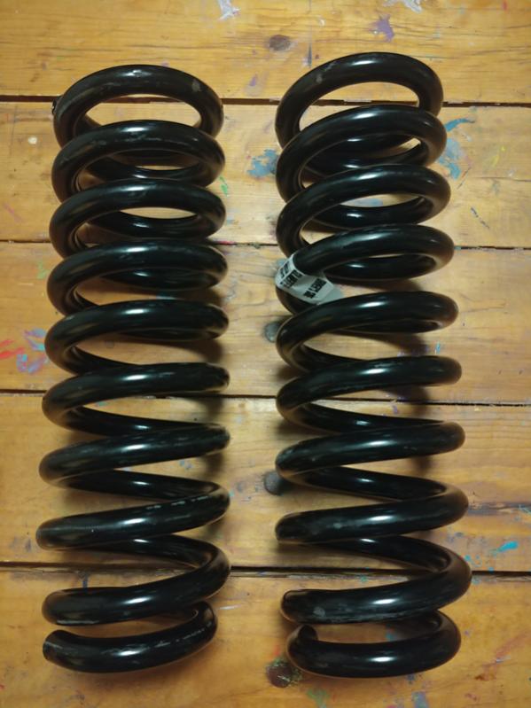

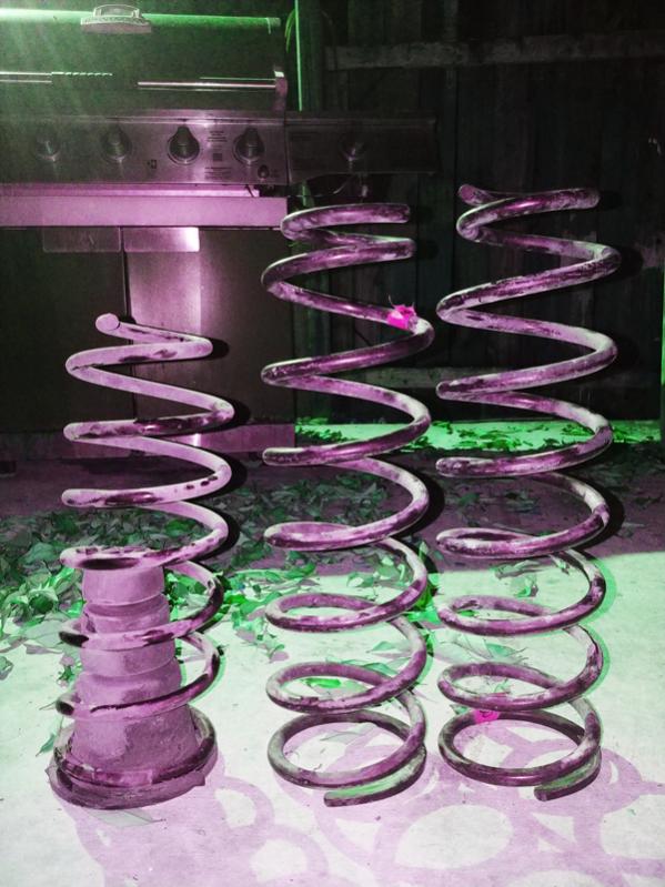

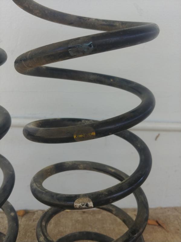

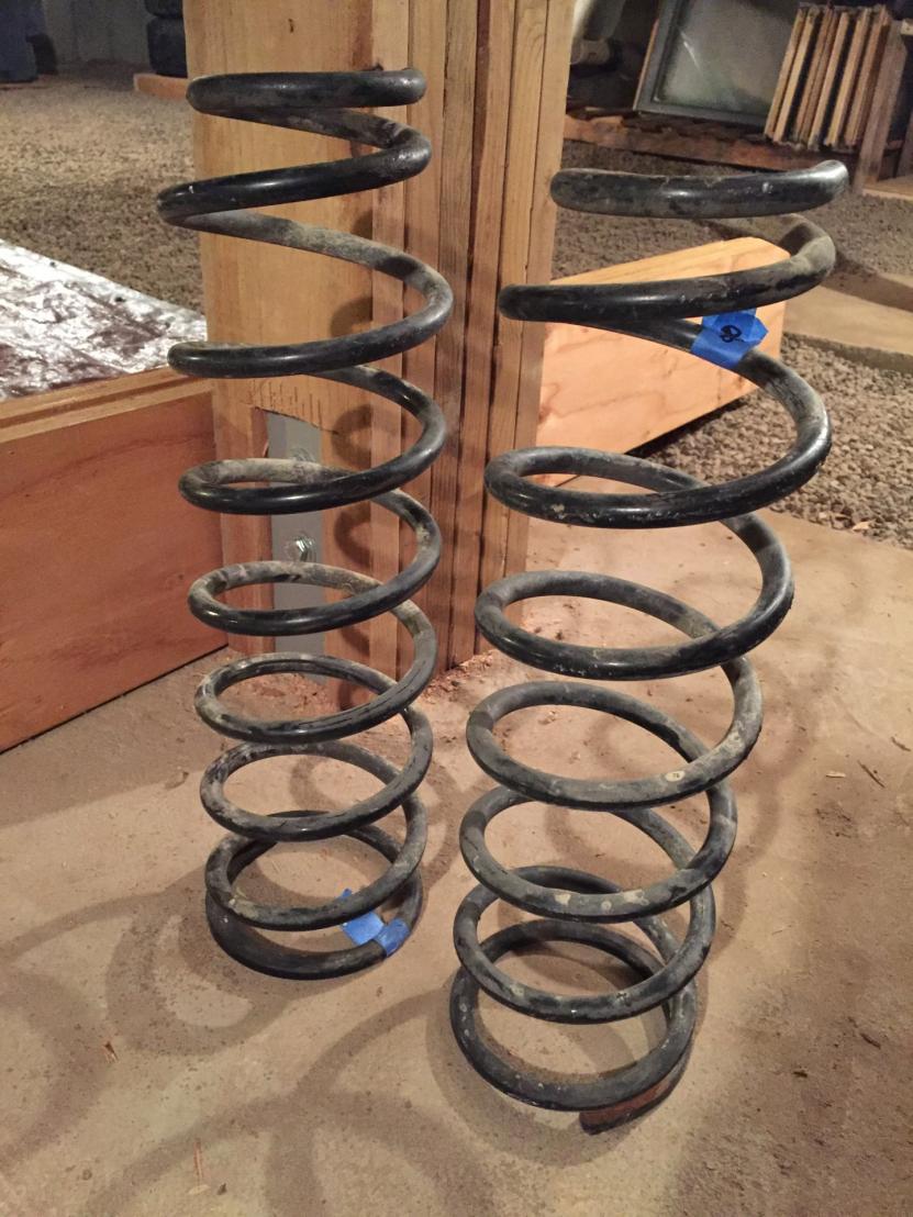

Coils came in. Passed the doggo inspection. Color codes are blue yellow white and green yellow white.
I am guessing these are off a Lexus LX450 as per the codes in the ID thread
20.25" Blue Yellow White 8.75 wraps-one of these is a confirmed LX450
19.5" Green Yellow White 8.25 wraps-one of these is a confirmed LX450
I hope the runner doesn't sit too lop sided but I am in dire need to get a functional suspension happening so these will do

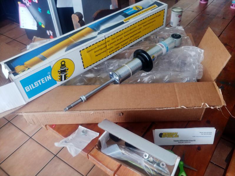

I got around to ordering the rest of the suspension parts today. Wheelers had a sale on the 5100s for $175 so I grabbed them and a diff drop also for $24.
I also ordered moog talls for the front and kyb gas a just LC rear shocks.
Install updates incoming soon.

Doing some late friday night solo wrenching. I am receiving the LC gas a just shocks tomorrow as well as the moog 81088 coils so I wanted to get a head start on the rear end. I was able to get the old saggy soggy spring out and I had to cut the old shock off because the nut was basically rust/welded to the old shock. I am praying the new kyb shock includes a new nut or I will be having to run around town looking for one.
The new coils are substantially larger than the old worn out 224k mile springs. The truck had original tokico shocks that leaked like hell.
My old lady told me to knock it off at circa midnight so I slapped a tire back on and dropped it sans shock to see what the new spring would do. It's a new truck immediately loving the new stance on this old truck.
I wont get the front 5100s until tuesday and install wednesday. I have waited 6 years for this.
I am going to keep the old springs and make knives out of them eventually.

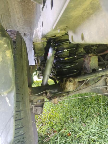

Picture update - 8.25/8.75 wraps are in along with LC KYB gasajust shocks. It's nice to have a working suspension again. The LC provided BIG lift. Right now the rake is ridiculous but I won't have another chance to install the front until Wednesday. However It's got me realizing I am not going to mind a bit of a rake. I need to read up on how to do the diff drop. Onward.
moog 81088 fronts
These suckers are heavy and thick. I hope they hold up I've seen mixed reviews but generally positive.

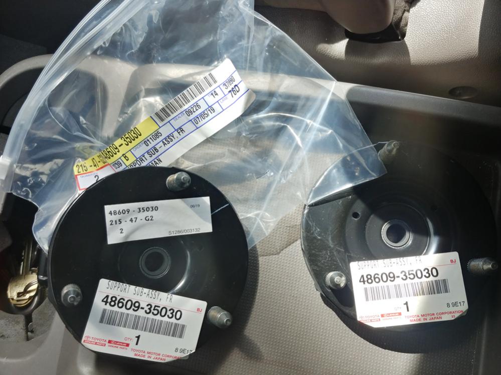

Gather round for a tale of horror, sadness, and pain. I started breaking down the front suspension on Tuesday night. Everything was going easy until I got to the 3 top nuts on the struts. I applied PB blaster and got them moving but something wasn't right.
As I applied torque the nuts would budge and spin but after a while I noticed they weren't traveling upwards at all. The nuts were so seized they sheered the knurling that holds them on to the strut mount. They nut was bound up and the bolt was just free spinning in the mount, they weren't coming off. I ended up having to spend the next few hours carefully cutting the nuts/bolts off finally got them with a dremel carbide bit as the space was too cramped for my grinder to reach the innermost nut.
I got everything off on wednesday morning and began assembling the 5100s and springs. I ordered new top hats from autozone and put everything together, I thought I was in the clear but it became evident immediately something else was wrong. The duralast mount was built just about 2mm wrong, every bolt refused to line up with the holes on the truck.
At this point I knew I had to disassemble the strut return the duralast mounts and order them from toyota.
Of course however... now that the entire strut was assembled my spring compressor refused to go back in somehow.. I had to take the strut to a shop to have it broken down.
Dealership banged me out for $97 a piece but I was boned so I had to do it. I would have gotten some from a junkyard but at this point I was not about to play around anymore.
So here I am waiting for my new mounts to arrive so I can zip her back up. I really hate not being able to finish such a simple job in 1 day and having to wait for the new mounts. I'm trying to remind myself she is going to be much better off in the end though. /rant
picture dump
She's finally done! Bilstein 5100s and moog 81088 up front, LC 8.5 wraps and LC KYB shocks out back, Wheeler's diff drop, new OEM front strut mounts.
I need to find 2 more center caps, missing 2 is bothering the heck out of me. Up next is the transfer case input shaft seal, then going to put some hid lamps on the bumper, then going to change every fluid in her 1 weekend at a time.

Hey what 5100 did you use and what setting ?
Bilstein BE5-D558-TO
Wheeler's lists them as for the 4runner but I believe these are the same as the Tacoma. The tundras are a different part number. I have them on the highest perch. Ride is firm but pleasant.
