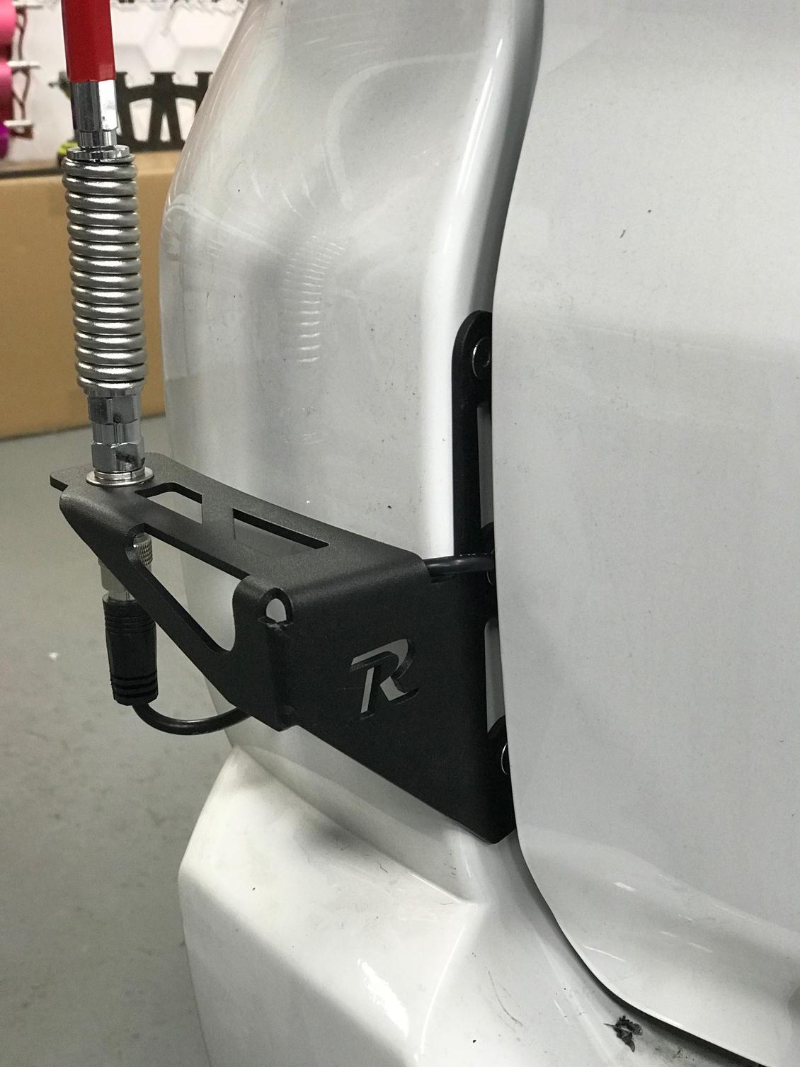

Hello Friends,
How did you ground your Rago CB mount ?
Since it's installed sandwiching the plastic bumper...
I'm guessing I also need to strip the paint by the mount/antenna mating surface
Thanks for your input :)
:pray:

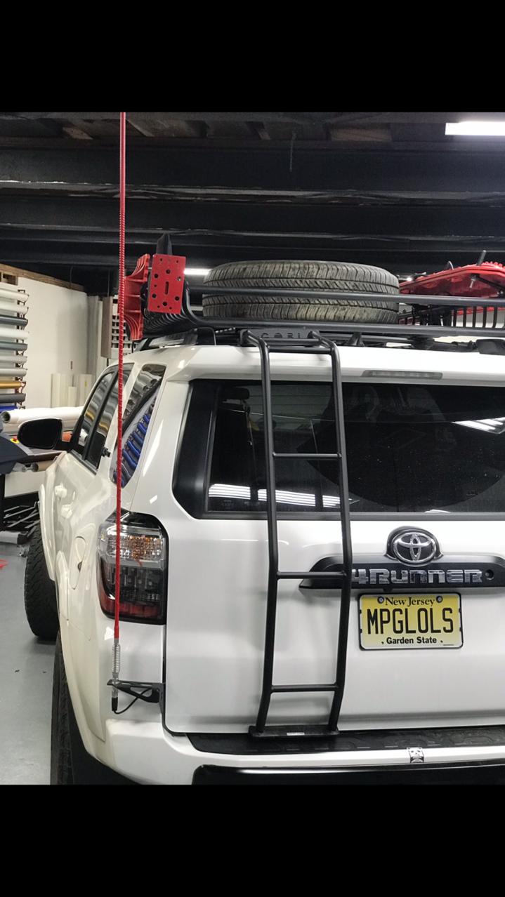

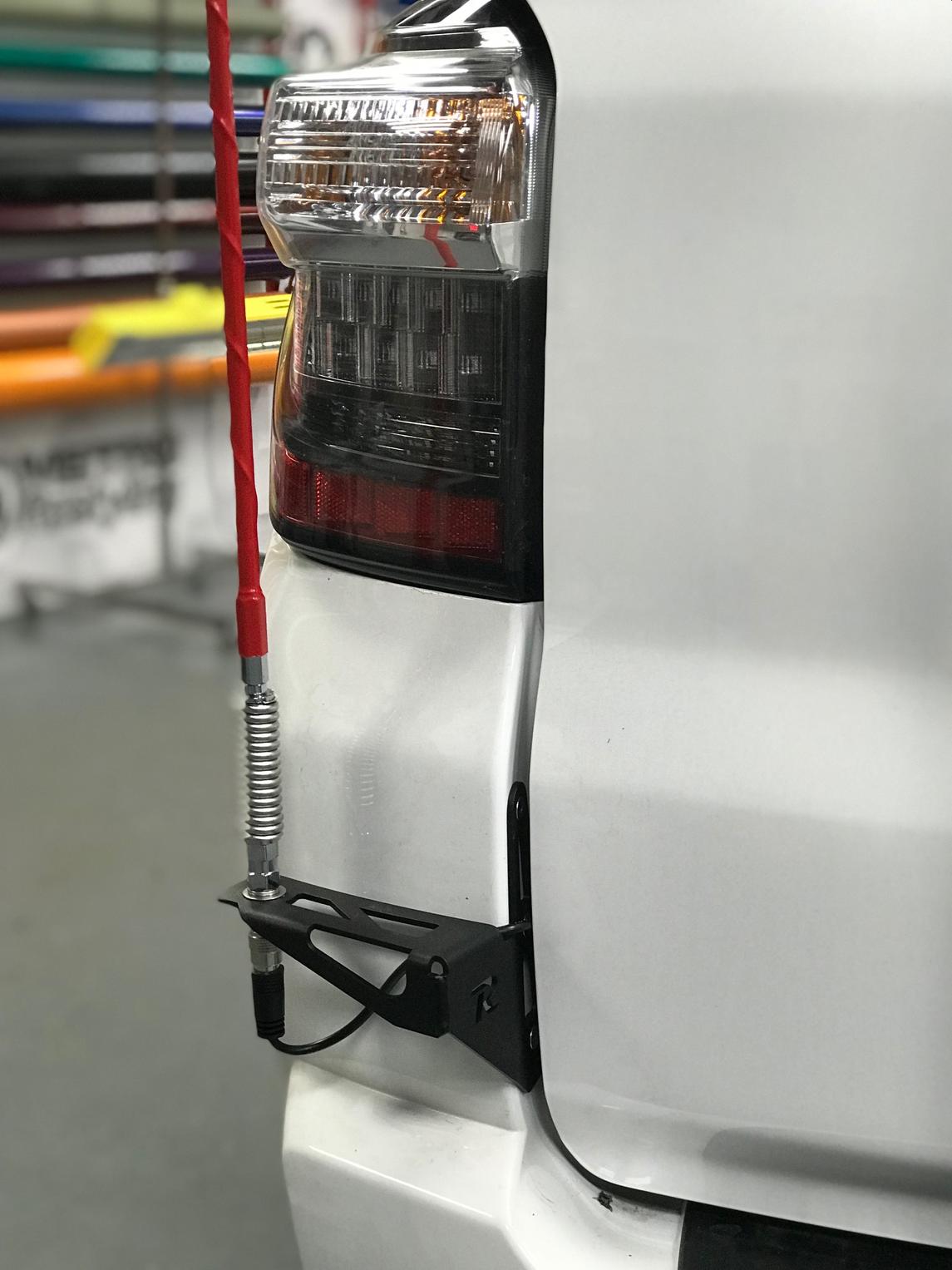

I will be using the Rago Antenna mount with a Firestik, just like in this pic:
maybe ill just run a strap with the antenna wire?
Ill be doing a new rear bumper so this mount will only be temporary but i would like to get this working already lol
