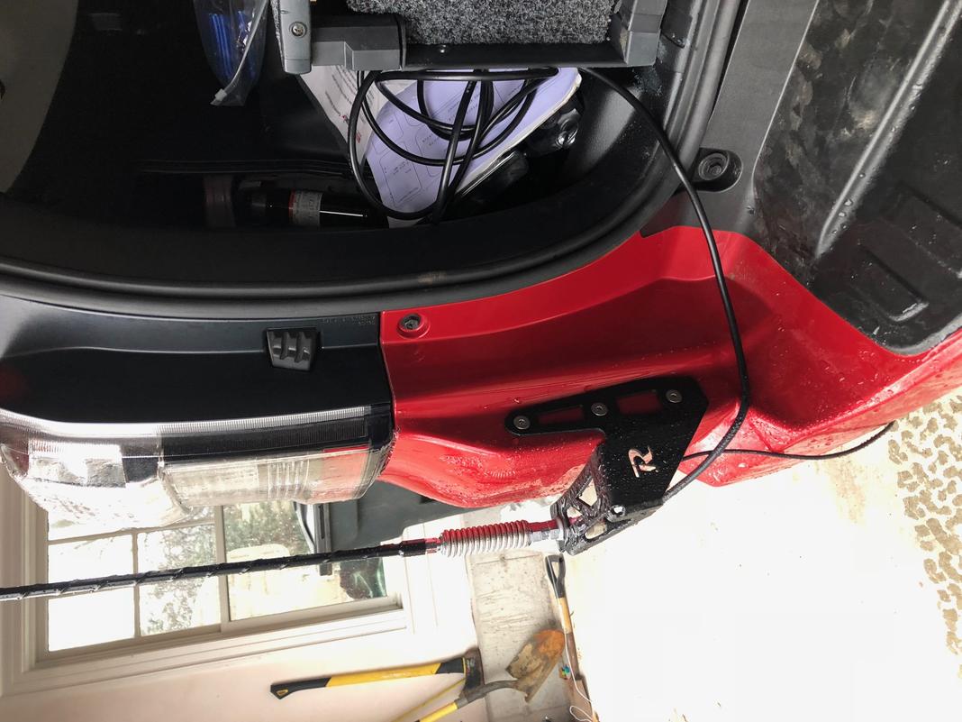

Spent a good couple of hours last eve trying to get this resolved. The mount looks great, but it is 100% blackcoated. I filed off the bottom of the bracket to try and get better contact with the mount. The mount makes no contact whatsoever with any component of the body chasis. In order to get ground I have temporarily wired directly to the frame. And I do get good ground when tested on a multimeter.
I still get awful SWR. Above 3 on all channels. I have checked the cable as well as ground of the unit. My guess is that there is very poor "grounding plane" from the mount. My only other thought is I trashed the unit checking so many times with high SWR. I'm gonna give it another hour or so before I just head over to a CB shop later in the week and let someone with a lot more knowledge than me trouble shoot it.

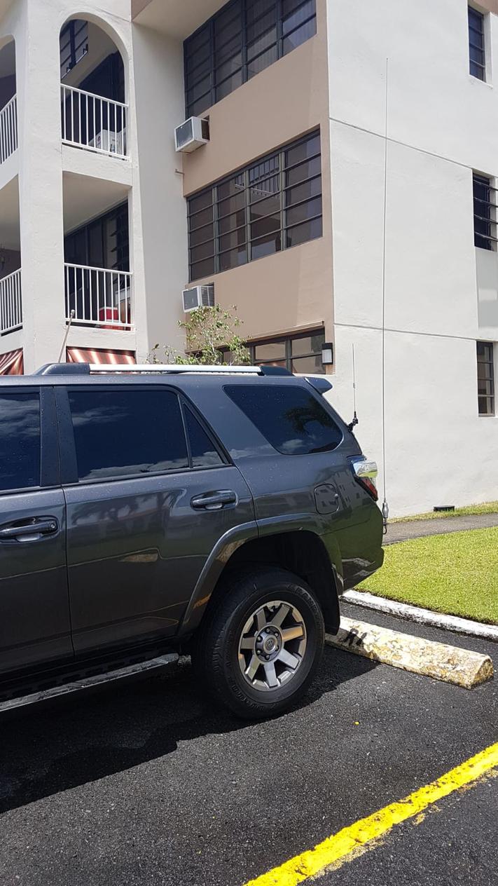

Hello guys,

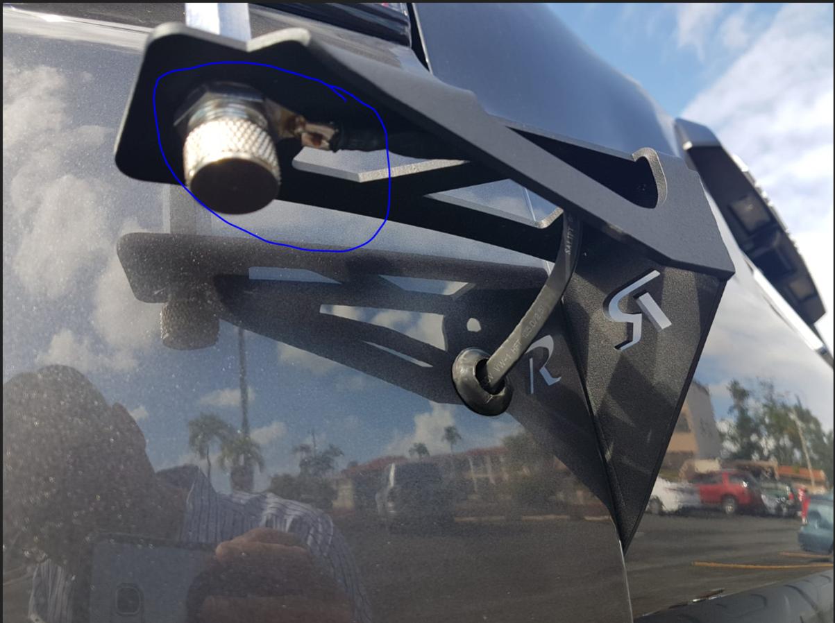

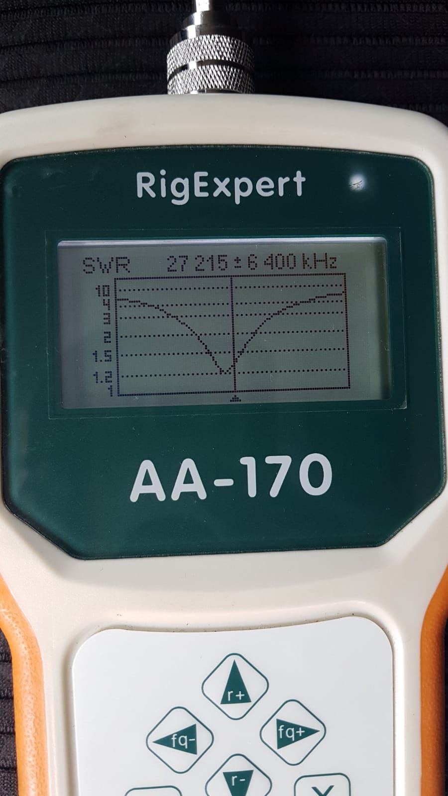

I successfully installed the Rago mount + CB antenna and got it work just right, key is grounding.
I used the Firering cable from Firestik, but the principle is the same with any other cable.
I had to sand down the beautiful Rago powder coat where the firering makes contact with the bracket.
Also on the bracket backing plate, I drilled a hole and installed a flush bolt from which I ran a bonding strap to the trucks body. I will try to provide pictures but the area is pretty hard to access afterwards.
Hope this helps.

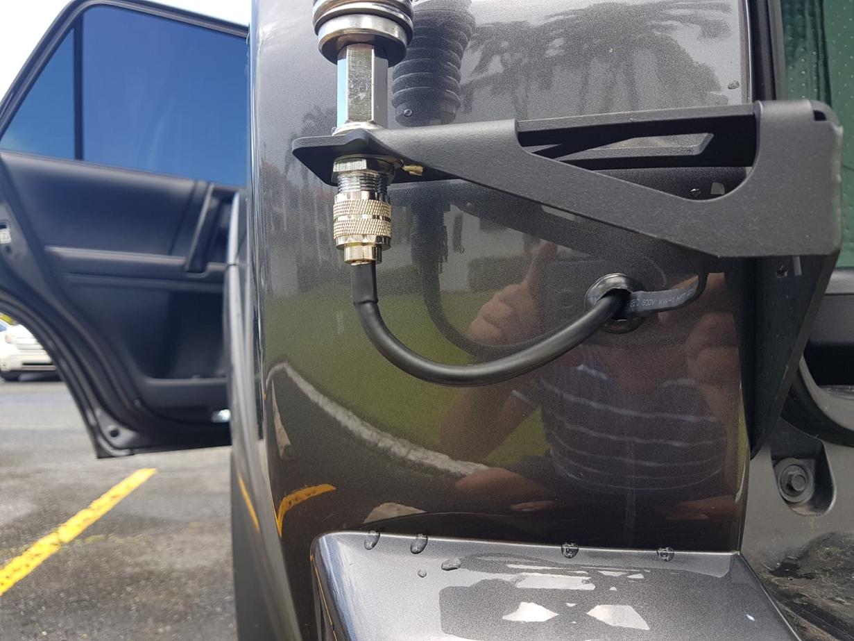

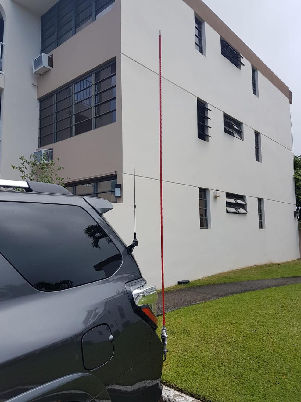

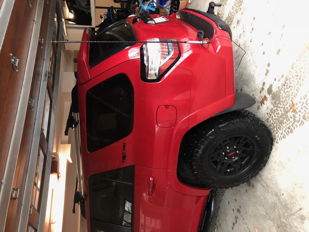

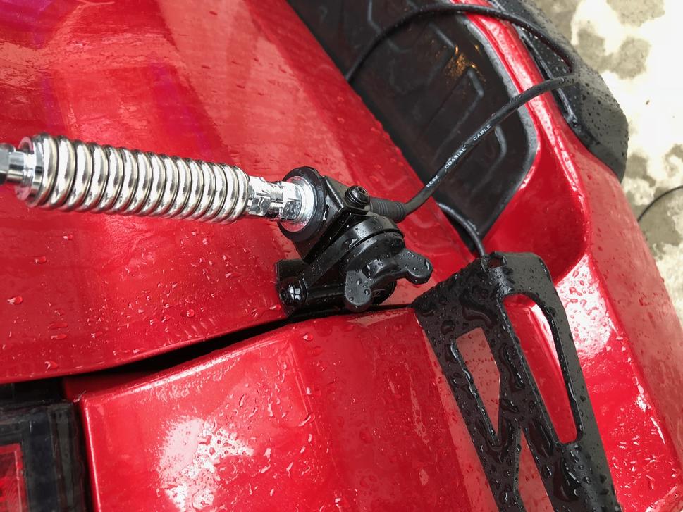

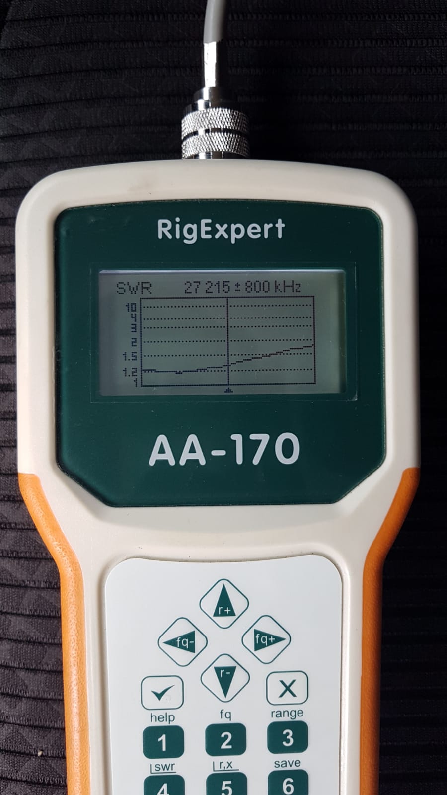

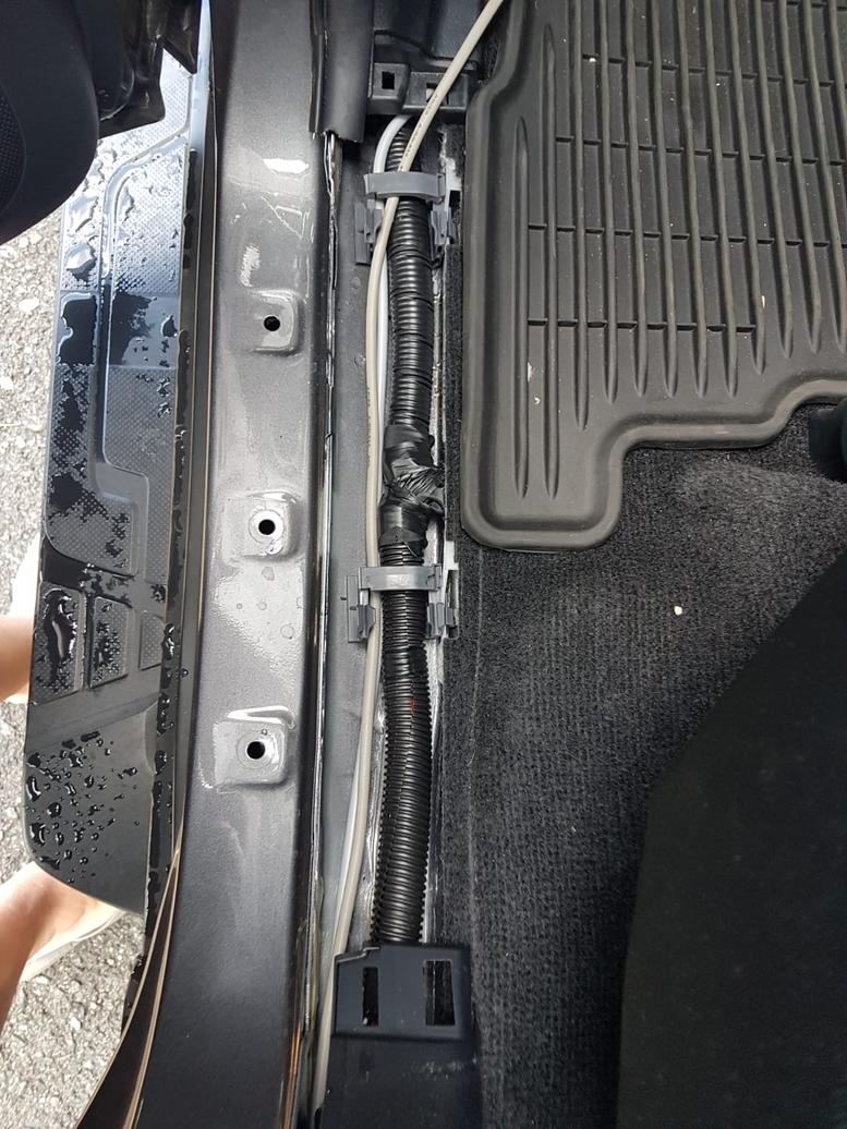

The y key to make it work and lower your SWR is getting good ground. I drilled a hole on the bumper beneath the mount to bring the cables inside the car. Used 1/2" copper braided flat strap to ground the mount at two point, chasis and body. With that and some antenna trimming I was able to get the entire band with a Firestik KW6-R and also a 102" whip. Longest Bandwidth was with the whip. I also run a ham stick for the 20m ham band. All works great!

You don't have to reroute the coax the ground is what will make the difference. The Rago Mount lacks ground as it is mounted on a plastic bumper. In my case a drilled the hole because I didn't want to deal with the cables every time I opened a door. Ran the cables inside the cabin by taking out the rear driver side break lights housing (drilled a hole in body as well). The coax for both antennas is run inside the panels and ends up beneath the drivers seat were both connect to a Yaesu 857D. I used RG-8X coax and soldered the ends after running the cable. I'll try to take more pics today and post them. The issue is the ground, I was having the same issues as you did. Installed the ground cable and started to see the SWR dips. That's what I used for ground, found it on ebay with terminals an all. See the ground cable circled in blue. I used heat shrink tube on both cables for weather protection.

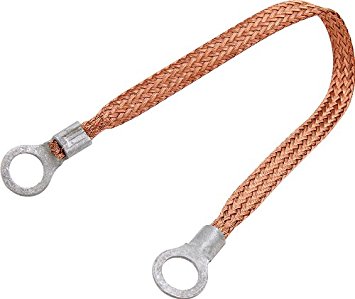

The product page says this is their recommendation. A grounding strip.
"We recommend a 5ft Firestick, stainless steel spring with ground, and a braided ground strap."

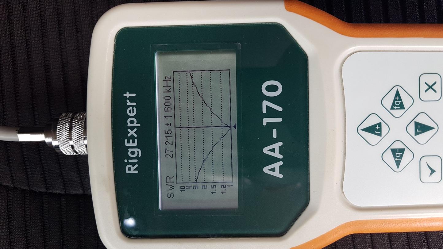

Mine is grounded to both the chassis and body. SWR below 1.5 on the entire band.

I have two ground straps connected to the base of the antenna. They are both about 2.5 feet long, one connected to the body and one to the chasis. It is getting the job done for both CB and Ham bands. Good luck with the install, keep us posted!
