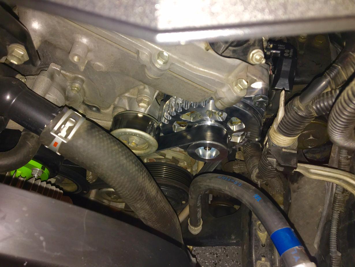

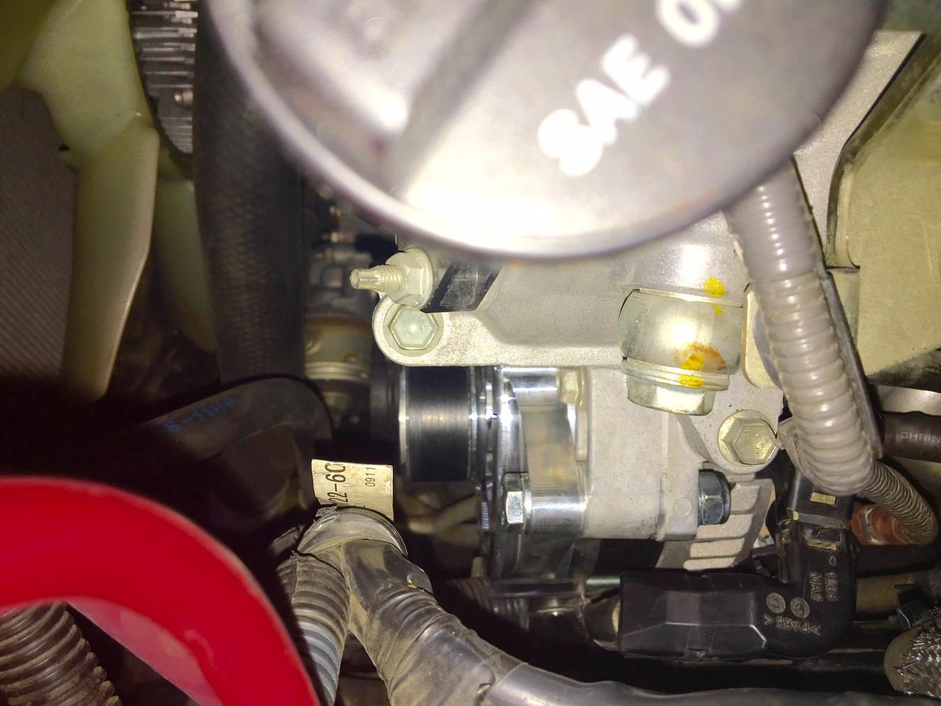

Couple notes...haven't read any details on this specifically, but the OEM alternator has three mounting points, this new alternator has two.
Had a tech do the install and change the serpentine belt (119K miles on the one belt and it still looked great!). You need to pull off any brackets from your old alternator and move them to the new one. There is a bracket on the back that holds a wire loom. It's tough to install after-the-fact, don't ask me how I know. Saw that this was not done by the tech so I went in to check on everything.
The new alternator is also missing threads to bolt the main wire harness to the alternator body...OEM had two 10mm bolts holding the harness next to the alternator and away from the UCA. I had to shift the harness to angle away from the UCA...looks like it has enough space now.
Anyway - pics:

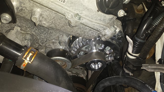

My bestest buddy from FedEx showed up today with a special delivery :clap2:
Disassembled last night after work, reassembled tonight, pretty straight forward.
