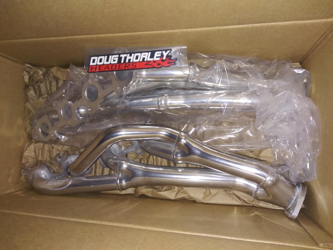

Yea I opened mine up to make sure I received the 03'-04' LTs, and not the later version. Everything seems to be included as far as instructions, gaskets, flange hdwr, etc.
I still haven't had my mail delivered from 2 weeks on hold, so the Titanium hardware might be in there. Anyone get theirs USPS?
I did receive 2 DT decals with the headers that I didn't get with my Y pipe last year. Come on DT! Spread some swag around!!

353136d1580134068-group-buy-doug-thorley-premium-version-headers-need-20-people-20200127_085842~2-jpg
Sexy pic! Looks good. Yes, the Titanium hardware has to ship separate. My plan originally was to ship everything to Doug Thorley and have them put it in all the boxes but it couldn't be done that way so shipping the Titanium hardware out separate, etc. Anyone can text me at 717-319-2100 if you are still waiting on hardware and I'll check for ya.
