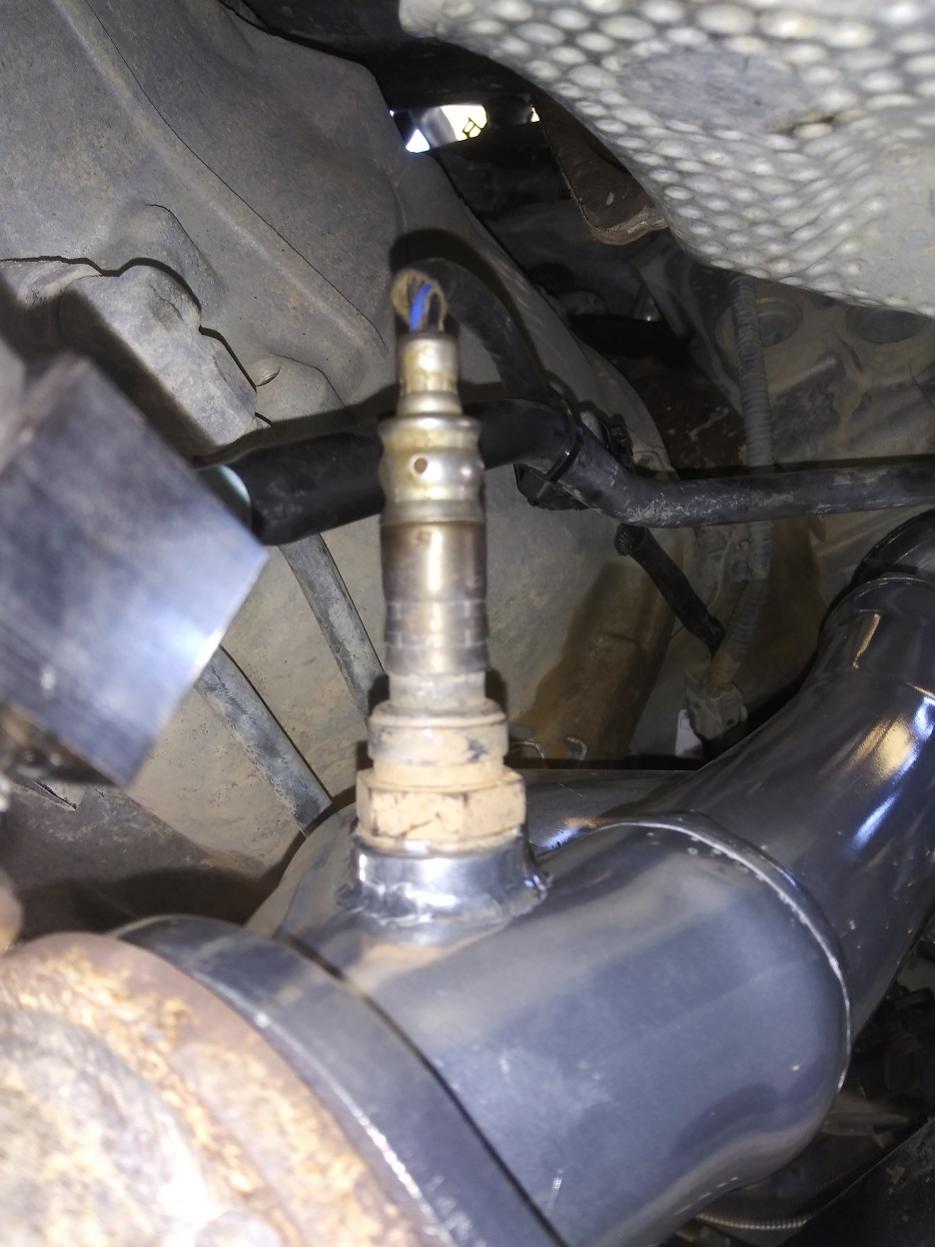

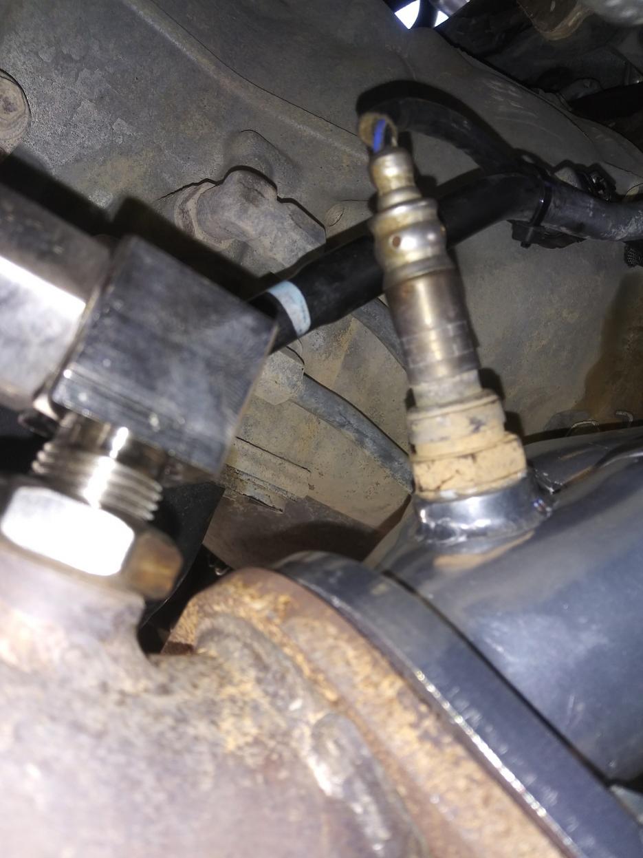

Only issue I have to address and come here for answers is only 2/4 O2 Bypass sensors for during the install. The position of my long tubes leaves almost no room by the stock heatshield. So obviously throwing the dummy check engine light.
Anyone else having the issue fitting the O2 sensor bypass on long tubes? 2003-2004?

If you are referring to the "upstream sensors" that are installed directly into the Thorley headers, they do not get a spacer, bypass, mini cat or anything like these. Those install right into the headers themselves. They are actually an Air/Fuel ratio sensor that resemble the o2 sensors. Keep them separate as they are a different part # than an o2 sensor. Here is a pic of my 03'. You can see the mini cat I have installed on my "downstream sensor" is on the left. The "upstream AFR sensor" is on the right.
Read this post #255 https://www.toyota-4runner.org/4th-gen-t4rs/274986-group-buy-doug-thorley-premium-version-headers-need-20-people-17.html?highlight=Blackoutt#post3364819
