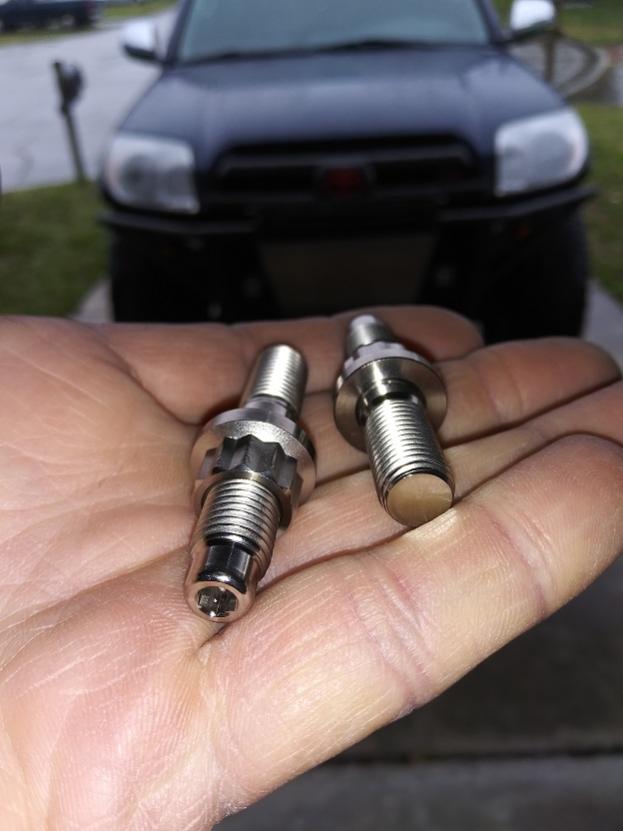

Titanium gold [MENTION=9]Jason B[/MENTION] Thank you.

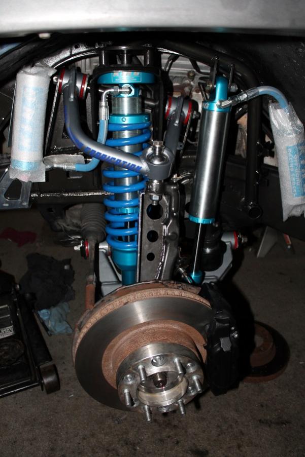

How often did you have to access the bolts through the wheel well? Probably a lot taking the old ones off? I'm thinking if I take the coil over res bracket and the secondary out it will clear up enough room around the gussets to squeeze some tools in there. Luckily I have the 03' so no air tubes to work around on the install. I really didn't leave myself much room lol. I did all this suspension work myself, I'd really like to say I did these too when it's all buttoned up and Rumbling.
Most of my access was through the wheel well. Having no air tubes will certainly help. Although I love your suspension, I'm glad I didn't have to work around it :)

Received my titanium hardware this past weekend, after a long wait, I finally have all the pieces to get quotes for install.

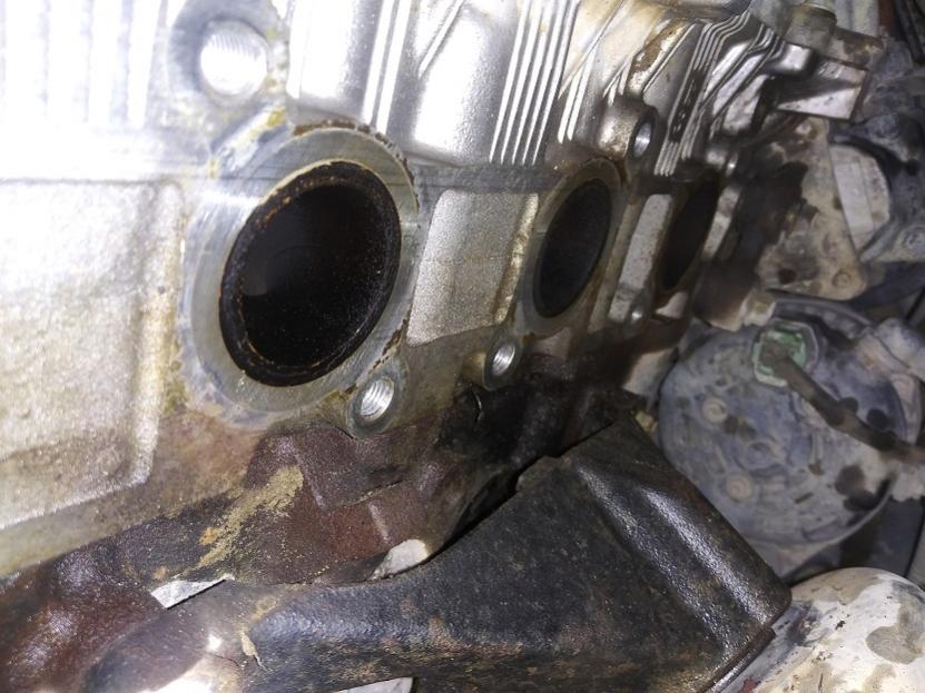

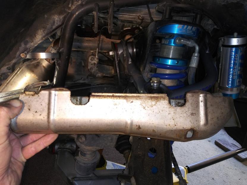

Both heat shields are out. Manifold studs are next. Tight in there, hoping for some good luck, Karma, and vibes. Skills and tools are lacking so I need it lol.

So what wrenches do I need for the titanium hardware?
Hardware I received are 1/2" nuts . They need to be 12 points. I bought a deep 12 point socket and a swivel head ratchet wrench that fit pretty well. Hope I have The clearance. The end of the studs are #4 Allen.

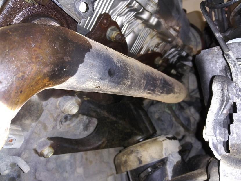

Hoping all the OEM studs cooperate. So far Sea Foam Deep Creep is working. Only broke one header nut loose so far though. Propane might be in my near future.
MAP gas over propane (yellow cylinder). I used to try to break nuts free with propane and didn't get anywhere, bought a MAP torch and its much hotter and results in better heat to break stuff free.

Well, all the studs are out on the passenger side. A little cleaning with some emery cloth and it's ready for Titanium and Header.
[MENTION=377488]LT1coupe[/MENTION] Did you hang the header on one side, let it down and then lift the other or just lift both sides at the same time? Seems like instructions are calling for both sides to be lifted just to get the oem off.

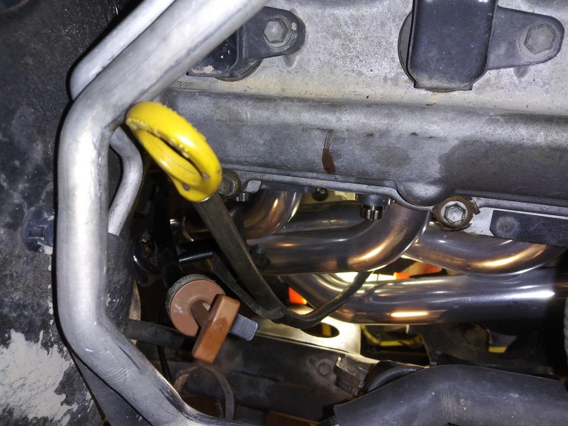

Dip stick tube got me last night. Started out with a brain fart and was trying to bend it into it's old path, Yes I read the instructions, but like I said
Brain:toilet:.
At one point it looked like an old twisted up piece of rope.
Because they both tie together on the block, I also let the Trans tube get in my head so I wasn't focused on just the Oil tube first.
So started fresh this morning and found the right path through the headers.

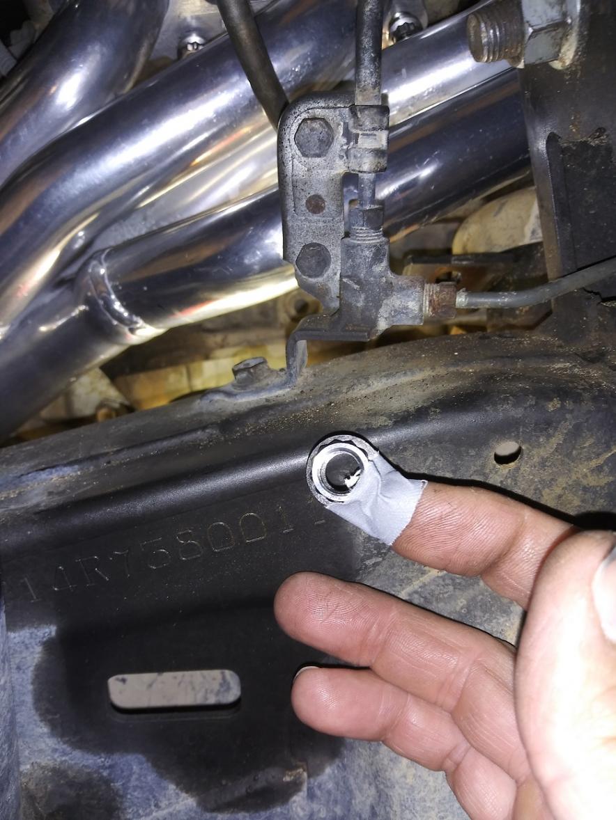

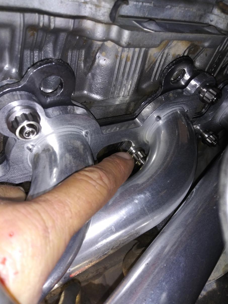

[MENTION=377488]LT1coupe[/MENTION] Thought of a little trick for that pesky hard to reach stud behind the runner and behind the shock tower by taping the nut to the end of my finger. The lower bracket of the Motor mount kind of obstructs your access from reaching underneath, so I reached in around the tower and this worked pretty well. I have long arms which helps a lot too.
