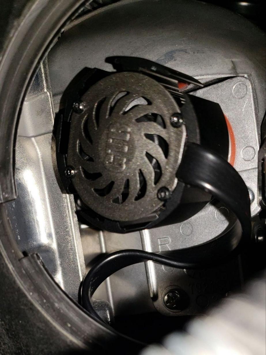

Well this is a bummer. Went to install the GTR ultra 2 and I guess 4runner lights might be sourced from other companies?
I can set the bulb into the socket but due to part of the housing, it can not twist to seat as the housing keeps the bulb too far away. I'm sure it's within or under a mm. I tried the o-ring that came with it, tried the OEM halogen gasket and tried no gasket at all. I took pics the best I could given the bad location. When the bulb is seated I tried marker and pencil to show where the bulb hits into the projector housing. Couldn't get pencil spot on, only close.
You can see where the bulb got scraped by the housing and where the housing got scraped by the bulb. I could probably grind the bulb housing down but at hundred bucks a bulb, want something in writing from GTR they will take them back if it don't work out!
Edit, tired both bulbs on both sides with same result.
