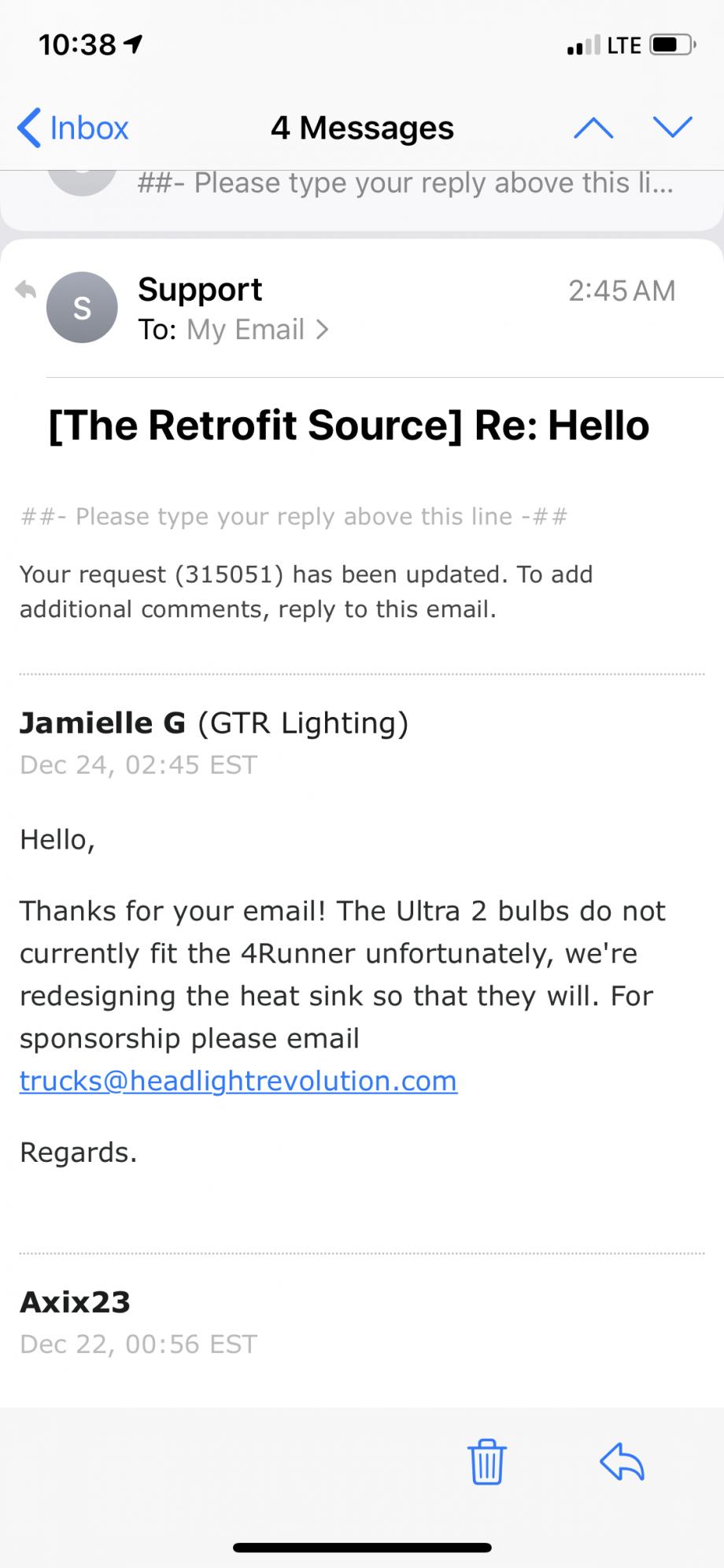

I was just in contact with GTR lighting today. They are working on a new version that will fit the 4 runner housing.
She confirmed these don’t fit the 4 runner at all.
