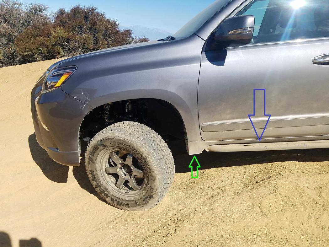

If you cut the OEM step where the green arrow is for about an 8" section on both sides, the enter center length where the blue arrow is pointed, will simply unclip from the step portion. Pretty easy, I'd recommend taping a line and if you have sliders, plan on doing the install twice or pull your newly cut rocker panel roughly off the car so you don't have to do the sliders twice.
This is really helpful. No sliders at this time, this is a family memebr’s vehicle and she finds the running boards a nuisance more than anything. Still wants it to look clean though. I’ll take a look at this option this weekend. If nobody has posted a stepwise process with photos I’d be happy to do that.
