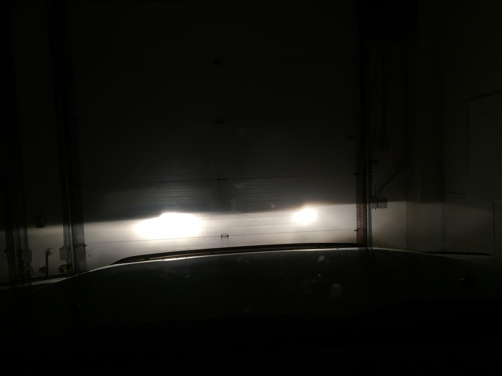

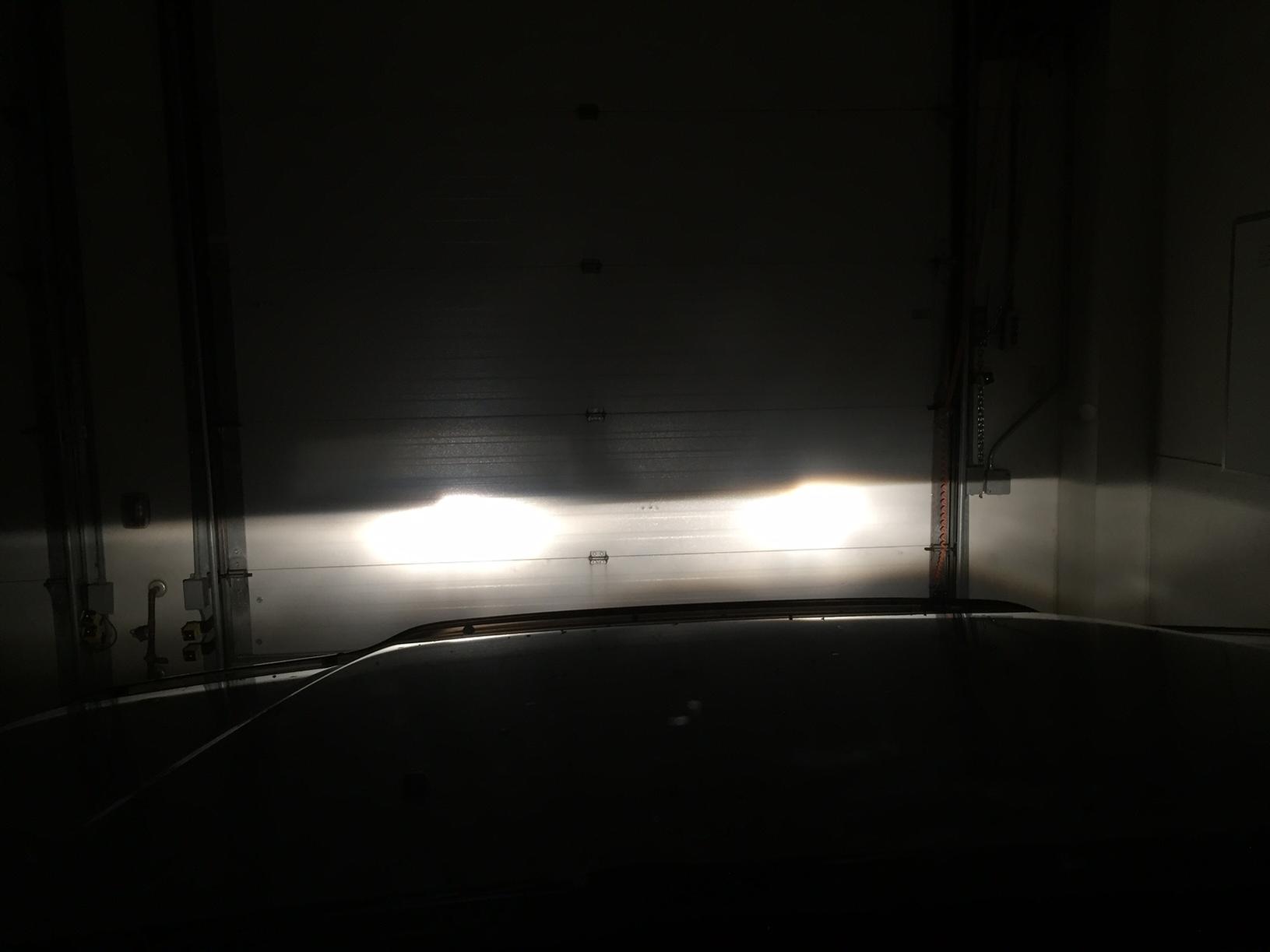

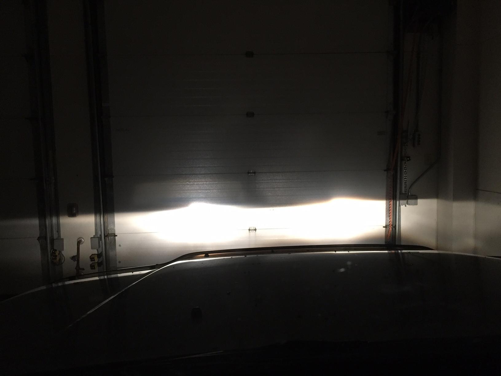

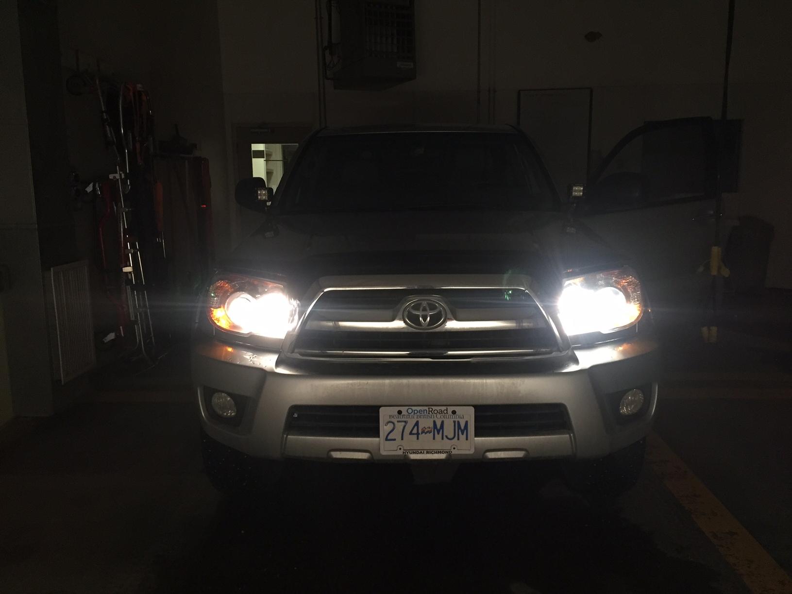

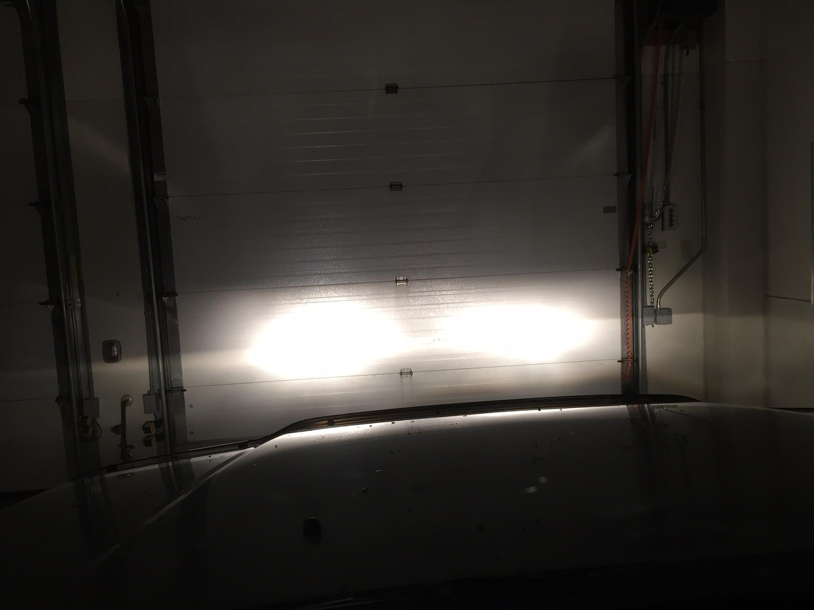

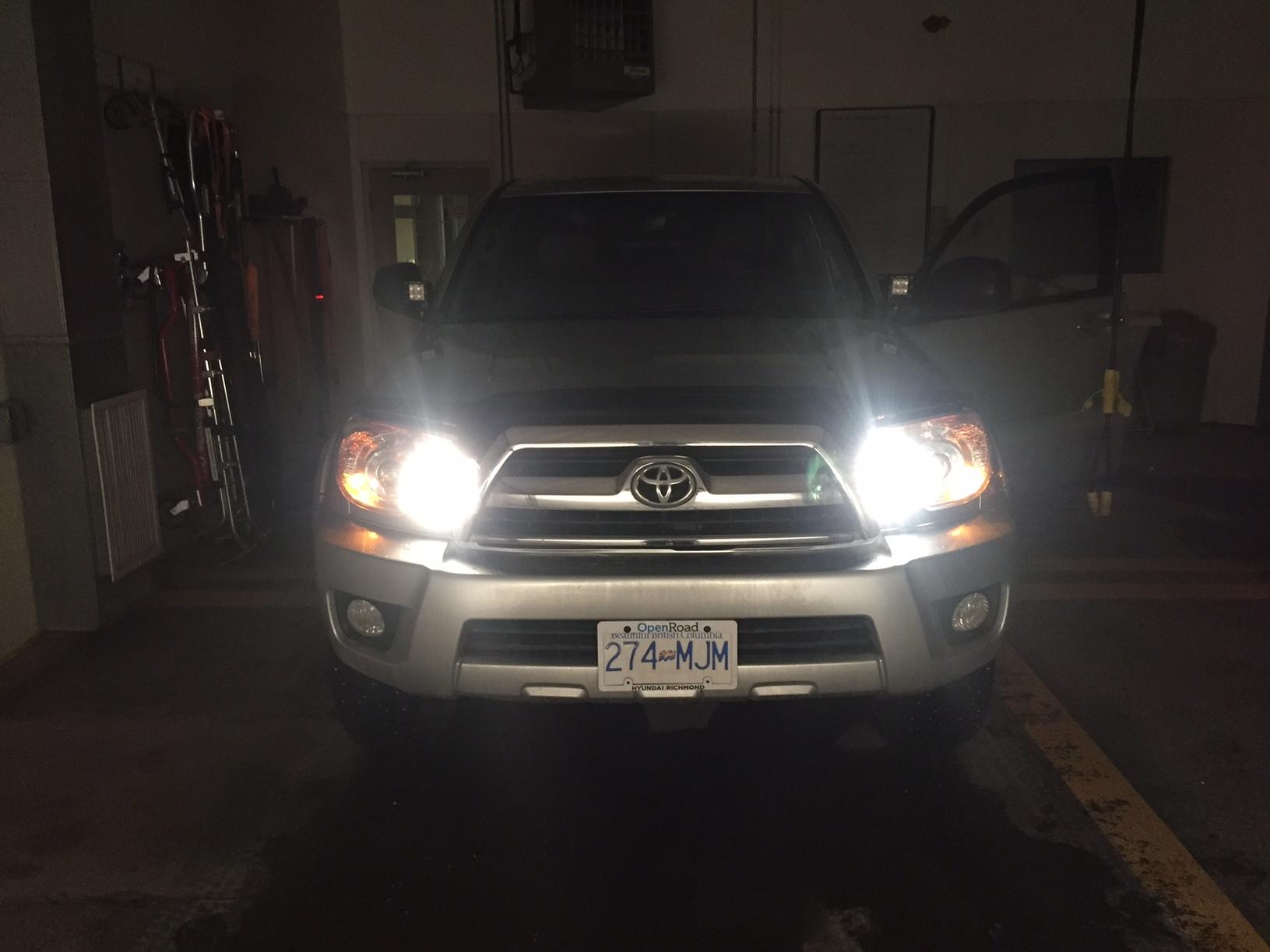

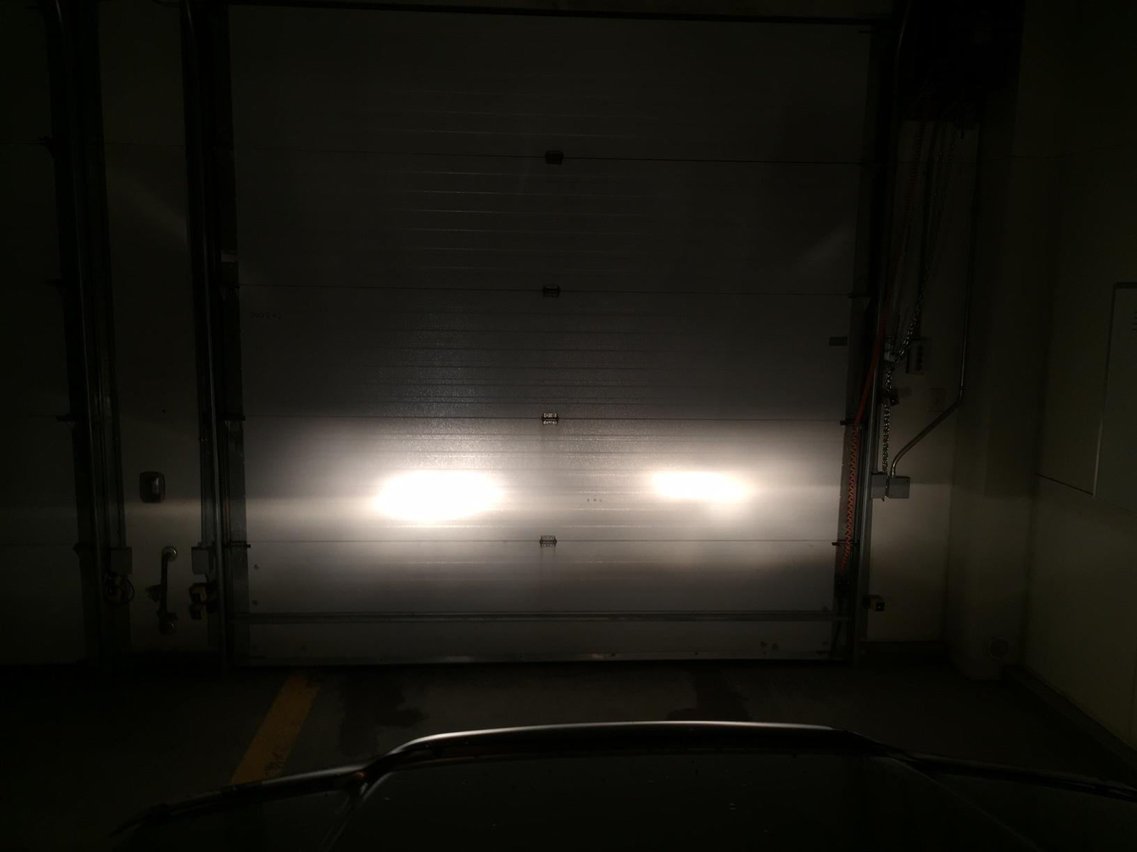

I'll let the photos speak for themselves but I did notice a "relatively moderate" improvement in light output. If I were to put a number to it, I'd say I got about 25% improvement over my 3 month old PIAA extreme vision bulbs in H11 and 9005. To clarify, the bulbs these are replacing are top of the line halogen, arguably the best, and with very little hours on them.
I ended up converting the other side as well and the light output is definitely impressive. Now I'm just paranoid about melting my wire harness. There seems to be much debate on here and elsewhere about whether this is a problem on the majority of vehicle. I will be sure to update this thread once I've ran it for a while. I hope other people will as well! I don't really wanna go HID but I would rather go that route than ruin my wiring and plug.
Attached are some pics:
PIC 1 and 2 are comparing the new hi's and low's on the drivers size vs the stock on the passenger side
PIC 3 is just the low beams (new on drivers side old on passenger side)
PIC 4 is comparing new drivers side hi beam vs passenger stock low beam
PIC 5-7 are all new lights (with different exposures)
All pics just taken with my iphone in a garage approx 8 ft from the wall.
