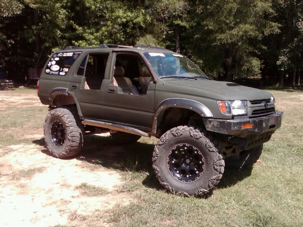

My truck is the 3rd one there.
But, since it didn't work for you, I'm assuming you mean something like these:
Here's another photo as well

I was all over Google and the only 2 trucks I seen were what you posted up [MENTION=76419]Doc2012[/MENTION] but they were blurry as all hell!! Thanks tho. I like how you kept the stock handles. How was welding the caps? What'd you use for a quick disconnect door?
