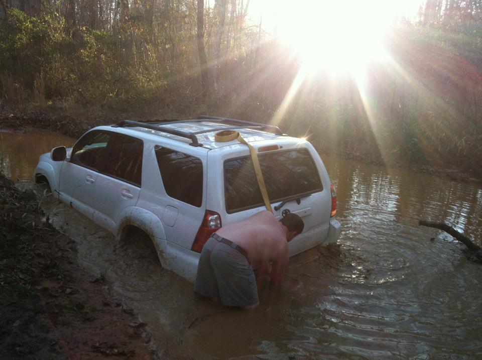

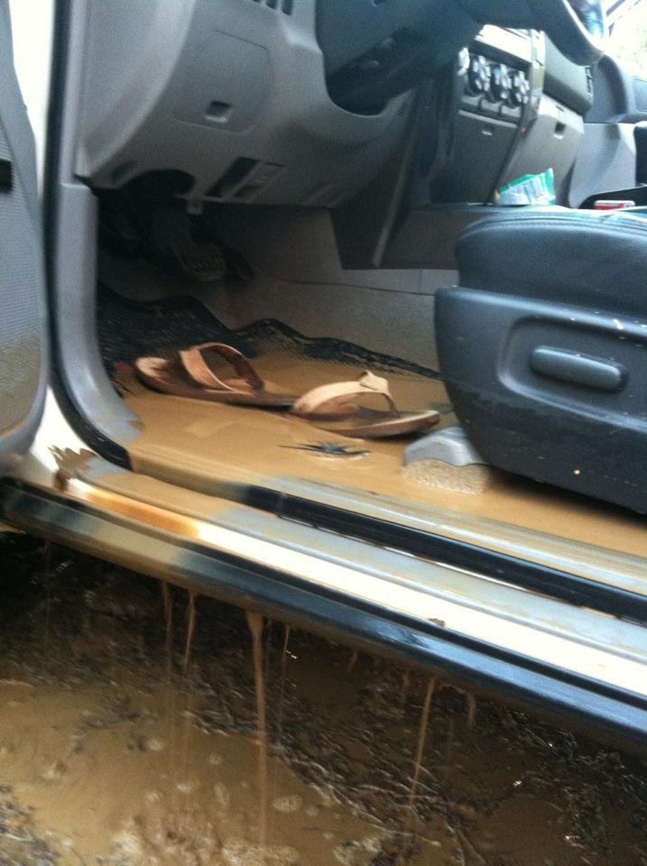

Alright, so last week I took my 07 stock 4runner (yea I know, bad move) out on the trails. After making it through a few puddles I got brave and tried a big boy... bad idea. I got stuck and had about 3 mayyybe 4 inches of water in my floorboards (front and back). Water was right at the top of my tires. Everything seems to still be working properly but I have a few issues now.... If someone could please HELP!!

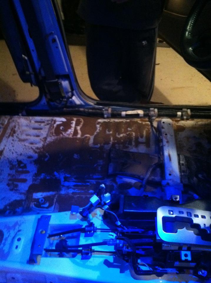

Here is what the floorboard looked like after I drained most of the water outwet floor board.jpg

Since you are having problems with the rear door wiper/window/defrost, it seems you might have an issue with the multiplex network back door ecu, or even the back door lock assembly. The lock assembly could cause the system to not set by remote, however you would most likely get the steady tone if trying to set and it was getting an error. It also probably wouldn't have any effect on the back door window/wiper/defrost. So if you had water intrusion into the cargo area, it may have at least gotten into some connectors, etc for the system, which run along the door sill channels. Judging by the pictures, you had water over the sills. The wiring in back run a little higher up, then drop down over the rear wheel wells to the sills.

How high up on the center console area did the water reach? I can't tell by the picture. I can see that it got up a couple inches on your door panel, and because of this I would also take the door panels off - front & back to get anything out that shouldn't be in there. Dry it out really good so you can try to stop any rusting from starting, or getting worse.
Can you post some more pictures of the interior with the carpet out? Passenger side, & back seat area along with cargo area. One more of the driver's side with better lighting would be ideal. Oh, and one of the center console area up to the instrument panel would help too.
