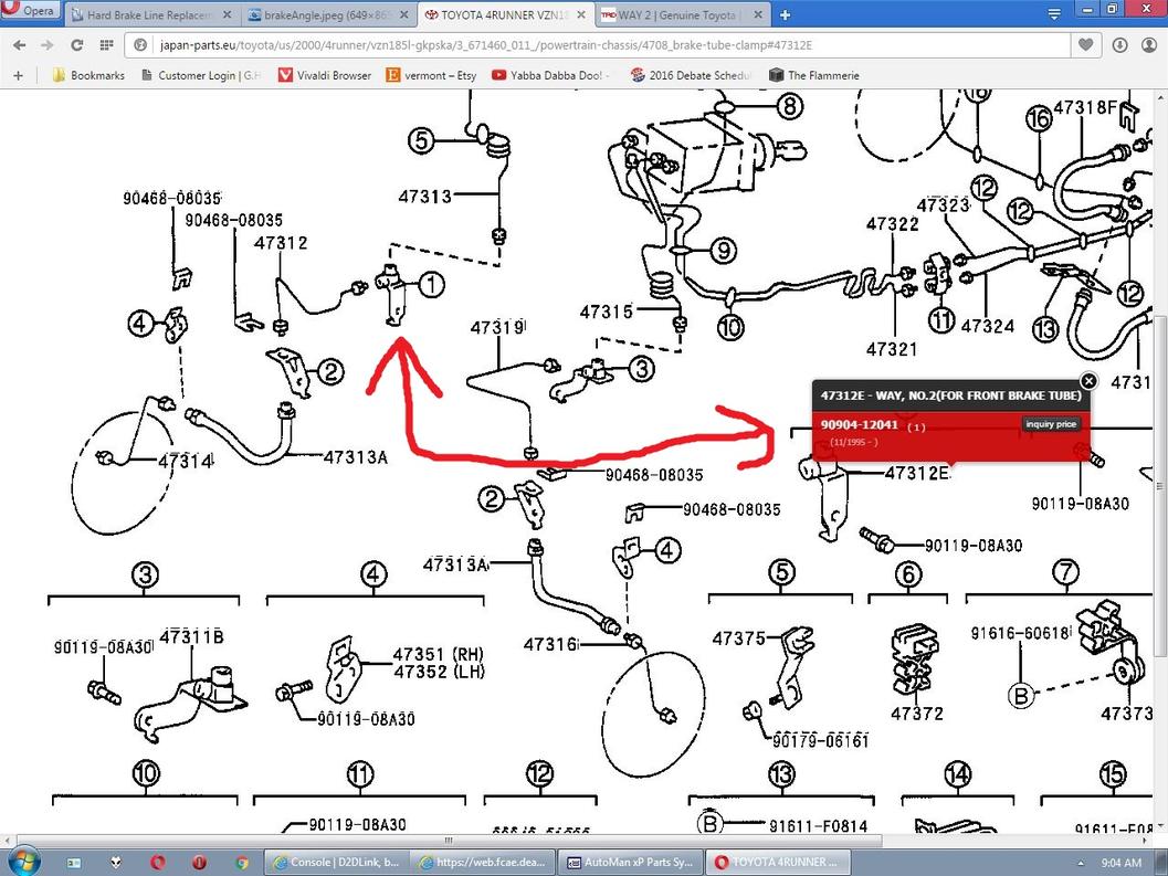

I'm not sure what adapter you are talking about. I only replaced the hard lines from the rubber hose to the wheel end.
This is the part I'm talking about - it's an "L" Junction between two hard lines - this is passenger side wheel well - I was doing the starter and the line started to ooze from being moved. Pretty rusty, so I don't mind replacing it. Just wondering if I can remove that part and just do a bend in the brake line, or if it's serves some function.
Matt
Matt,
This looks like what you're looking for??
This elbow should still be available from Toyota, They just replaced it on my Tacoma when they did the frame replacement.. I could only assume that it is the same part from 4Runner to Tacoma??
I'd call Toyota with the part number from the picture?!
It looks to be just a union to make it easier to join two sections of line, but I would replace the part. I'm assuming you're replacing the upper section with the coiled line (for strain relief) as well? That might have to be an OEM part, no way to build that.
That is the part, pretty sure. I do think it's just a junction, but I would be afraid to leave it out, and not sure mine is reusable.
Just called the dealership... $18 to get it, hopefully they have it tomorrow. Only 12 left in the country.

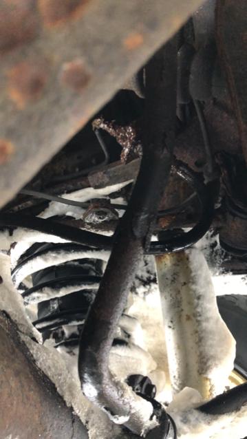

Rusted Driver Side Rear Outer Hard Brake Line
Happy Thanksgiving everyone.
I have been quite successful in using the search function for the past 7-8 years or so but this time I am coming up short, thus my apologies for resurrecting an old thread.

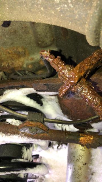

My trusty rusty '02 Sport Ed 4WD with 270k on the odo developed a brake line leak due to heavy corrosion near the fitting on the driver side rear outer hard line (see attached images). Upon confirming with the dealer these hard lines have been discontinued some years ago.
I have not been able to source any aftermarket hard line replacements and wanted to ask for opinion on making my own hard line. Two questions:
1. Has anyone found an aftermarket replacement for a P/N 47323?
2. Can anyone confirm the correct size hard line, fitting and flare, please?
From this forum it appears that the correct size hard line diameter is 3/16, the fitting is M10x1.0. But can anyone confirm the type of flare, please?
Thank you very much all,
Ivan from Traverse City, MI

Hmm. Most have recently discontinued those rear lines as they were available a year or so ago.
Kinda surprising as they can always make more brake lines...
In any case, you now have only 3 options:
1) See if you can get a used non rusted line from a junk yard.
2) Have a new brake line made out of the copper nickle tubing.
3.) Find an aftermarket line mfg. [ I haven't seen to many of these out there because they were always available]
Sent from my SM-A536V using Tapatalk
[MENTION=164664]brillo_76[/MENTION], thank you for your input. I will try the local junk yard, however, this area is very heavy on winter salt use, so chances of me finding a non-corroded line are pretty low but it is worth a call.
It seems like the only real option will be to make the line, and that’s where I needed to confirm:
the type of tubing (stainless or copper nickle?)
tubing size (3/16?)
fittings (M10x1.0?)
flare type (double flare?)
Thank you

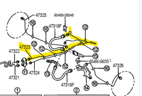

Thank you very much for this useful info. I looked up the fittings and tube at Amazon, seems easy enough... that is until I find out how accessible the line is and how it is actually routed... In looking at it a bit closer I will probably have to replace 47318F hose due to corrosion as well.
You going to have to drop the tank unless you reroute the line. :(
Probably more economical to just buy the replacement rubber hose at an autoparts store. As those can collapse internally with age as well.
I done several of these lines. The 2 back ones are the worst only because they go behind the gas tank and Clip on the coil plate.
