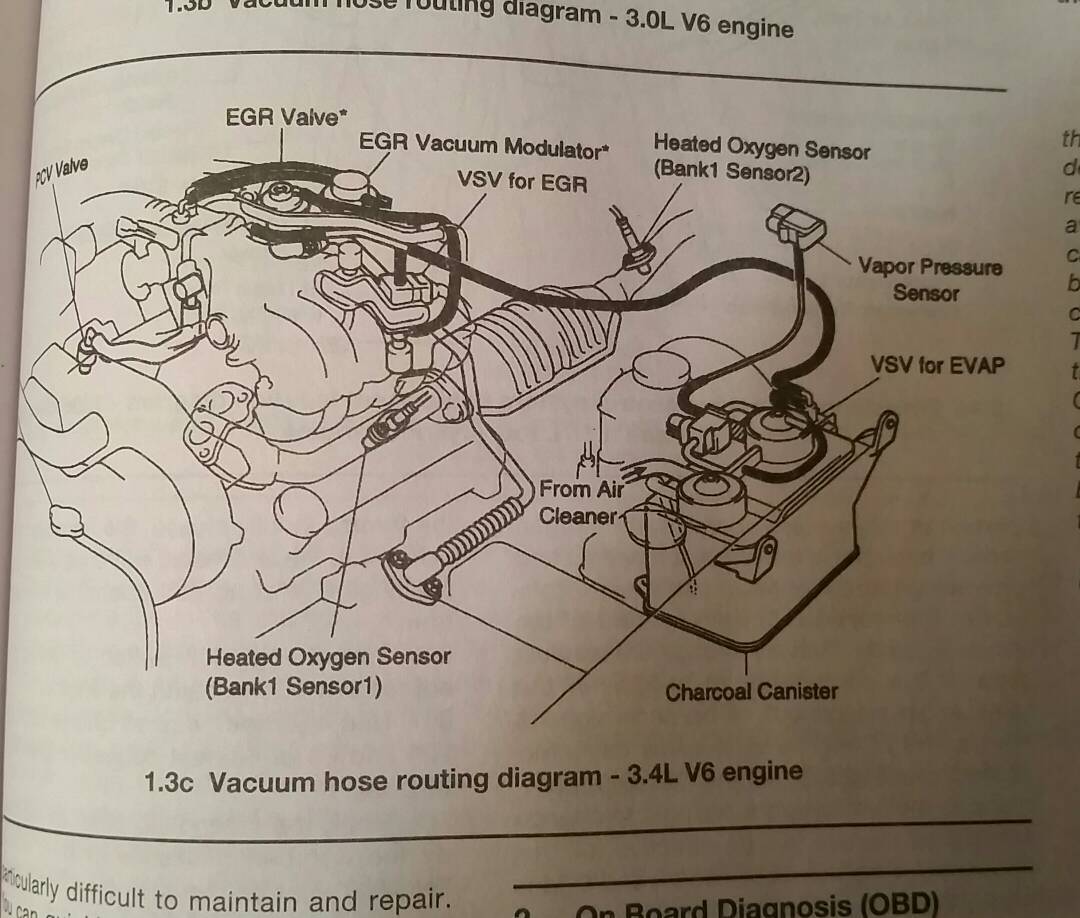

Also, my dad is a bit of a car wiz, and upon consulting him, he said check your vacuum system. If you've got a vacuum leak it will do the same thing. Check all hoses in the EGR system, making sure none of them are cracked or have leaks. Here's a diagram of what I'm talking about.
