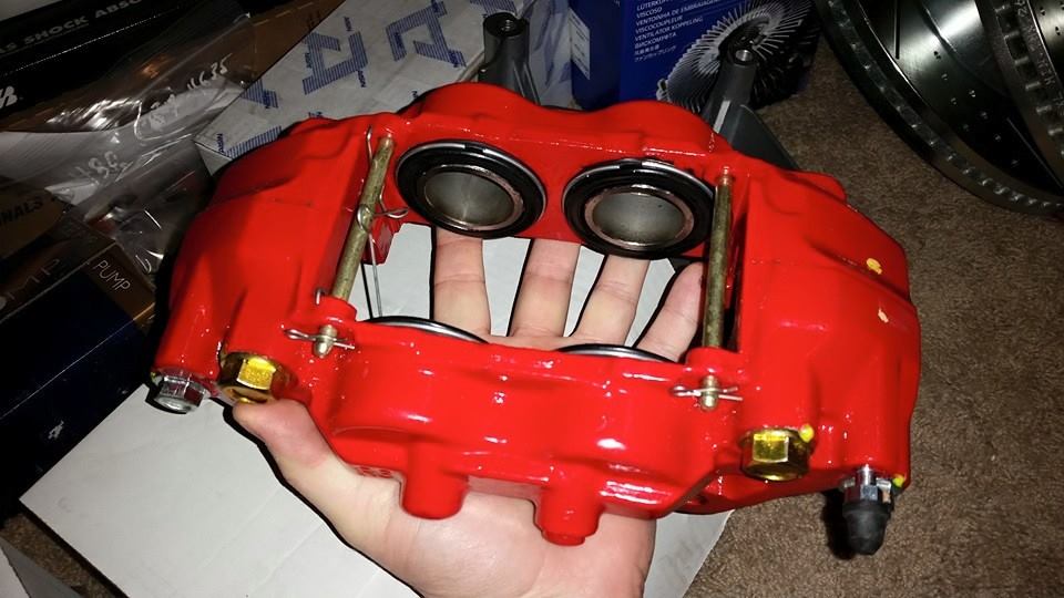

I went with the callahan full kit (callahan is powerstop / GREAT marketing name lol )
- Calipers are excellent visually with a pretty much flawless finish. Photo does not do them justice

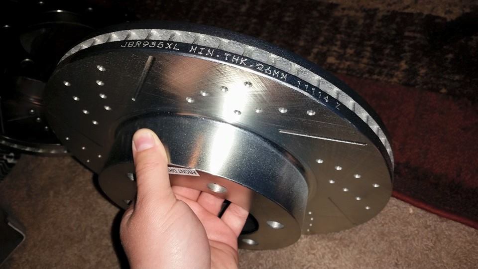

- Rotors visually are excellent. Casting is as good as it gets. Heavy zinc plating. Time will tell if they are decent in the long run. Did not care for the drilled rotors but slotting is nice. Also - not surprising, the rotors have powerstops part number stamped into them (JBR935XL)
