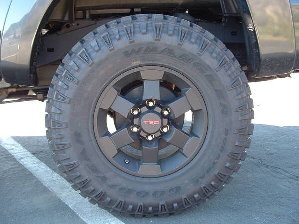

Can anyone confirm if the 16" FJC Trail Teams wheels (part #ptr20-35080)!will fit with the 231 TBU?
I searched all 38 pages of his thread and found where [MENTION=93961]CaptainGiggity[/MENTION] asked once before and [MENTION=44220]BigFishAllDay[/MENTION] replied with a "maybe since other FJ wheels fit". But, I believe all other FJ wheels are 17".
I have a opportunity to buy a set of these wheels and need confirmation that they'll fit before I do.
I'm really interested to see if those will fit too. Any chance you could test it before buying?
My plan is just to buy one, test fit it and return. Easy peasy. They supposedly fit under the base model 15 in steel wheels but nobody can confirm that for me. Just have to test it out!

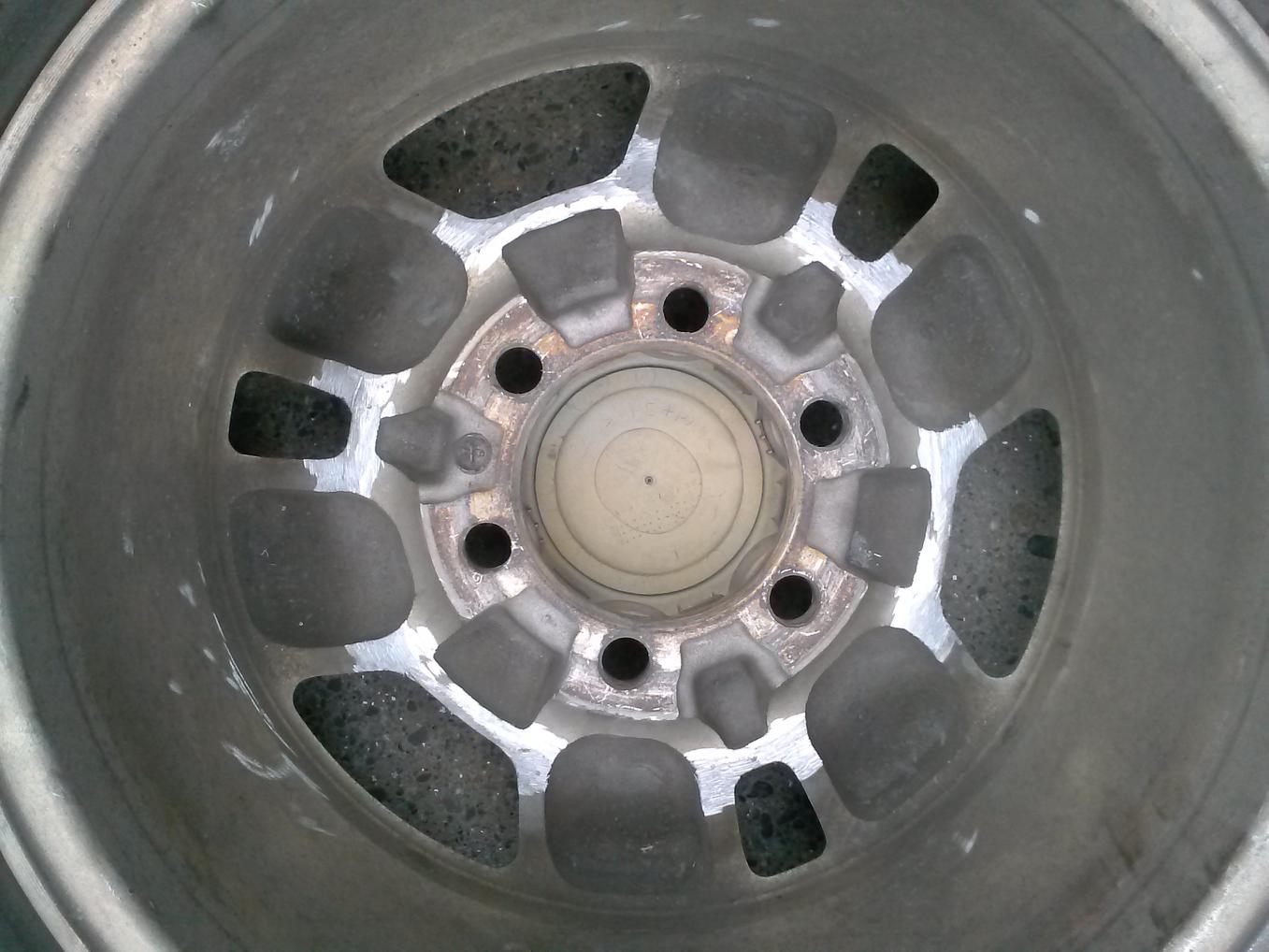

Thought I'd post this since everyone is so scared to grind their wheels.
Really wasn't hard, just used a 4 1/2 angle grinder and took off the guard. A smaller one would be even better.
Did take a bit of time since mine was low powered and cheap. But did work. This was the first rim I did, the second went quicker since I figured out where exactly I needed to grind.
Sure beats having to buy new rims! You can't even tell from the outside that they are grinded.
How much did you have to grind off?
There's an edge on the rims that causes the issue. At the high point, maybe 1/4 inch. The rest of the area is just to smooth it out a bit.
The rims are aluminum so it comes off pretty easy.
I see you did the first one and you mentioned doing the second one...but did you do all four of them? If not—how do you rotate your tires? Just curious.
