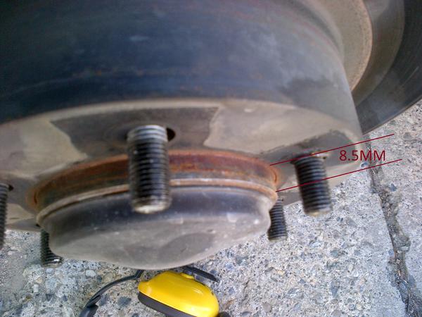

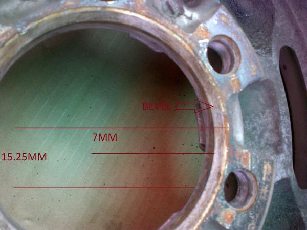

Well, I finally pulled off the front wheel and made some measurements. The guy from Wheelers was totally correct, not that I doubted him!
I was thinking of using a 1/4"(6.35mm) spacer to allow the stock split-3's to clear the 231mm calipers, which others have done(some have ground the rim as well), but:
...as the hub depth is 8.5mm and the bevel on the rim is 7mm, the hub to rim contact is a mere 1.5mm... If one was to place a 6.35mm spacer over the hub, the rim will no longer contact the hub and all the weight, as well as centring the rim on the hub, will be borne by the studs...
I should have measured this in the first place but talking to the right people and accessing resources (like T4R) helps one think these things through...its time for me to get some new rims. I really don't want to run 1.25" spacers!
Yeah, that's what's called a wheel-centric setup. All the weight is on the studs and not the hubs. It works, I suppose but you are much more likely to have vibrations or wheel balance issues. A hub-centric spacer like the 1.25" spacers create a new hub-centric but changes the handling a looks a bit. The other option you already figured out, new wheels that will handle the calipers much better.
