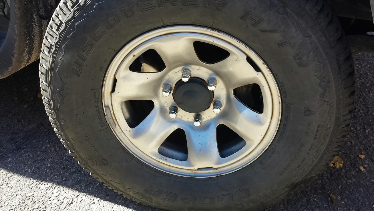

stock rims
anybody know if these rims will work with the 231mm upgrade?attachment.php
