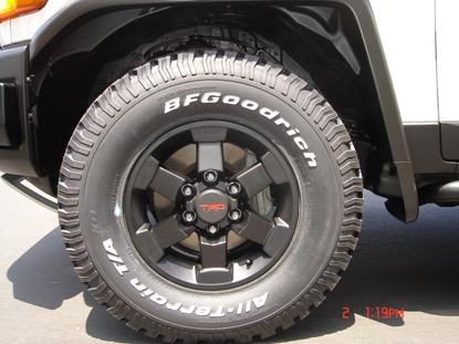

I looked but didn't find out if 16" FJ TRD rims would clear the 231mm upgrade. Anyone?
[MENTION=113851]dirteater4[/MENTION]
Yes, they should clear. I almost ran those wheels and did a lot of research and posted a thread on it.
http://www.toyota-4runner.org/3rd-gen-t4rs/196149-trd-wheels-tundra-brake-upgrade.html
