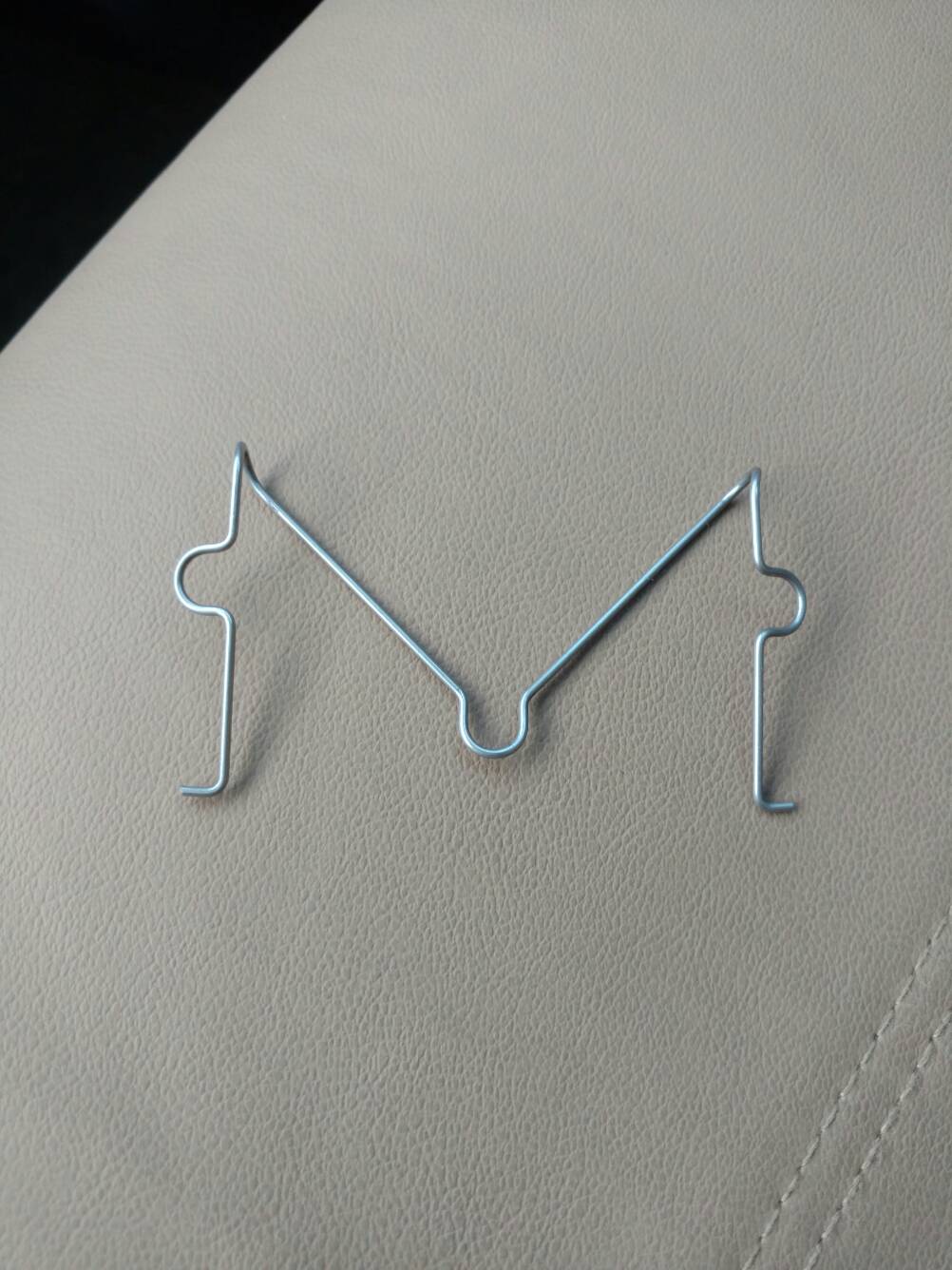

I still have 2 of these anti rattle clips for my calipers. Is it okay to put on the other end of the calipers for a total of 2 each side. I see in pics here that only 1 is installed per caliper.
I looked at the instruction from Toyota for my pads for the anti-rattle clips and it instructs to put two on, so I did. When I had just one on the opposite side of the pad was still wanting to move around so it made sense. They are dirt cheap so I had nothing to lose.
