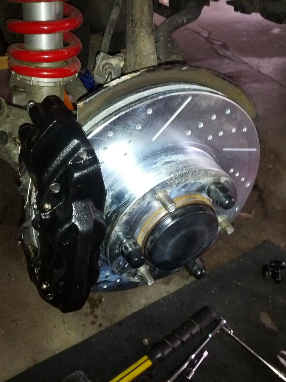

So my experience is the following. Today, I picked up:
(2) NAPA (SE3263) 13WL (231mm) calipers - $243.10 w/ $110.00 core charge
(2) NAPA (4886931) Rotors - $123.16
(1) Set 2005 Tundra Ultra Premium Ceramic Front Pads (UP787X) - $73.88
I had briefly scanned this post before buying, but saw BFAD's info on the shotty casting and chamfered pads, so I go on Amazon and find POWERSTOP drilled and slotted rotors and ceramic pads set for $185 for the 13WL calipers. So I'm returning the NAPA rotors and pads tomorrow, and keeping the calipers, saving me me some dough with better quality components!
Pretty stoked for beefy new brakes that are efficient at cooling, my truck is vibrating big time when I brake.
I'll update on the installation of the powerstop stuff, and performance of the slotted and drilled. If the rotors / pads aren't what I'm looking for I'll return them, and get OEM rotors and pads.
So got my brake swap done yesterday. Brakes are great, no wobble, and plenty of stop power. I notice I do need to push the brake pedal slightly farther to get the the same engage from them. The rotor internal forging is just as clean if not more than the OEM rotors, and the pads that came with powerstop are carbon cermamic with a slight chamfer, but not as much as the NAPA pads.
I got them off amazon for $185 with free 2-day shipping with prime here:
Power Stop K2324 Front Ceramic Brake Pad and Cross Drilled/Slotted Combo Rotor One-Click Brake Kit : Amazon.com : Automotive
Try bleeding them again, assuming you did it once already.
Yeah I think I will. I also put a pretty thick paperback book behind pedal, but when bleeding was done and GF had left, the book was sitting in middle of floor, so I'm wondering if the book wasn't even behind pedal when she was pumping. But I think I'll bleed once more just for fun, maybe now since everything is seated from a few days of using them.
