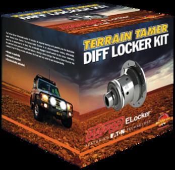

Is anyone running a Harrop Eaton ELocker in their 5th gen? Seems like a popular option in the Land Cruiser community. I'm curious if anyone has experience with these in our rigs and how installation went. I was leaning towards TJM Pro Lockers but I can see how a reliable electric locker has its advantages over pneumatic+electric systems.
A11110 Harrop Eaton ELockerâ„¢ ? YotaLockers.com

I haven't used one - but it would probably be my choice. My biggest beef right now is why they hell are they so expensive? The D44 version is around $750. It's practically identical other than some small machining differences in spline count, bearing diameter, and bolt pattern for the ring gear. For manufacturing purposes they should be very similar in cost. Even an OEM rear differential assembly with locker from Toyota is only around $1,100 and that's the complete third member with ring and pinion, housing, bearings, etc. The Harrop is overpriced at $975 - (converted to USD).
Its been over a year but I talked to their sales staff and got some install literature, IIRC there is some minor case modification/grinding required to get it to fit (just an FYI). If I get a front locker I will likely go this route. I do not believe any one has installed one on these forums that I have seen.
