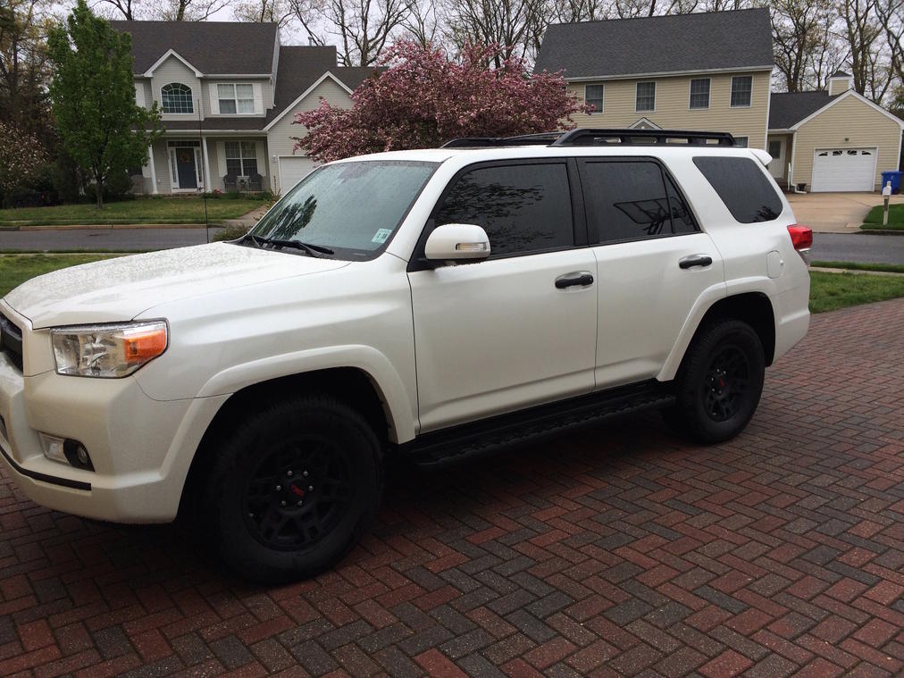

I replaced mine with the black ones from a 2010-2013 Trail. Cost about $150 for all 4.
