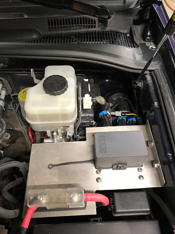

1. Running from the Bussmann to the drivers side firewall grommet. (other harnesses running through there too. Sorry, hard to see crap in that photo, but the wiring runs through the firewall where the hood release and factory harness run.

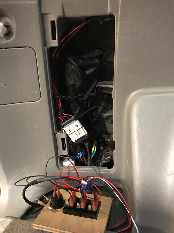

3. all the wiring goes to the rear driver side quarter panel, following the factory harness... (not taking that trim back off for a photo lol) It's a little rats nesty looking there, but it's all connected w/ Metripac connectors and the rear storage system is presently removed... from there it runs up the pillar to-

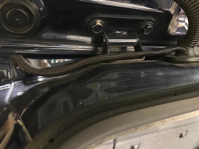

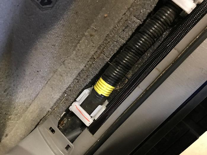

4. running the harness up under the headliner and through the hatch grommet/seal whatever it's called... on the right i came through the seal, and you can see it going over to the left. From there it goes up under the gutter seal thing (next pic)

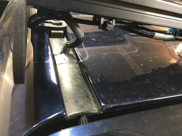

5. at the bottom of the pic is where the transition from behind the hatch to under that gutter seal. You can see in the paint where the old factory rack sat, there was a hole I made in the foot for the wires to pass through. There's 6 18g wires running in that harness, ground is terminated at the Bussmann, not on the body so that the whole system is isolated from the factory setup. (circuits for left and right scene/work lights and dust lights)

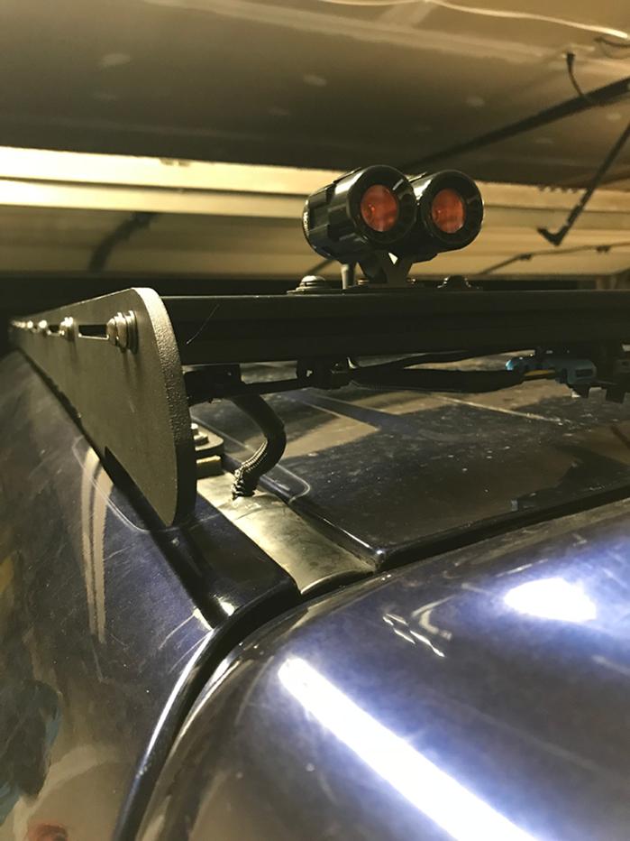

6. just a pic from a little further back to give you a sense of what it looks like coming off the truck (yeah, my loom isn't perfect looking there)... including the dust lights. :cool:
