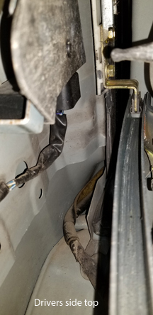

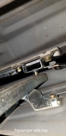

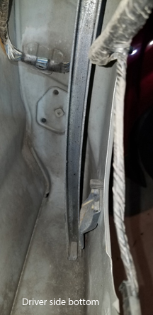

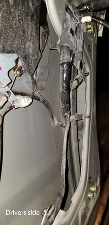

I suggest going to a junkyard and pulling all the bracket pieces from a dead one. It will also give you an idea on how it all fits together.
Would a pic of how it sets up do?
Only now I saw this post today. I just was at the recycle yard yesterday pulling off the outside license plate plastic garnish.
Yes Hilife I believe it would. Specifically both vertical tracks, mine on pass side has nothing in it. So if possible I pic of what part goes in it and where it attaches to.
On the Dr side I have the L shaped bracket that's attaches to the plastic piece that's attached to glass but the end of that bracket I believe should have something attached to the end of it to help guide it in the vertical rail on that side?
Any pics would be very appreciated thank you!!
Hopefully these can help you out.

that's awesome HiLife!! Big thank you! I'll have to fab/Jimmy rig something up, looks doable! Really appreciate you taking the time to help me out!!
