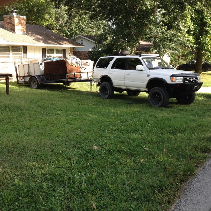

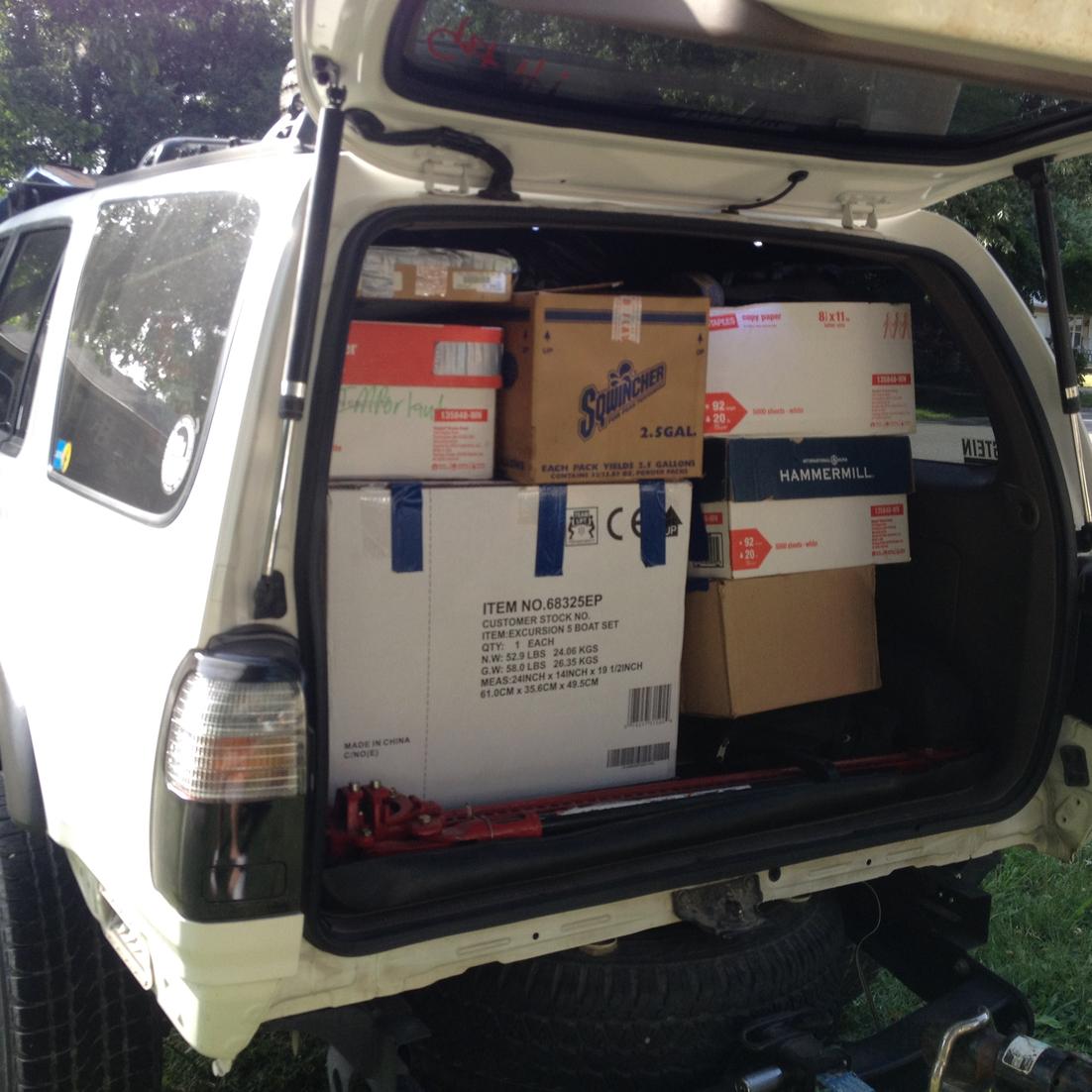

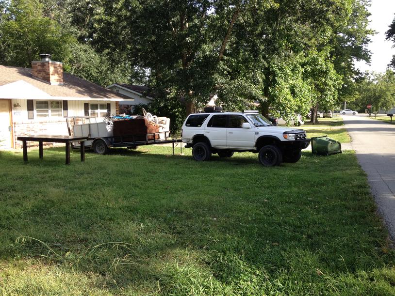

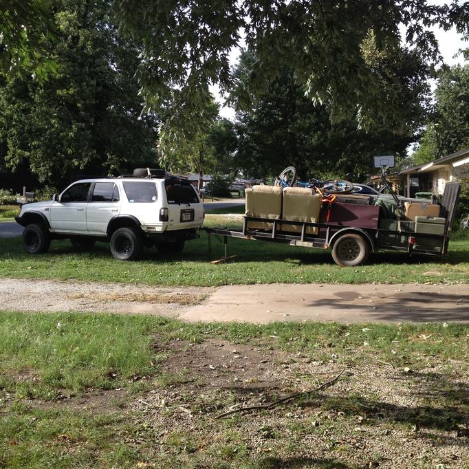

I moved about 450 miles this last weekend with a 8'x 12' trailer this last weekend loaded down with only about a one bedroom apartments amount of stuff, and the truck loaded down from behind drivers seat all the way to the rear hatch.
I averaged about 9mpg the whole way there. And definitely felt it behind me. I was also on the oklahoma turnpike doing 75-82 mph the entire time.
It pulled fine just a heavy ass load. Be careful but you can do it!
Here's the rest of the pictures.
