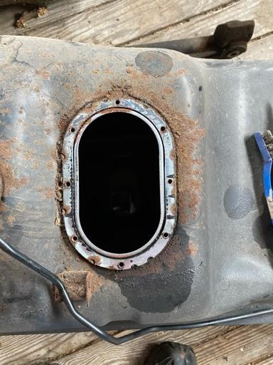

The gasket surfaces rust and cause the gaskets to leak also. It may not be a rust hole unless you seen it.
I caught this one just in time before it started causing an EVAP code. I had to drop the tank to weld in a repair sleeve for the lower control arm mount.
