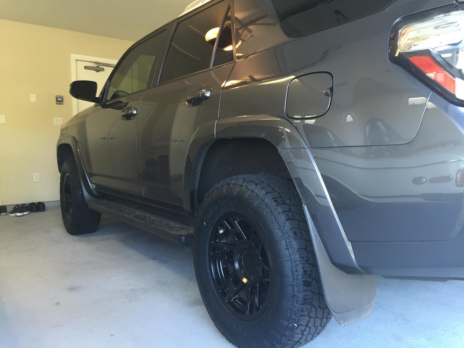

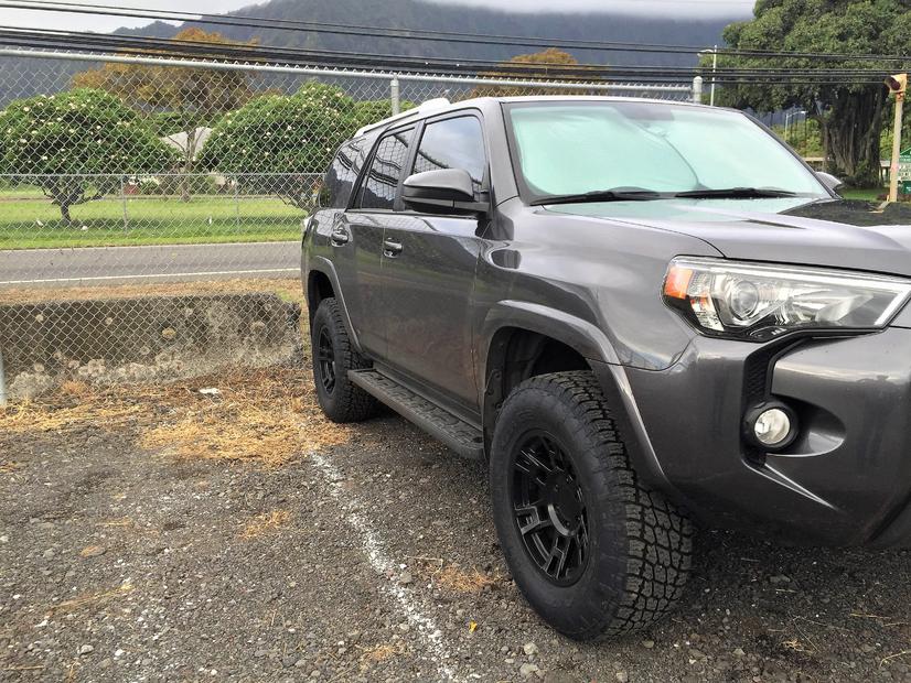

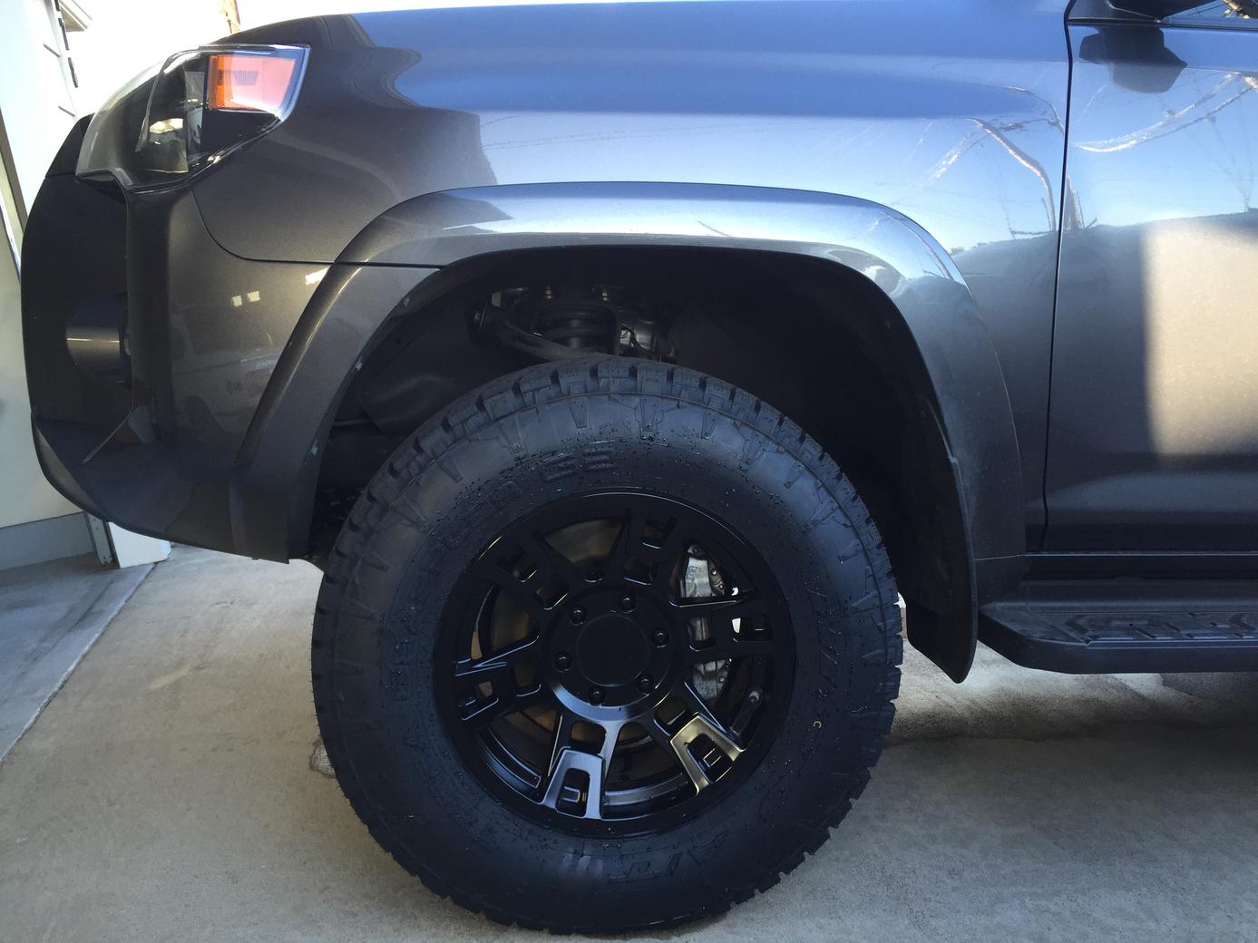

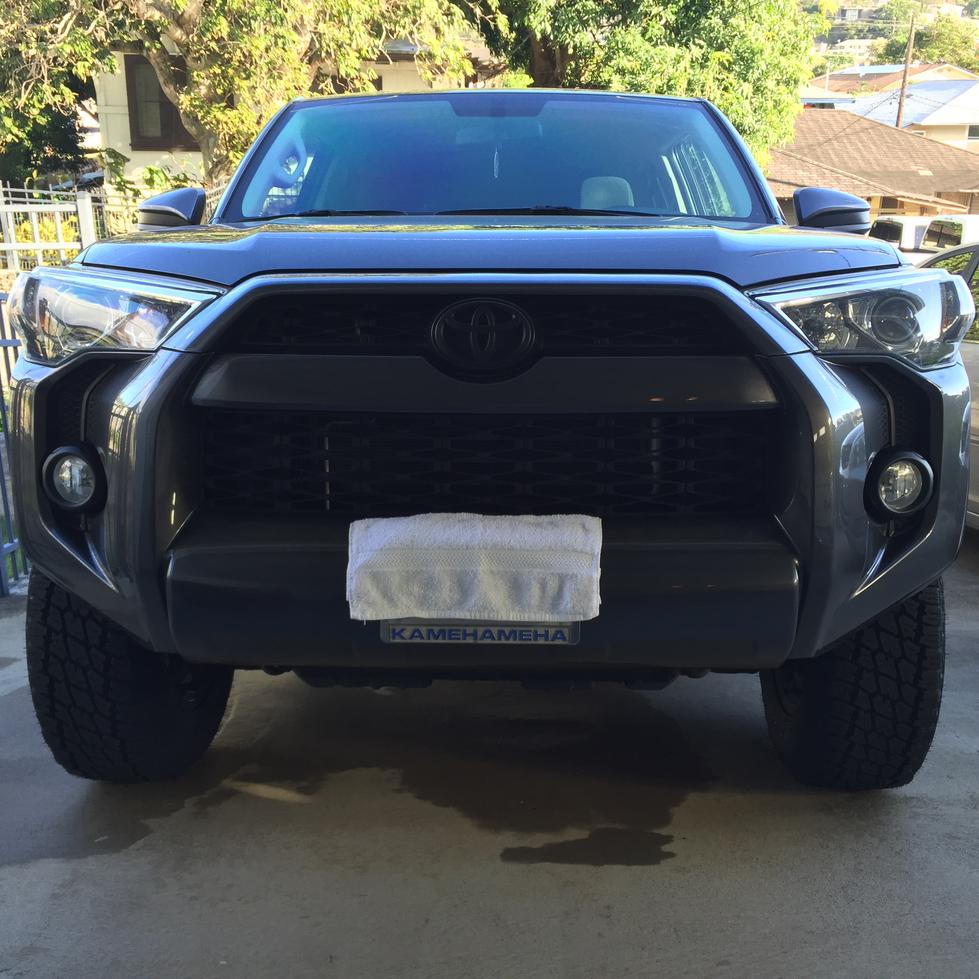

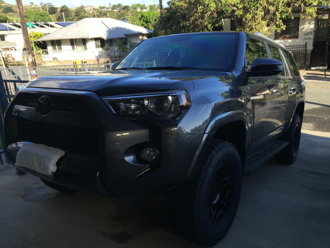

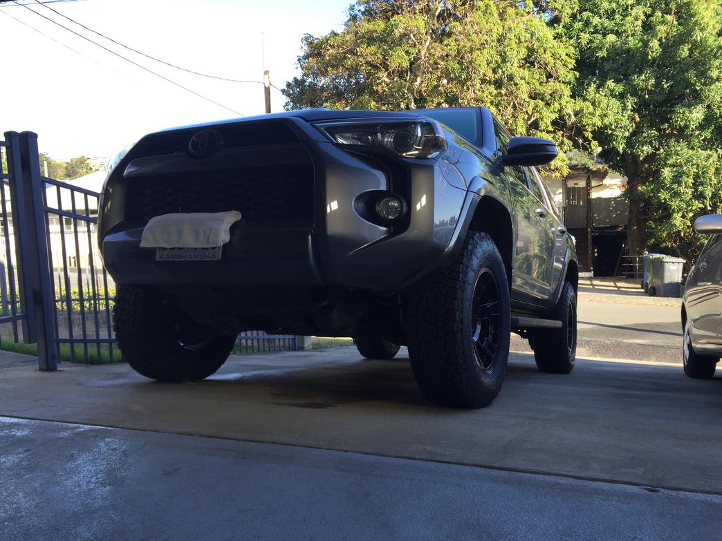

Finally got my lift installed and thought I would share the results...sorry for the shitty cellphone pics. Hopefully, I can get some better pics in a better location soon.
Bilstein 5100 @1.75 up front and 1" cornfed rear spacer. I also mounted some P-rated Nitto Terra Grappler G2 in 265/70/17. I have to say the stance is way better now and looks much more aggressive than stock. It's awesome to have no brake diving anymore.

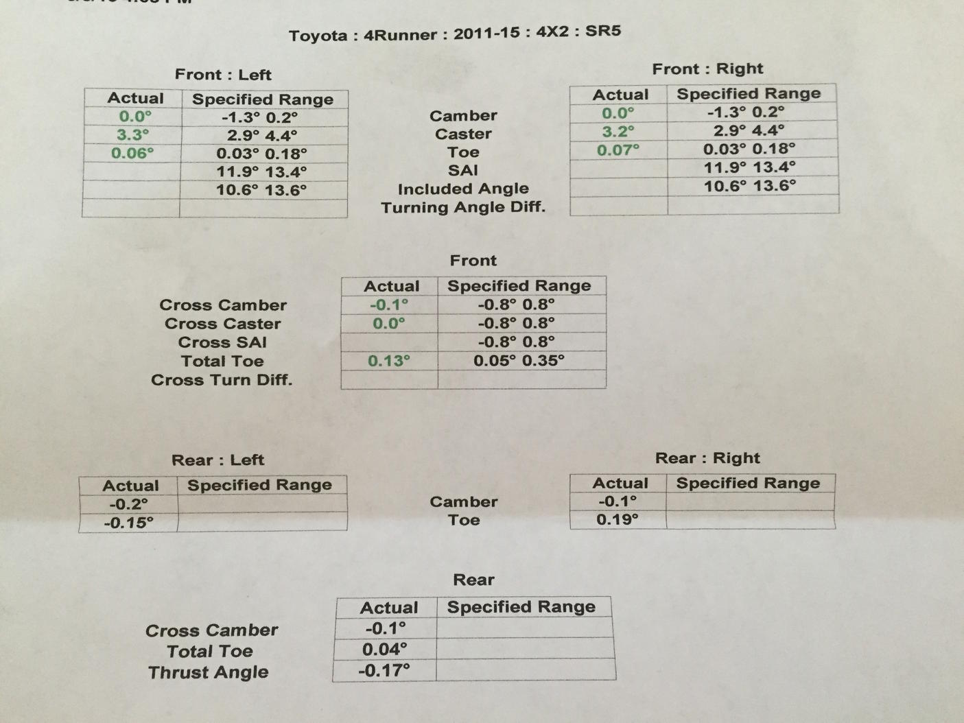

I attached my alignment sheet to show what I got with my stock UCA. So far it drives straight and smooth. Any comments or recommendations are welcome.
I do have one question for everyone, what PSI are people running with the P-rated Nitto G2s? The shop aired them up to 32, but it seems a little soft to me.
Thanks to everyone for the great advice on the forums! Couldn't have done it without you guys! Let me know what you all think!

looks good, i installed the same set up last weekend. I heard i was supposed to run the new set up for a week and let everything settle before an alignment .. who did yours ? I've heard 4WD parts does the best on the island with lifted vehicles
Thanks brah! I bought my Bilsteins from 4 Wheel Parts, but had it installed by Auto Customs in town. They did a great job with the the install. They also installed my tires for me too. I would recommend them if you're in town. I had Island Brake and Alignment.
