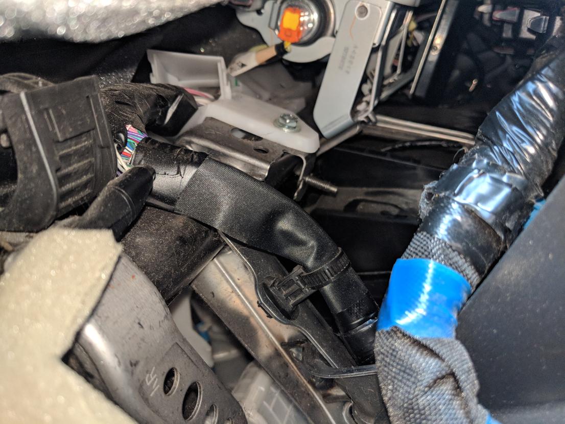

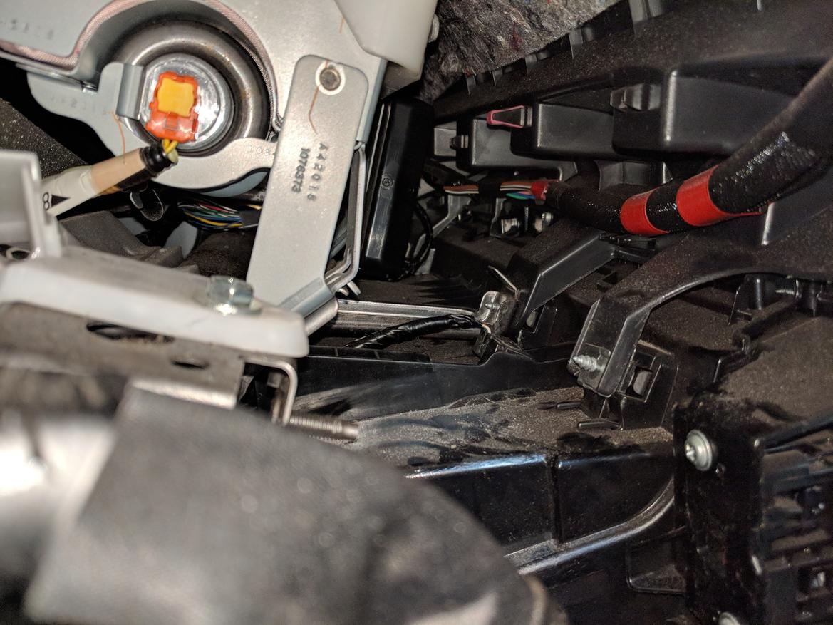

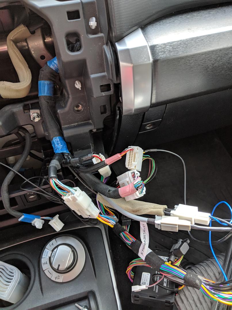

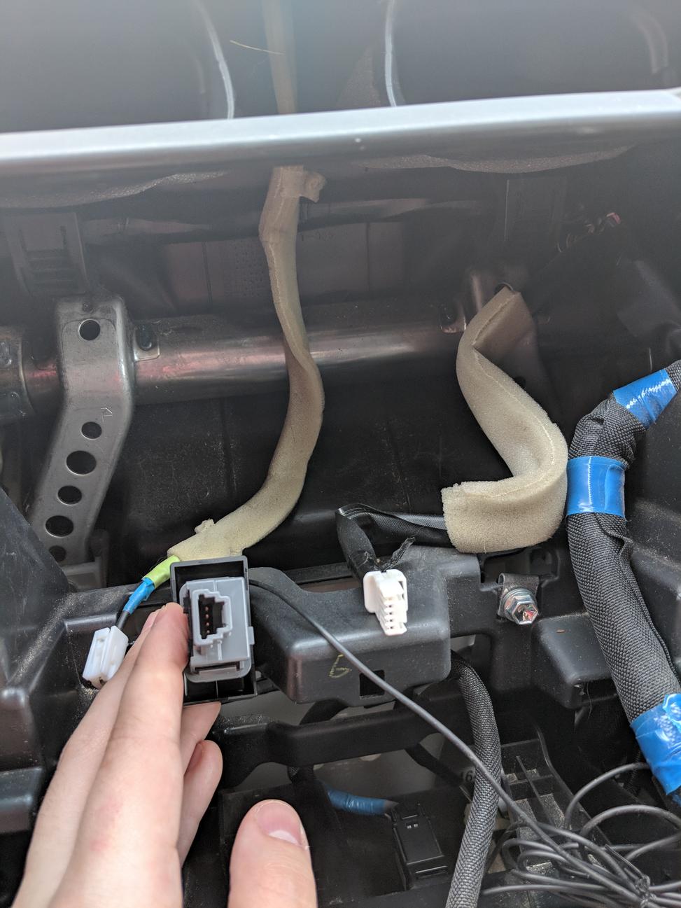

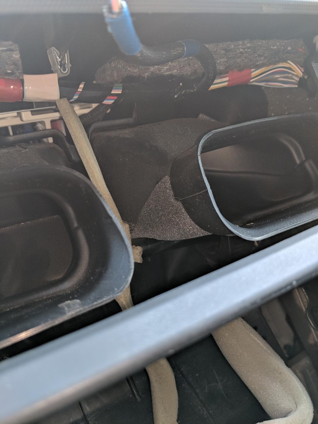

Old thread but similar problem I have now. The difference being I can't find my hazard light cable! Does anyone know where the cable originates from so I can trace it back? I can't find that grey cable anywhere! Am I missing something obvious?
Bumping this old thread.... I installed an aftermarket head unit and am having the same problem with not being able to find the harness for the hazard lights. Did you ever figure it out?
