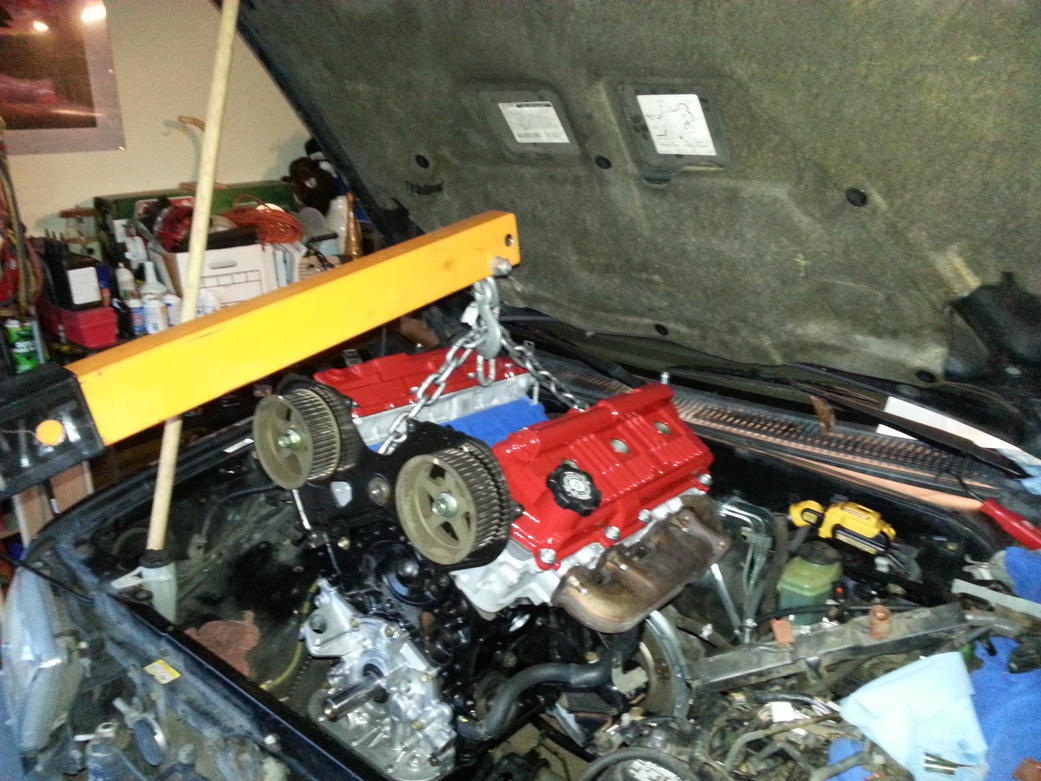

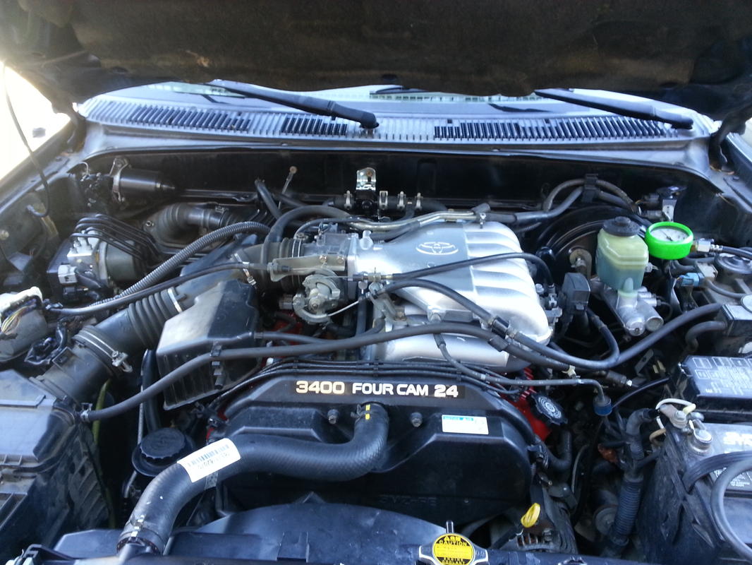

That is a good price for a used engine and can't beat the 6 mos. warranty it's about the same here in the bay area.My advice would be is for you to bench test the used engine and make sure you got a decent compression on that engine also reseal the engine if the compression looks good drop the oil pan and make sure nothing is coming apart in your replacement engine. Good luck in your engine swap i just finished mine a couple weeks ago.here is some teaser pics to get your butt in gear.LOL

One more
Here is the finished product it took 2 weekends to finish everything.Glad it was done now i need a suspension lift.
Heh, that's some paint scheme you got going there!
