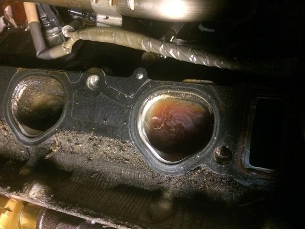

the old girl started pumping out the white fog one day, i pressurized the radiator and here's what i got in the plug hole.
took the SC and intake off..

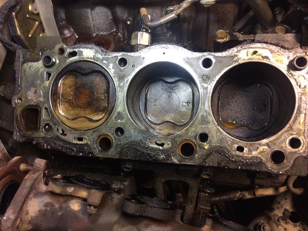

you can see the "steamed" valves and piston

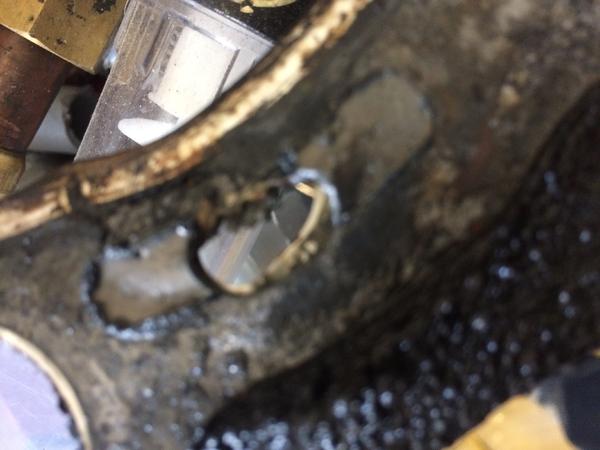

here's what i found on the head gasket
Sorry to hear about your head gasket ..
Just curious but are those metal chunks on the last pic meant to be there? just kinda blurry and it looks like metal parts may have flung off.
Totally sucks for sure. Post up what you did, parts, cost, etc. to fix it. It will help others who might run into this. It is an extremely low chance of occurring but just in case. I read some place where the odds are worse than winning the Lottery.
i think that's just oily crap on the gasket - the metal ring on the gasket that goes around the cylinder had a squished divot on it, which i think led to the failure. i suppose it has been on there since it was new.

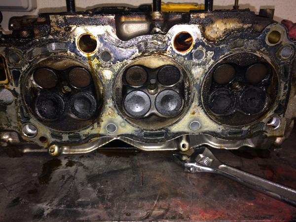

just got a call from the machine shop, the head is cracked and no good. that sure explains a lot.

i went by and picked up the head from the machine shop and the crack is between the intake and exhaust valve, in that smallest area. it makes me think that i had two issues, unless someone tells me there is water in that part of the head.
