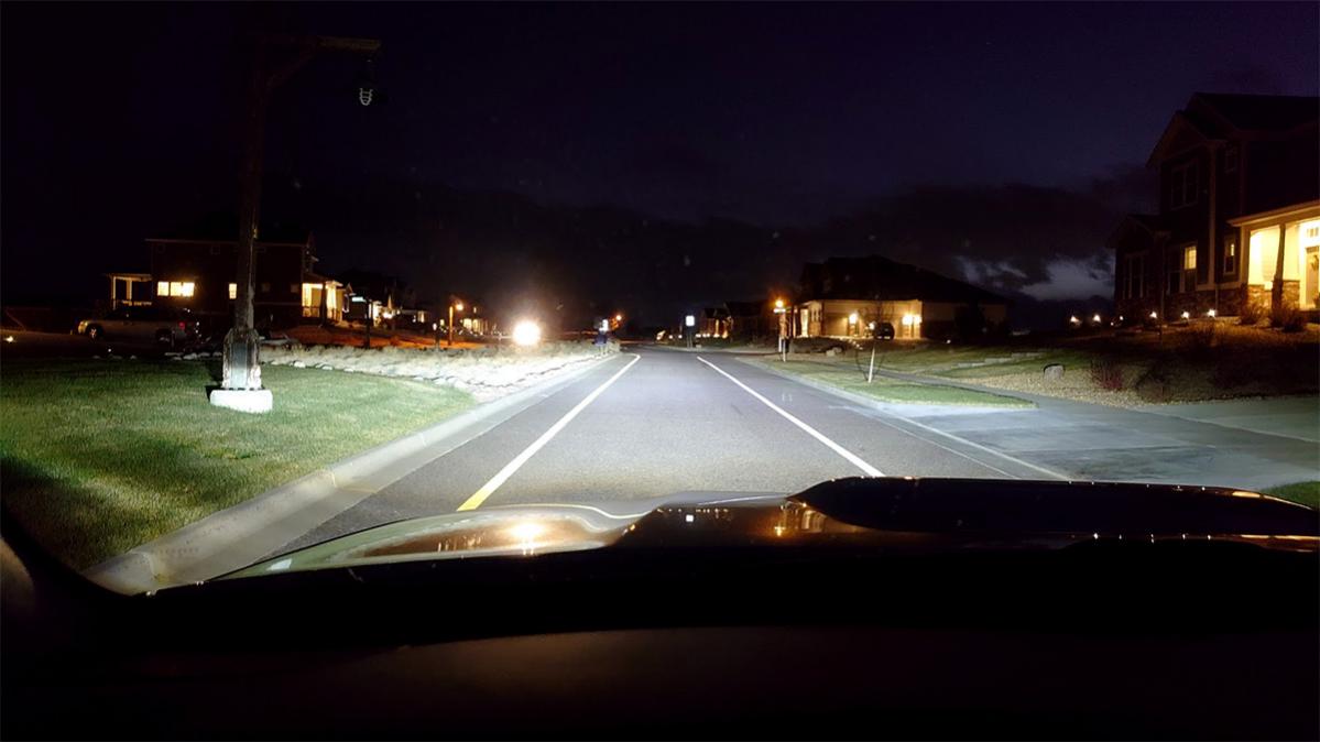

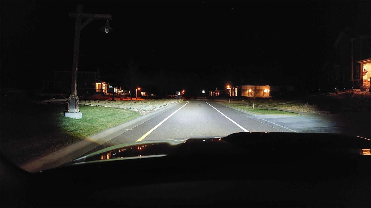

Updated output shots.
Low beam only:
Low beam plus fog:
High beam:

Photos differ greatly from what you actually see when looking into the headlights. I tried to capture this last night and the photos made it appear blinding.
Good comparative post here. Those Alpharex headlights look terrible. All foreground lighting with no distance. Good for instagram only I guess.
