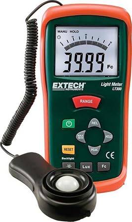

Major point of contention is whether or not the gentleman at LIGHTWERKZ is using the LED measuring device. I recently discovered through a man in the trade that the readings will not be accurate if using a HALOGEN model.

Looks to be an Extech LT300. I don't think this one accurately measures the spectrum that LEDs operate in. I understand it's a comparitive measurement in this case but shifting from halogen to LED will not have a proper control subject. From what I understand they actually under-represent true output from LED. Still, a measurement of maximum intensity does not tell the whole story.
25-30 feet away...I've been to that shop many times
Better, but still not ideal. Drop-in LED bulbs can be brighter than halogen, but it's well known that their dimensional limitations contribute to lack of focus and a downward shift in hotspot placement. This is what causes nearly every hack LED bulb to have reduced distance projection.

Still awaiting on a response from Lightwerkz and Crashburn80 showed me what the different module for LED measuring is recently so I'm hoping they reply accordingly.
