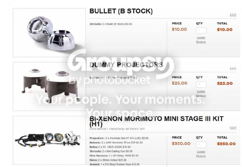

Not to hijack. I got an email back from TRS about the FX R Bi. with the 3five bulb and shroud came $200 out the door. Standard low beam with an RX or TSX is $275. What's everyone opinion on the FX R? I already have the PNP HID which is somewhat getting attention from other drivers. I did lower it a bit but I still occasionally get flashed. Light output is phenomenal with no hotspot and much wider than stock. I don't want to aim any lower as it takes away the purpose. So I want a projector but not go overkill on it.

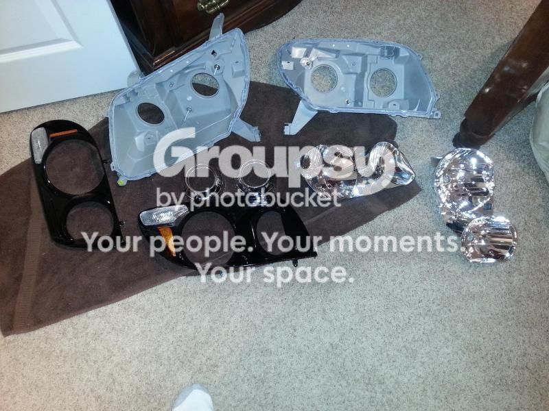

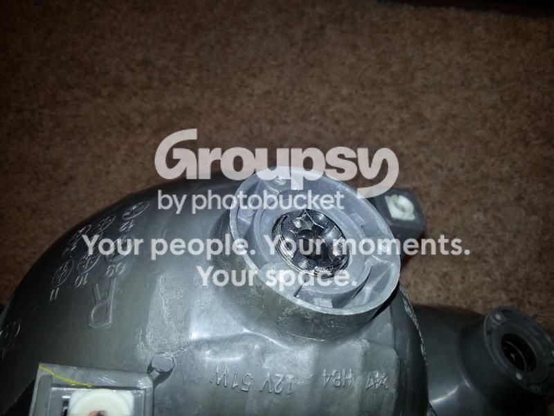

Encounter my first hurdle, need to do so dremel trimming for the HID reflector to be expose more.
As Far as opening the housing, it was very easy. It just takes time and patience but it was easily than I thought it would be. 265 degrees for 7 minutes, it was perfect.
Can't wait to get mines. I ordered the FXR. Did you get the 3five bulb or their newer version XB35?
XB35, when spending over $270, what is an extra $20 you know
Yea extra $20 for something better no big deal. The XB was back ordered for me so hopefully I don't have to wait too long for it. Or maybe shoot for the Phillips for an extra $45 instead of the $10 for XB. Gotta give them a call or email now since we're chatting. LOL

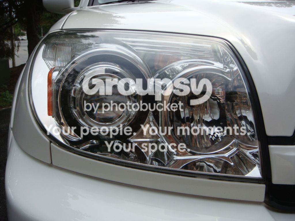

I'll second the TL retrofit! LOL. Anyway, the TLs are freaking epic. The 06-09 projectors are sweet, but a retrofit can/will blow it out of the water.

Im going back and forth. About a year ago I bought all parts needed for a 03-05 retrofit. Got everything in and buttoned up, but had MANY problems (my own doing, of course). I couldn't get the darn headlights to reseal correctly and I also was having such a hard time correctly aiming the projectors. Every time I thought I had it right I would test drive and I would get flashed by oncoming traffic.
Also, possibly from the aftermarket Depo headlights I used the front plastic showed stress or heat? cracks right in front of the projector.
Sadly I scrapped the build and went back to the terrible stock and foggy reflectors. Been saving to get the 06-09 OEM Sports instead.
I still have all the parts, in case I rally up the courage to try again though.
Retrofitting is hard work, I just wasn't versed enough for the job :/
