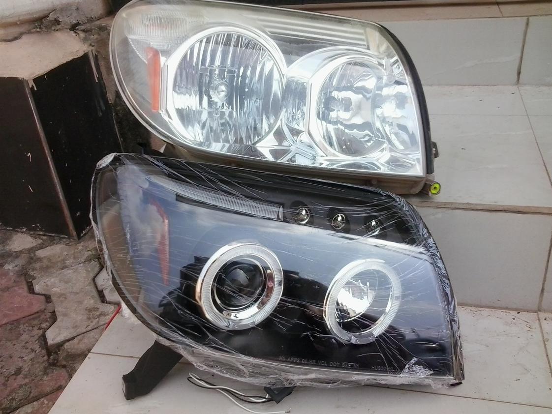

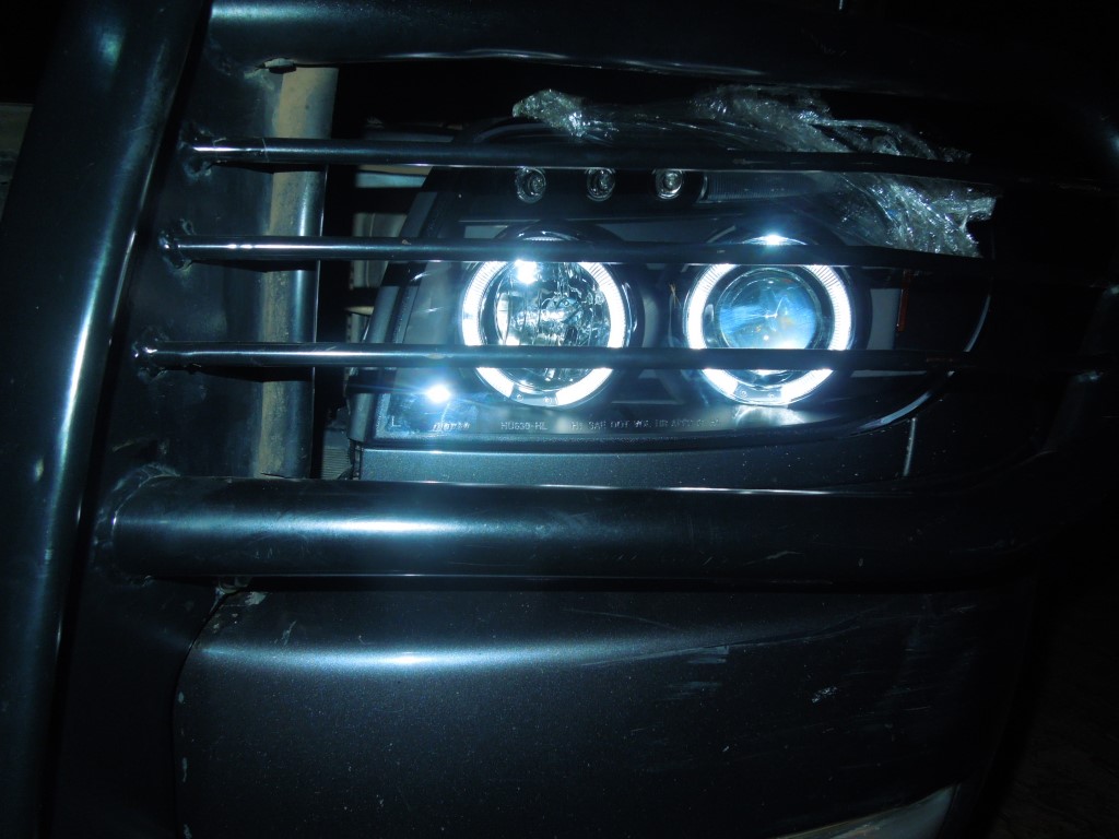

06+ hvae projectors, y dont u buy drop in hid-projector kit.......am running them on my 05 n ther awesome!.spec d. alredy blacked out

Thanks for the info. I know the hid in the halogen projectors isn't ideal but it will be a step up. I e seen photos of the gap using these and I'm not terribly concerned.
[MENTION=78511]earthrealm[/MENTION], those are cool, but my truck is silver and I'm not diggin the black.
I just saw some photos of your truck in another thread. I didn't think I'd like the black on silver, but it looks much better than I thought. Nice truck.
