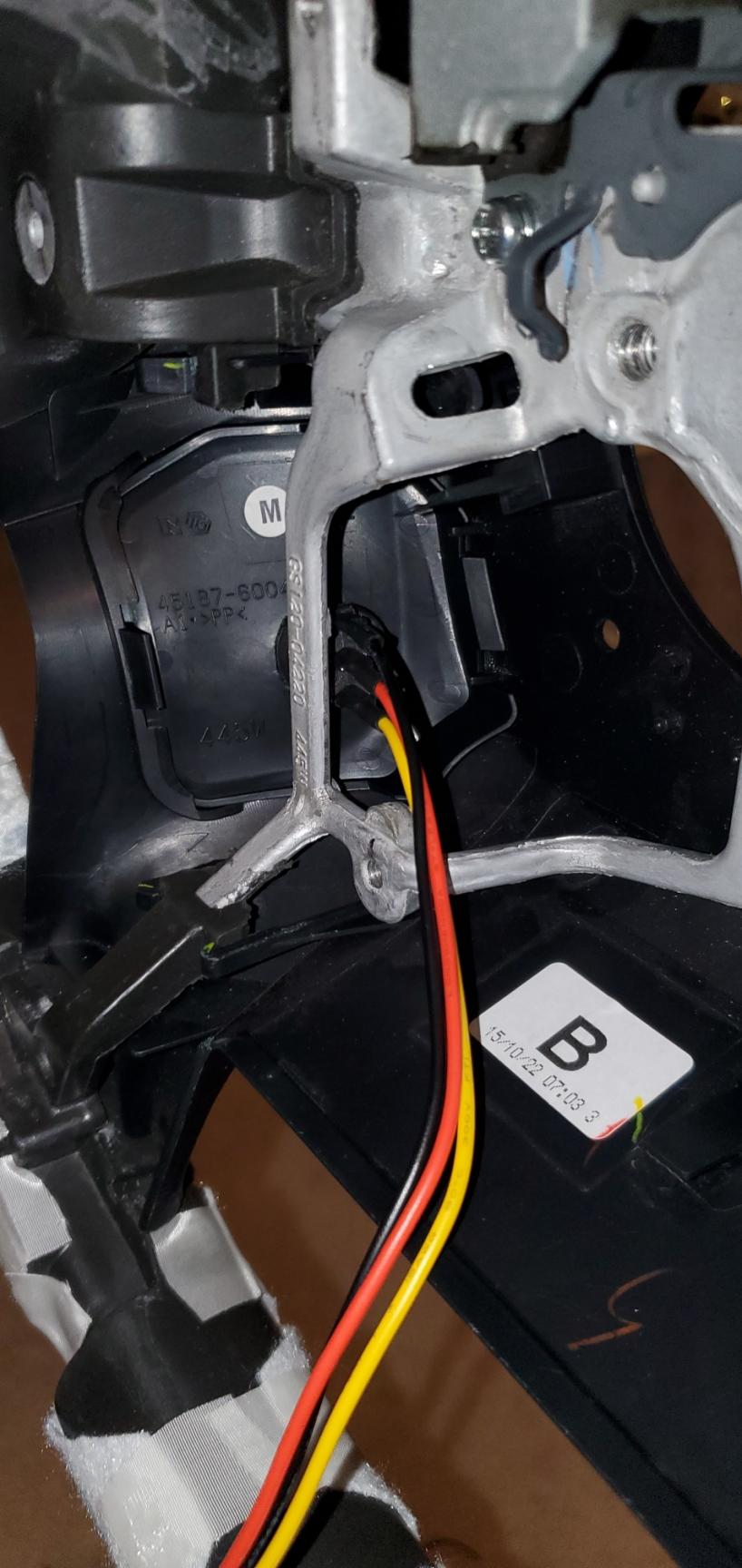

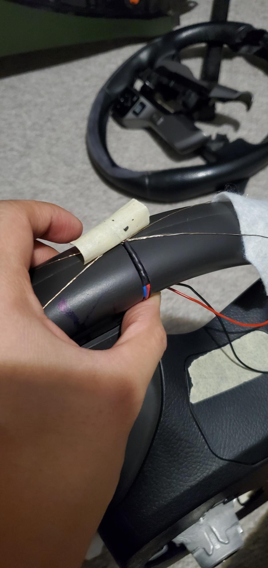

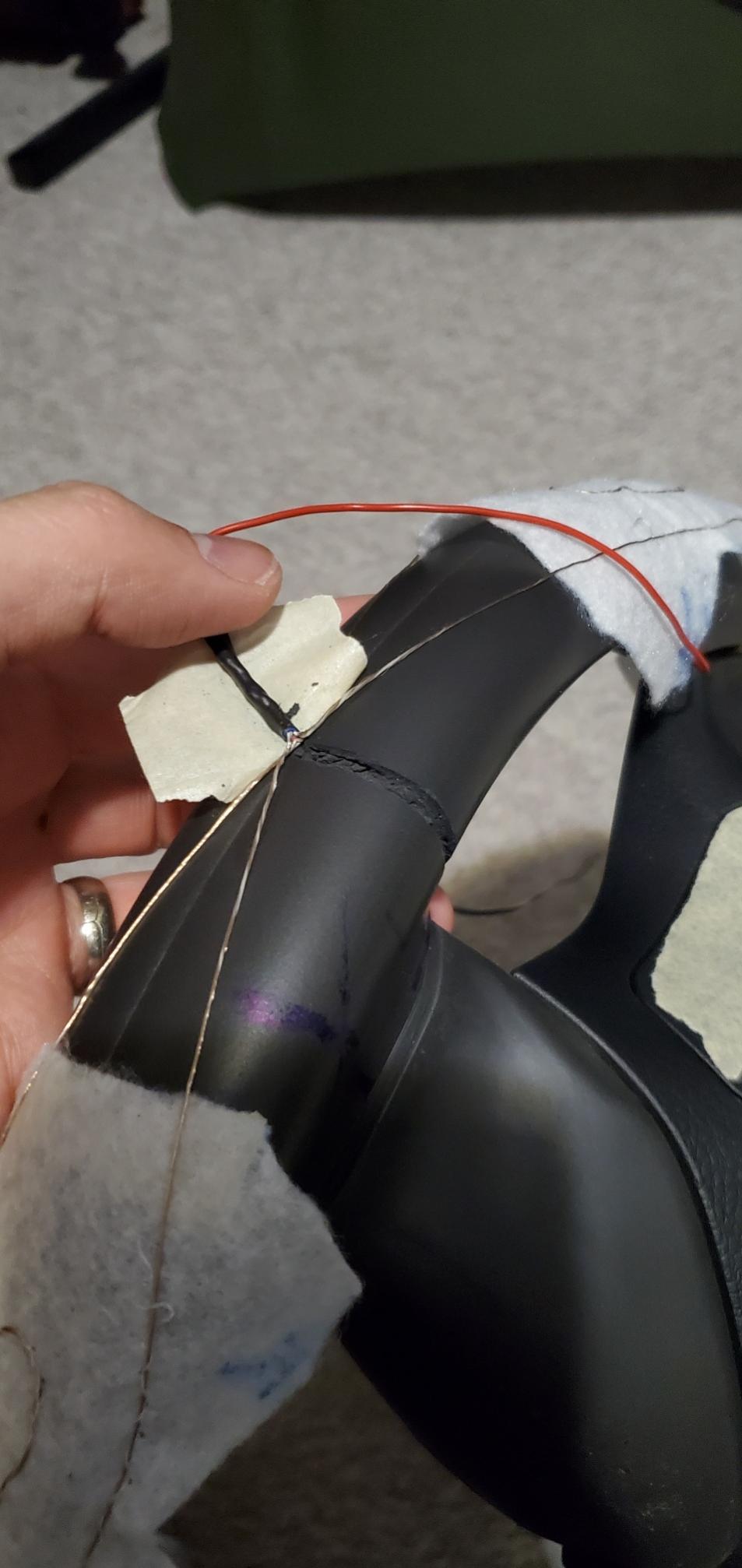

Cut out a groove so there is no bump under the wrap. Wire sits in there perfectly flush with the steering wheel.

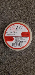

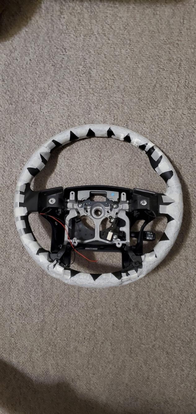

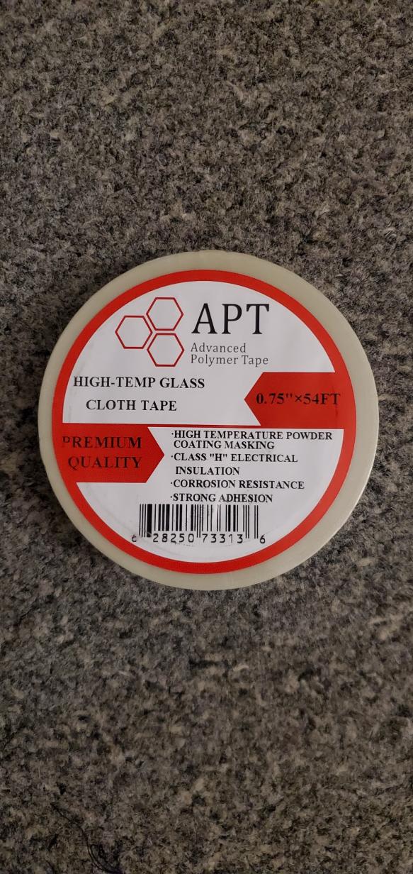

Bought some high temp cloth tape to hold down the heating pad. I don't think it's necessary but I thought it would be better and safer than just regular tape.
And here it is all wrapped up nice and tight. Still waiting for the aftermarket wrap...

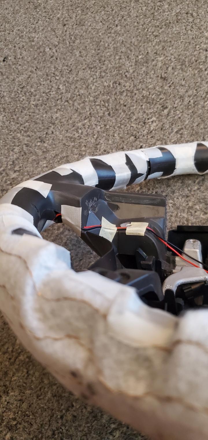

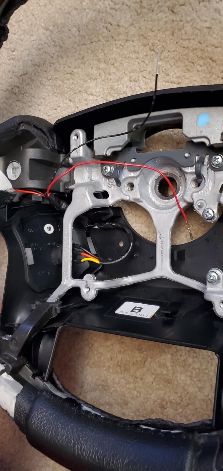

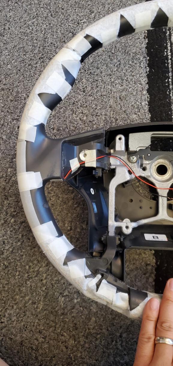

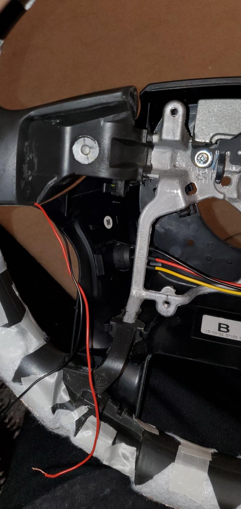

Just another angle of how I ran the wires. They are tucked in the normal grooves and a couple grooves I had to carve out. I wanted a flush finish so there would be no bumps under the wrap.

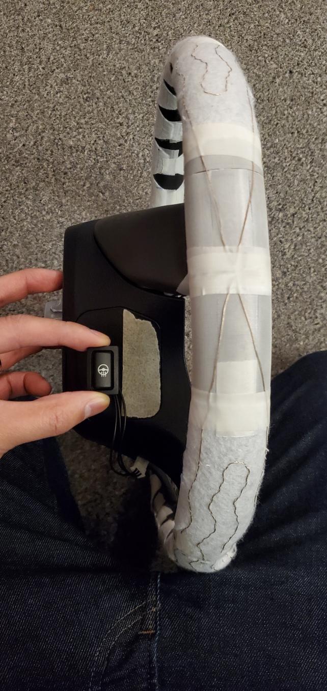

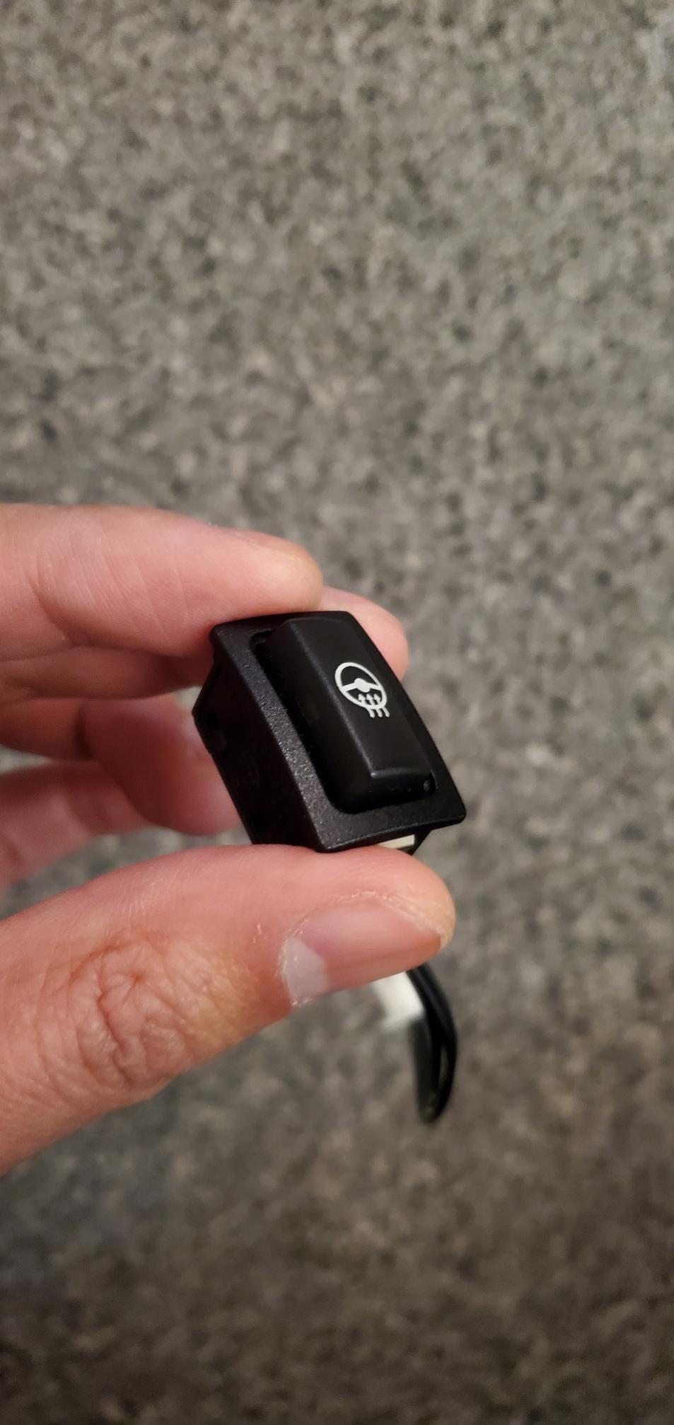

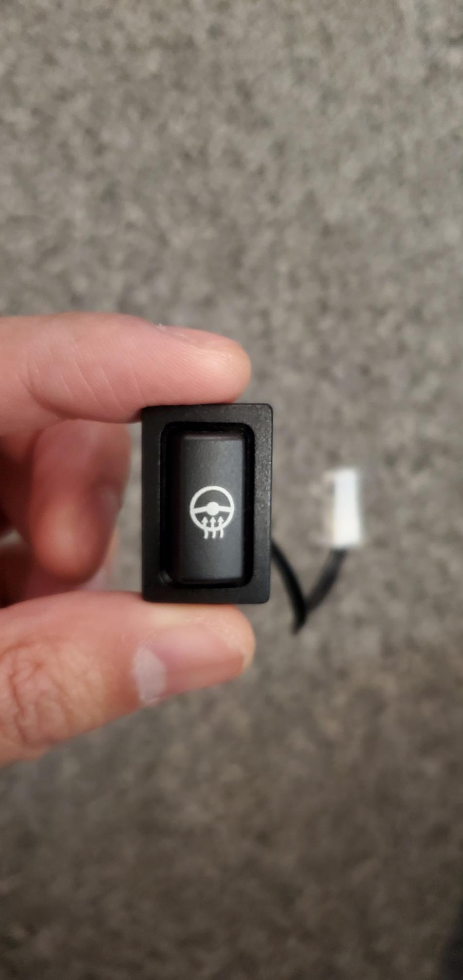

Bought this switch which is from a BMW but for some reason it does not seem to work. Power goes through but not enough. It doesn't seem to heat up the pads. On top of that it is momentary. I thought it was a maintained switch. Too bad as it would've looked somewhat OEM.

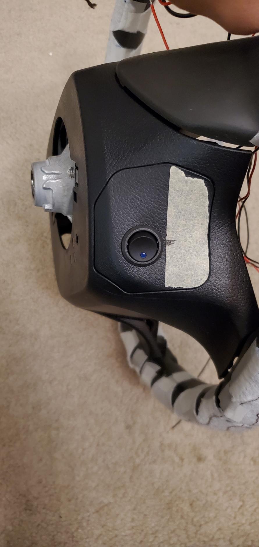

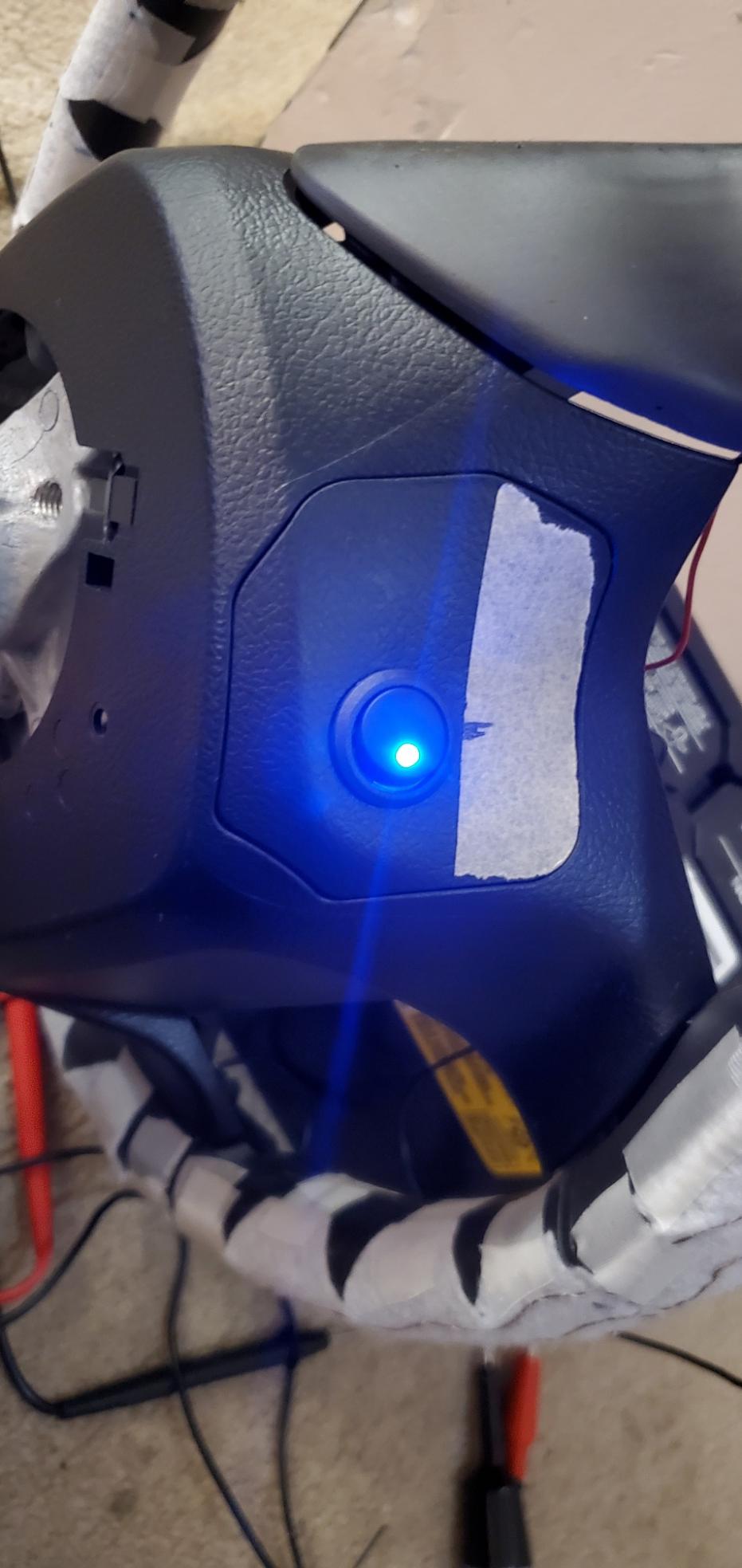

So I ended up using the switch it came with. Worked in the location I wanted but not quite the look I was hoping for. Did a mock wiring setup with an extra battery and everything worked. I put the switch to the side of the steering wheel as shown. It is in perfect reach of my fingers. I don't even need to take my hand off the steering wheel to turn it on and off.

Maybe?!? I just wouldn't know how to wire it up with a relay...
You'd need to use a latching relay that resets when the vehicle voltage is removed.
So the BMW momentary switch would create the 12v signal to "latch" the relay on, and would stay on until the 12v line voltage drops when the car turns off.

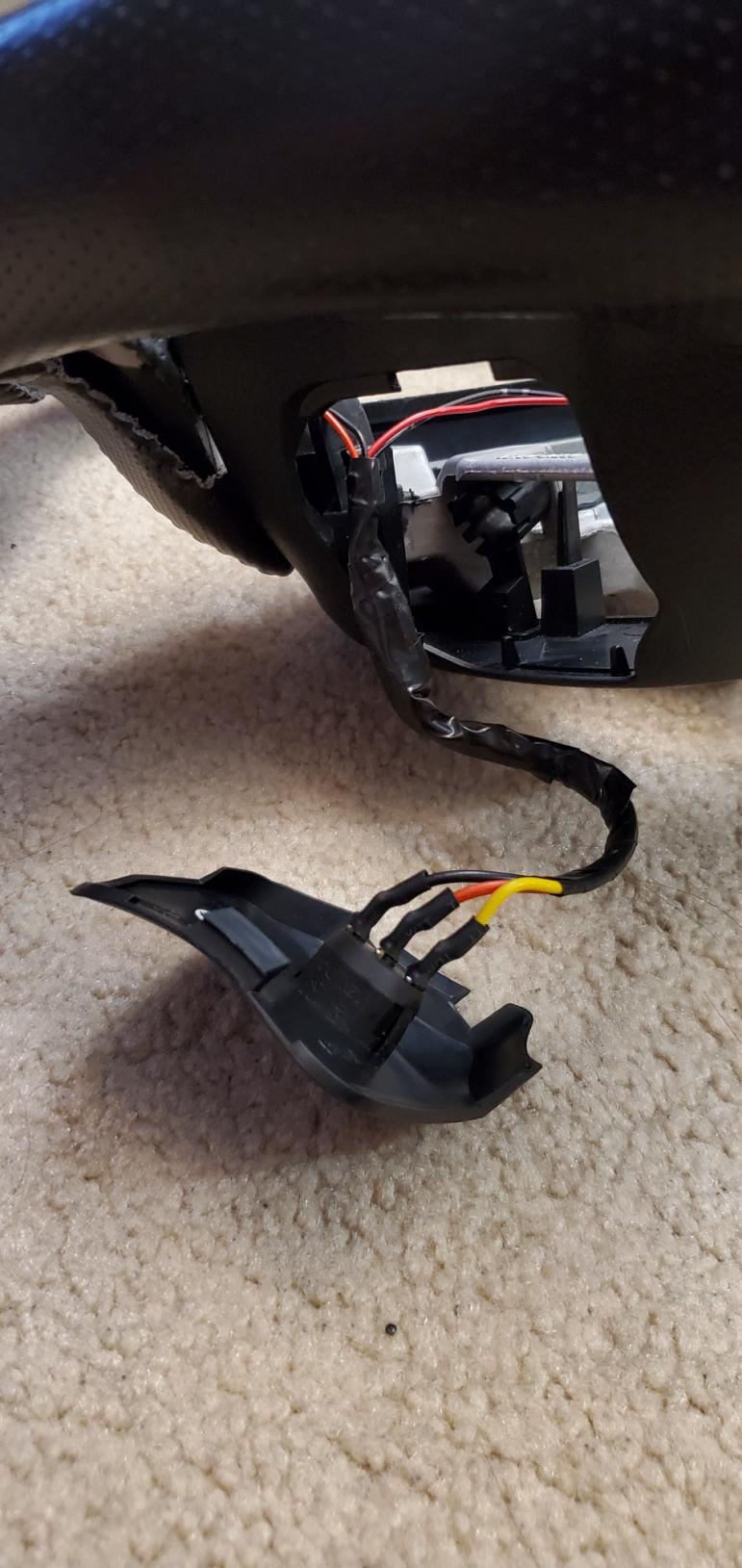

Got my switch wired and taped up to take up minimal space.

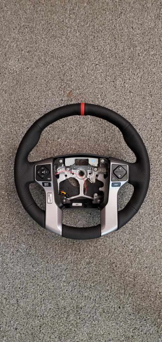

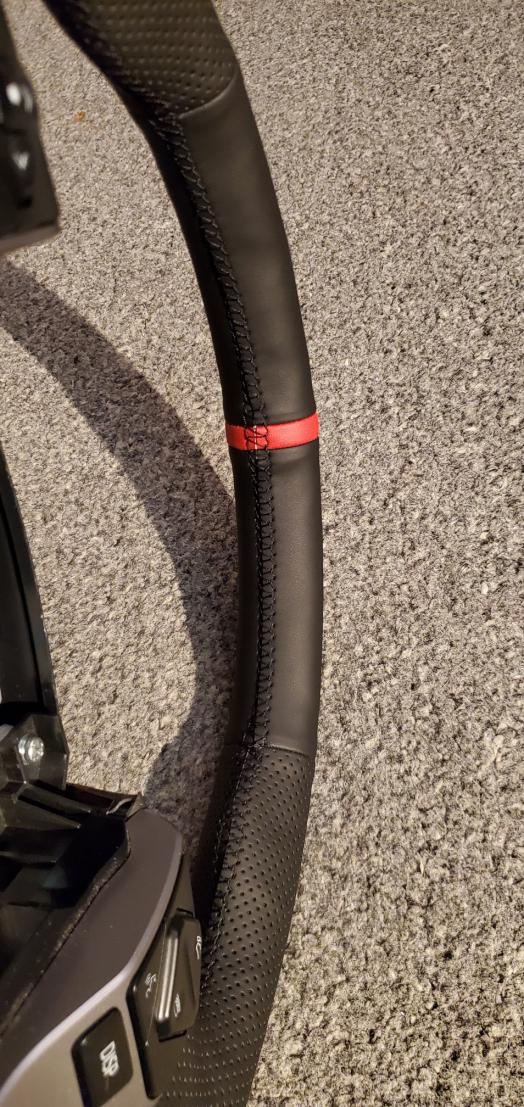

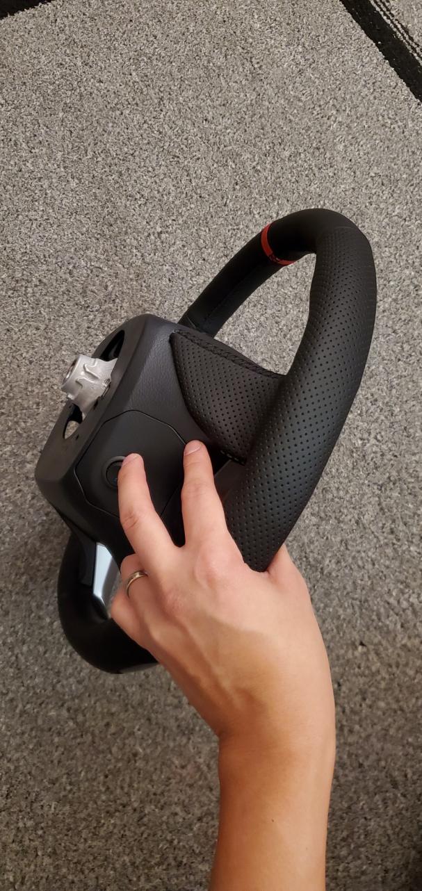

The wrap finally showed up and had some time this weekend to put it on. It is not perfect but overall I am pretty happy with how it turned out. Here is also a shot of the stitching and another shot of the switch and how easy accessible it is for my fingers.
