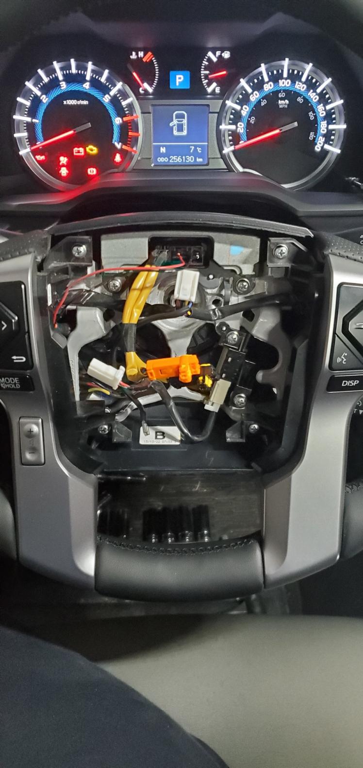

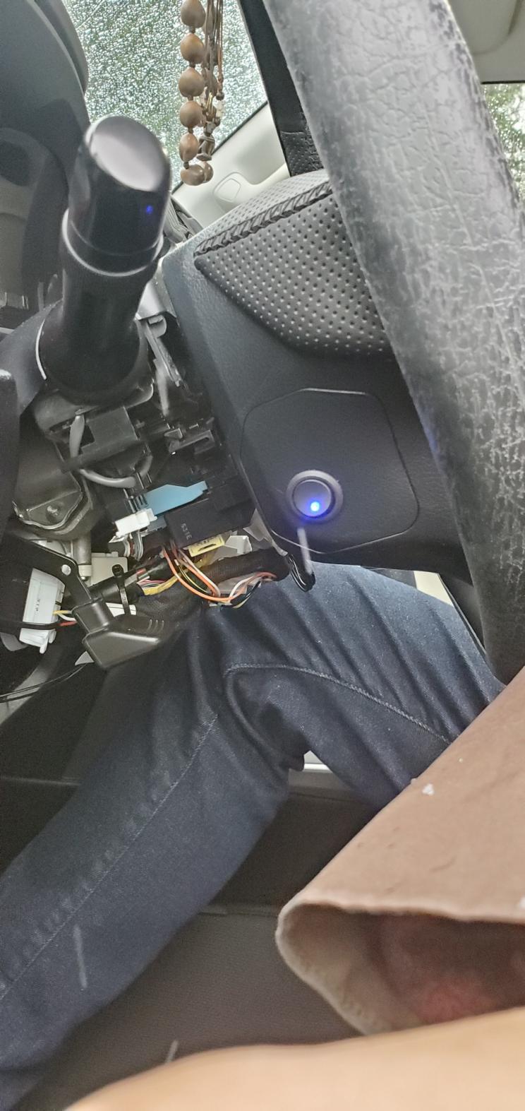

So I was able to remove the factory steering wheel and install the new steering wheel. I did a mock up of the wiring where I plugged in the wires onto the pins without inserting yet into the connector (2nd pic). It all worked great with no issues when tested. The 2 wires went into the 2 connectors behind the airbag. I ran a power wire from an empty slot in the fuse block to the empty spot in the clockspring pin as previously posted. I also ran a ground to the 2nd empty slot in clockspring pin as also previously mentioned.
Now the hiccup I ran into. The 2 wires behind the airbag fit perfectly into the existing white connectors with no issue. I was under the impression that I could do the same for the black connector on the backside for the clockspring. Unfortunately the 2 wires do NOT fit into the black connector. If they fit this mod would have been a success.
Now I am looking for an extra black connector with pigtail harnesses already installed. Does anyone know the part number? If I get this, I can depin the extra connector and install them into existing connector and this mod will be done and finished. So this is where it's at for now...

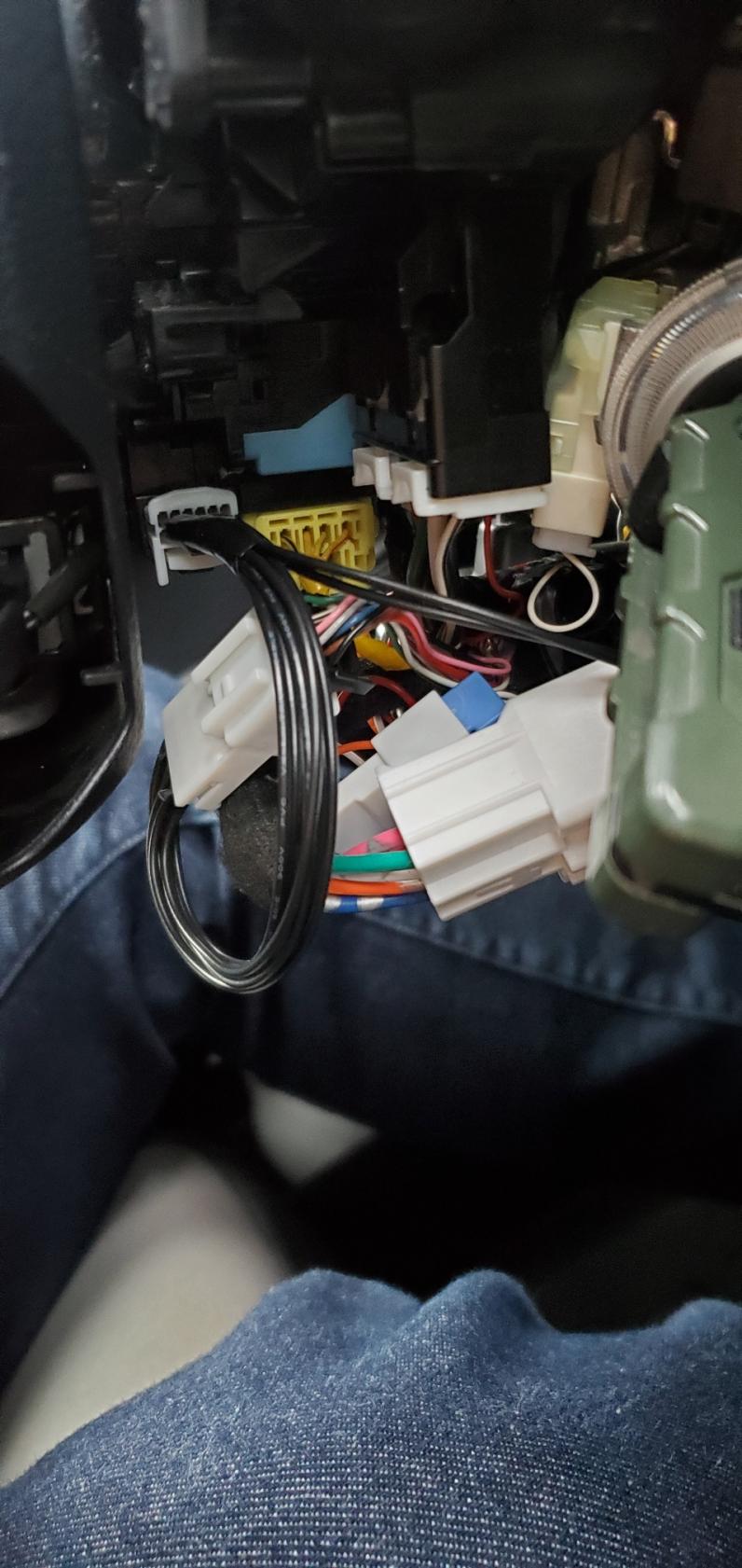

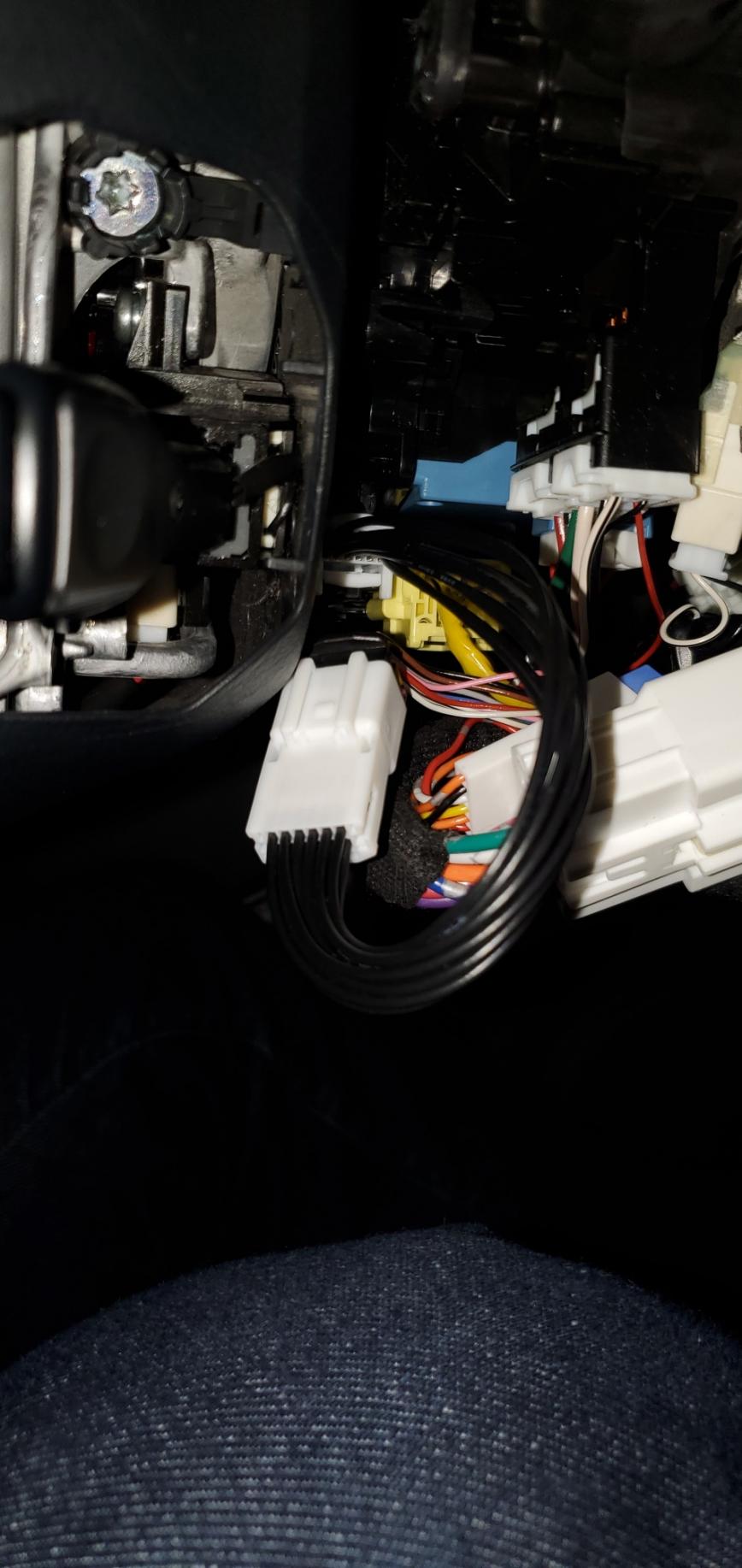

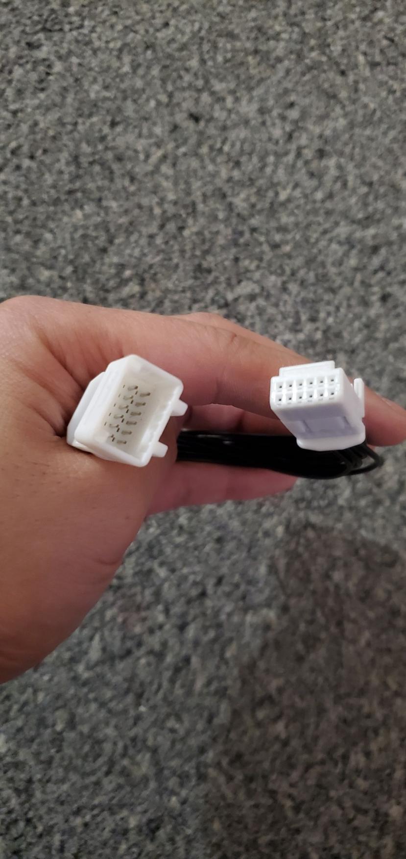

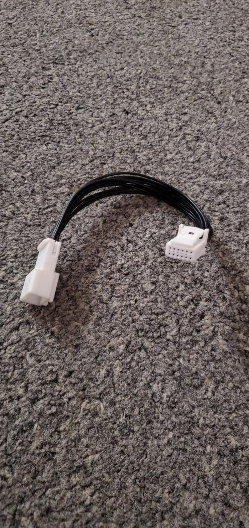

So I found a solution to my issue about the 2 wires going into the back of the clock spring! I found this male to female 12pin harness on AliExpress! It took a few weeks for shipping but showed up today. These fit perfectly for what I require it for. Only downside, which isn't a huge deal is they are longer than what I need. They mate perfectly with oem connector and actually clicks in place unlike other cheap overseas options. Here are a few shots of it. I will install this weekend so this mod can finally be done! All I need to do is splice into the harness that corresponds to the correct pins.

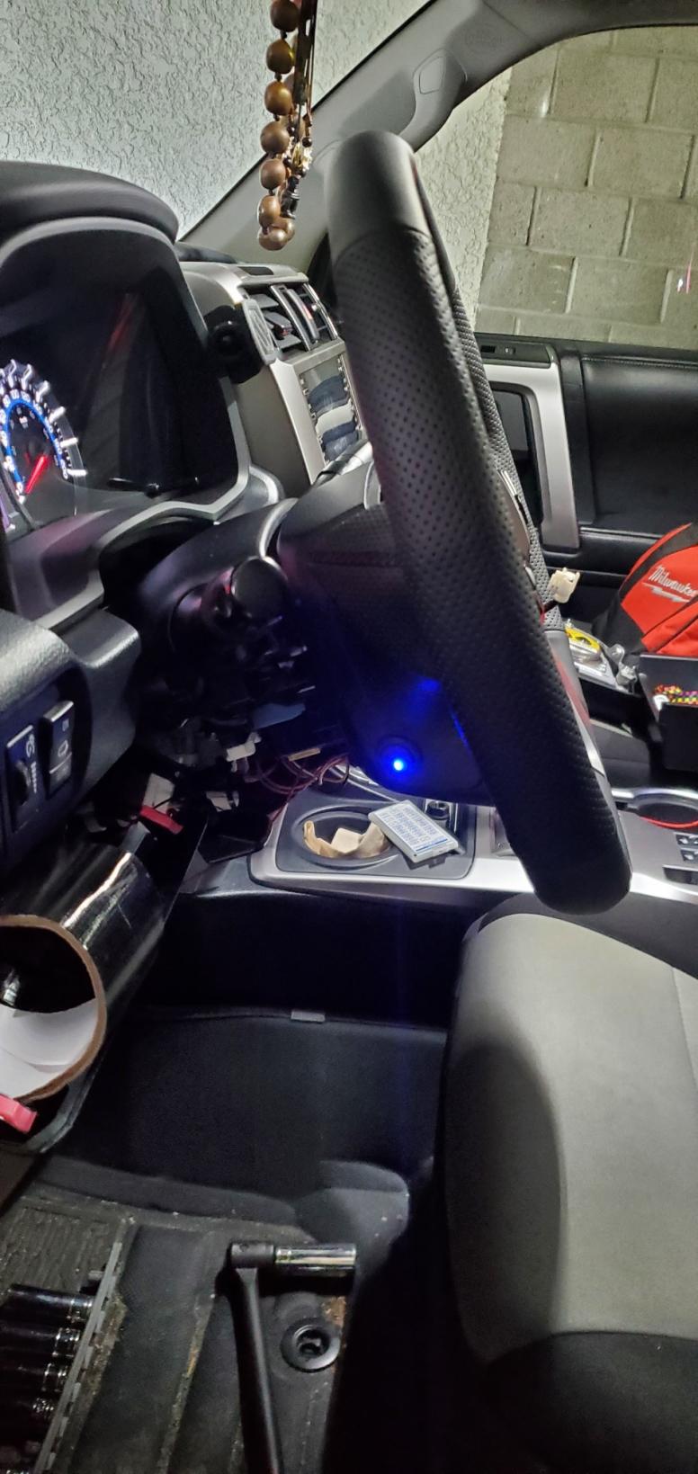

I was able to modify and add the harness. Happy to finally say that this mod has been done and is a success! In time for the first snowfall of the year here in Vancouver, Canada. Had it on for the 45min drive to work with no issues and no overheating. Just a nice constant heat for my hands that is not overly hot.
Here is a shot of the harness - 2 wires separated. 1 is for 12V which comes in from the fusebox. The other wire is grounded to a bolt underneath the panel, right above the fusebox.

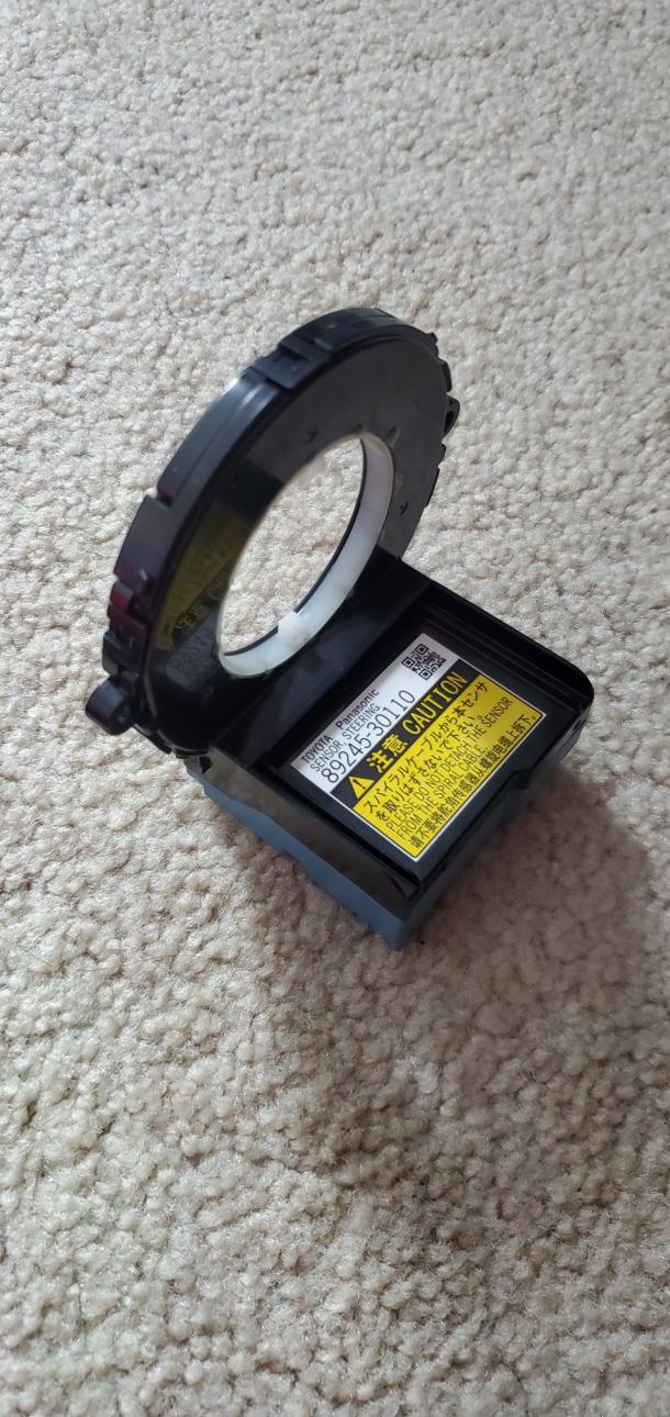

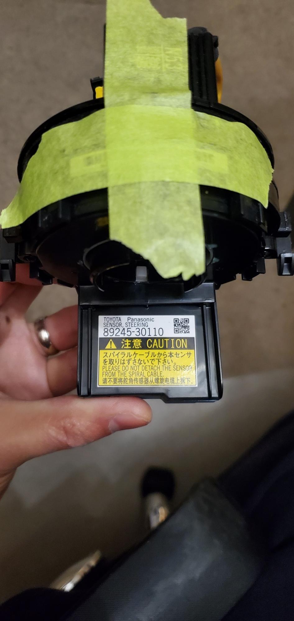

Just throwing it out there for future reference. If you do this mod, or any steering wheel mod, there is a chance you may tweak your steering sensor, resulting in unwanted lights coming on in your dash cluster. The TRACTION and POWER STEERING lights came on for me thus disabling these functions. If this happens, you may need to replace the steering sensor, part number 89245-30110. Once I replaced this sensor the dash lights went away. I found an aftermarket option on EBay as the dealer does not sell separately (at least my local dealer). They told me it is sold with the clockspring (which I didn't need to replace).

Having also been through this, you also need to do the Zero Point Calibration..
