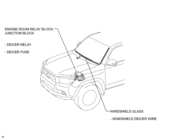

In the glass.
The heating element in the windshield is located where the wipers are at "rest" and then runs along side the "A" Pillar (in the windshield) on the drivers side only, not the passenger side as it is not needed there.
.::: EDIT :::. Well there you go... [MENTION=105875]96r50[/MENTION] posted just before me to clearify!
