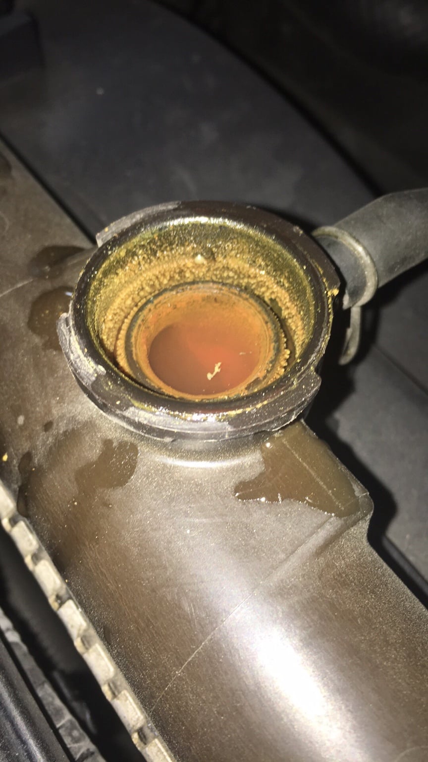

Now that it's finally getting cold here in Texas, I found that my heater does not function well. After about 15 minutes of driving, it will finally blow warm air. But still not as hot as it should be. A/C blows cold.
I've attached a picture of my radiator which contains some deposits near the top.
Would a complete flush of the coolant and replacement with Toyota OEM coolant help? Maybe there is something else I should check?

I am no expert but your coolant system has seen better days. I would think you have some flow issues in your heating components for sure. A cleaning and flush for sure.....I would even let it sit and soak for a while and maybe more than one time.

It's time to get on your knees and pray to God it's not your heater core or that if it is the heater core, [MENTION=117677]A-dog[/MENTION]'s steps resolve it.
Even if you don't believe in God, this is the time to my son, this is the time.
BTW, your coolant looks like Tomato soup you can order from Panera.

Lol yup. Or your whole DASH is coming out bud.
You may have bigger issues based on the color of that plastic tank, I'd replace that & thermo/gasket first....
^^^^ This...the thermostat will likely fix your heat issue and the new radiator to avoid the pink milkshake.

looks like that radiator I had back in the old days early 80's.
I HAVE OLD HIGH MILE VEHICLES.. I do all this type repair work. the coolant systems require distilled water and the proper antifreeze of at least 50%. using other water will cause all that crap to grow and plug up your coolant system.
I have a 1996 that I just did the coolant servicing. 3.5years was the last servicing . the pressure tank had no crap in it at all. reason is no dirty water used only distilled. I also use 65% antifreeze because of the additives that prevent corrosion.
many in the warmer regions do not use the proper amount of antifreeze and also use bad water sure you may not require that heater to work 100% like up where I live but when summer heat arrives that engine will get cooked.
I would do a complete block drain , remove T stat. flush the heater core, run with distilled water and some cleaner product for a few miles then drain it all out flush it then if clean use the proper coolant and distilled water.

If I were you, I'd replace the radiator first. Then before refilling, I would flush out the heater core using the CLR method described above. Do not apply to much pressure to the heater core because it can rupture, you would be screwed.
Once that was flushed out good, I would then refill the system with distilled water and a coolant flush product (follow directions on the product). Once that was all done, I would drain again and fill back up with Toyota coolant.
Your entire system will be flushed and clean. Your heat should work wonderful again.

One of top five things to do before buying a used car or truck is to look under the radiator cap. Always.

Agreed with all of the above regarding new radiator, coolant system flush, heater core flush, etc. It will save you major headaches down the road.
But: Where is your temp gauge after the engine has been running for awhile? A stuck open thermostat will result in no heat, because the engine never comes up to operating temp.
