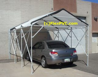

construct a tent room or whatever. a smaller space which you can heat. drive vehicle in, lay rigid foam on the floor, lay plywood/osb/wharever over it to insulate from concrete floor, or this stuff Exercise & Gym Flooring - Flooring -Â*The Home Depot. pvc frame? pipe? wood?cover with clear plastic. Ideally, figure out a way to put a second sheet above the first with an air space to create a thermal space, like a double pane window.
FlexPVC.com Projects, aka, What can you do with all these pvc parts and fittings?
