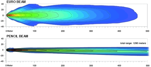

Beam-wise,I'd go with driving reflectors. Pencils may reach farther but the pattern is narrow. Auxillary Lamp Beams - RallyLights.com
