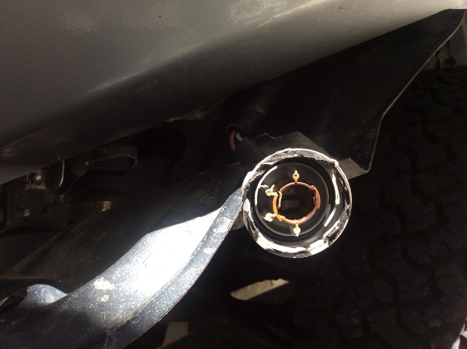

Just the other day i was thinking about all the complaining that was done on the hella lights, water intrusion etc, but mine have been fine for approx 2 years.
Got in truck today and have fast blinker. Turns out the Driver side hella is burnt out. No big deal except all the plastic tabs were 97% broken. The remaining 3% didn't survive even the inspection process.
Are there any good plug and play LED options w/o complicated resistors or whatever to keep the signals flashing normal?

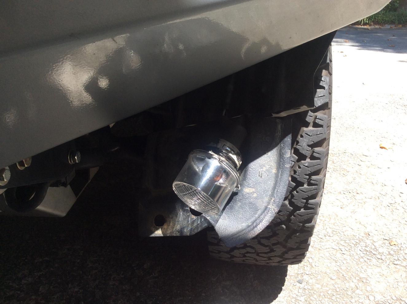

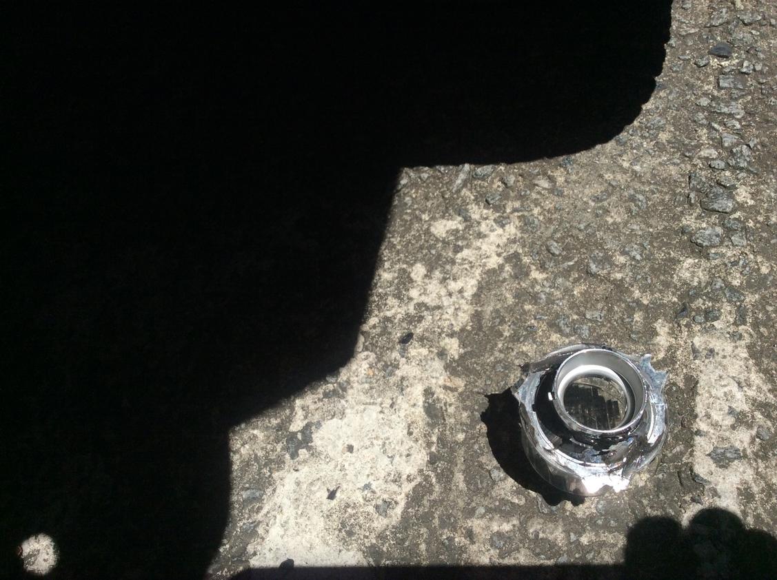

Picture 3, plastic is well done, looks like it gets hot in there eh?

Basically, no. You'll have to use a resistor as the flasher relay is not easily replaceable. If you use your turn signals as DRLs, the resistors will burn out quickly.
Ok I'm replying to this because I now need replacement Hella lights or something comparable (turn signals). I removed the old lights from my (used) bumper because the tabs holding the lights were mostly broken. I had to dremel off the existing screws because they were rusted on.
Anyway....

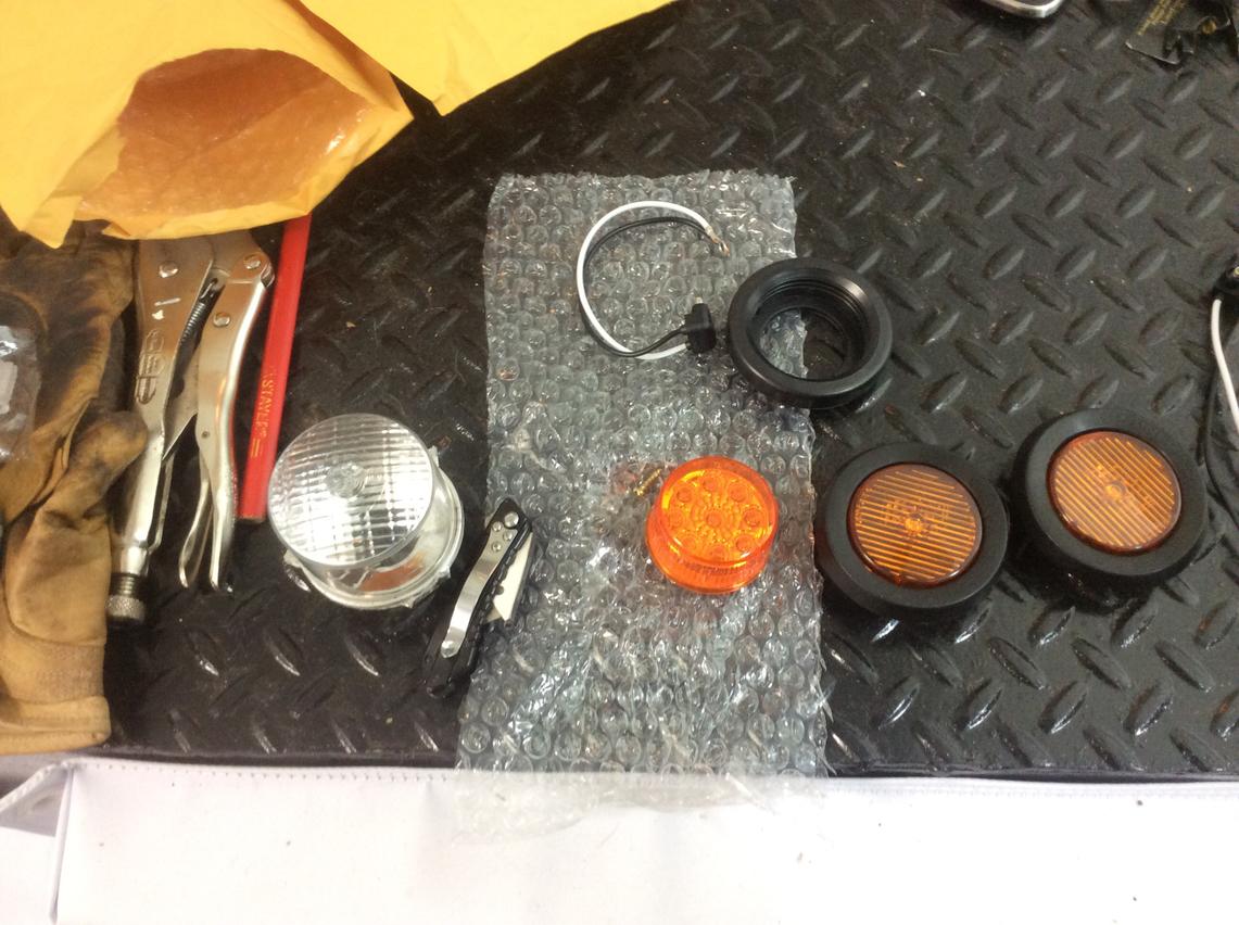

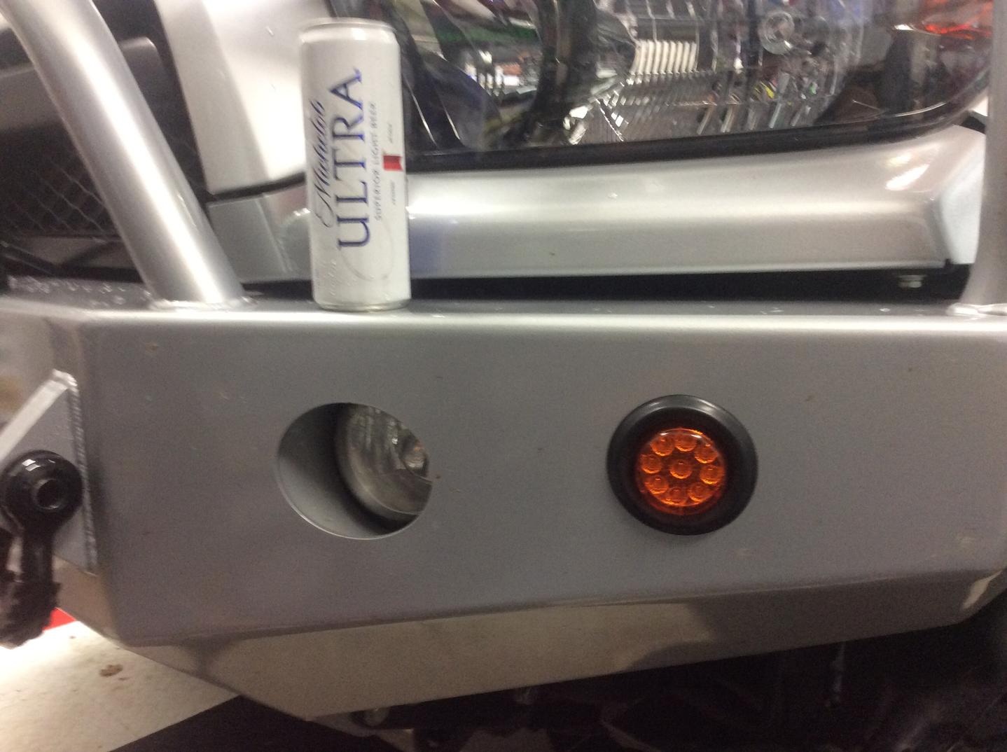

Go LED and get some resistors. It's not that complicated of an install. I bought some 2" or 2.5", can't remember exactly which size, Led turn signals from Kragen. They're meant for trailers and they fit in there perfectly with a rubber grommet they came with. They haven't moved a mm in years. I also wired up some resisters to prevent hyper blink. The link is below. They work and function way better and they are waterproof.

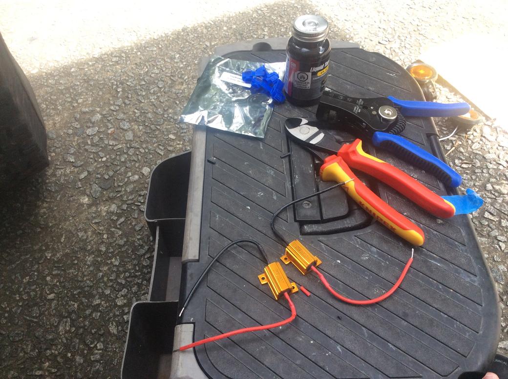

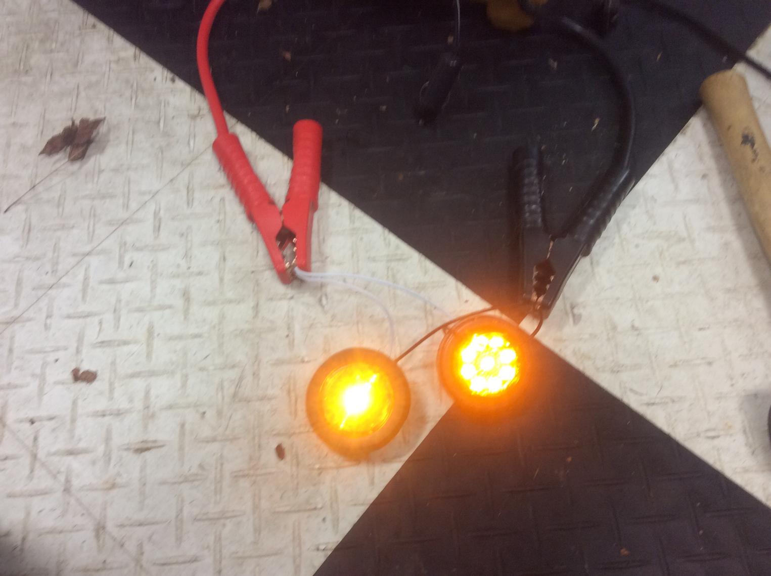

Resistor still has not shipped but here are the New LED parts

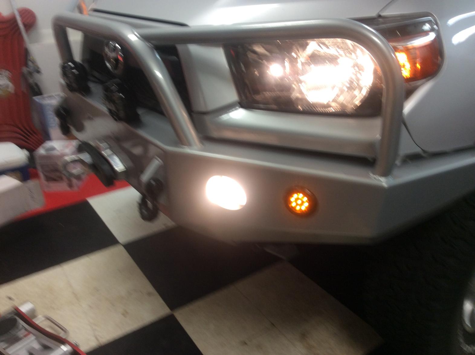

Follow up: resistors were installed and everything has been working as it should, but I dont run DRL only very much anymore.
