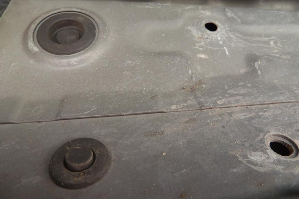

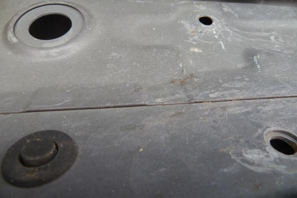

Yep, those are the culprits. However, if you look at the forward-most set of mounting holes you will see that just forward of them is a rubber plug protecting a hole 1 inch inch in diameter.
See pics below, first with plug in place, second without. For orientation sake, the plugged hole is toward the front of the vehicle and the bottom of the photo is the outside edge of the undercarriage closest to the bottom edge of the passenger side front door.
I am wondering if there is a long flat wrench, with an offset on the non-business end that would allow me to reach in there and hold the nuts in place. The closest of the two is about 4 inches from the plugged hole and the other is about 5 1/2 - 6 inches away but on a slope. I imagine I could find some kind of "stickum" to temporarily hold the nuts in place on the wrench until the bolts grab and hold them. Anyone know of such a device?
Oh, and what does "captured" mean in this context? How were they originally held in place? Any idea?

captured... in other words tack welded. Nutsert is going to be the easiest solution. If the capture nut is still there you will need to take a punch and pop it loose completely. Get a magnetic rod and pull that our of the body through the plug
You could also weld a rod to a nut. May have to make some creative bends, but if you get it just right you can line the nut up with the bolt hole and have the welded rod behind the big hole. This would allow you to hold the rod/nut while you tighten the bolt. AKA stick-nut.
With that big grommeted hole there your possibilities opened up!
yep, I have tack welded a nut to a wire coat hanger before and snaked it through.... as long as you get enough RPMs behind the bolt it will catch

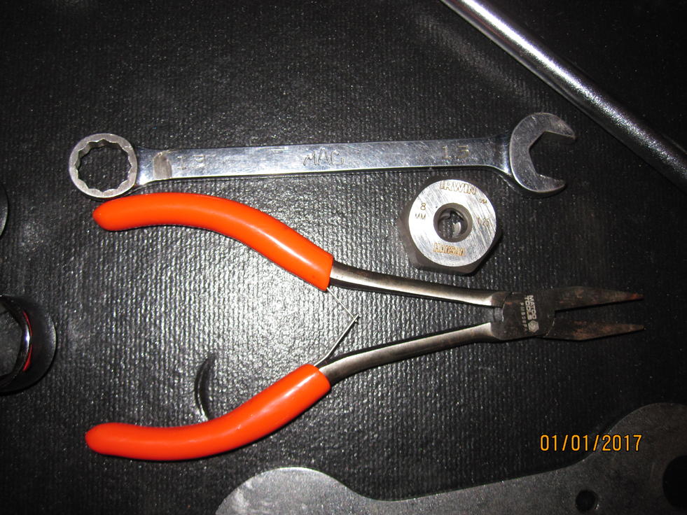

This thread is old but helped me a great deal. I got the clues from reading posts from [MENTION=84640]bigbillyt[/MENTION] and [MENTION=65614]Antman[/MENTION].
Below is the tools that I used to hold onto the sheared 13mm nut and unscrew 12mm bolt.
