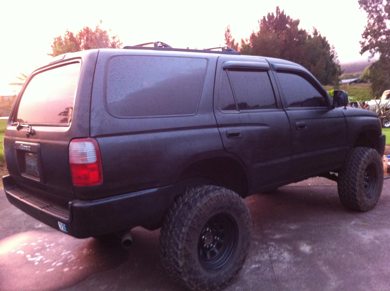

Here's the runner 97sr5
5spd
285/70/r16 nitto trail grapplers..

Not that much weight I have my sub and box in the back
As well as my surf boards... Can the weight affect the bounce?

Good looking truck.
