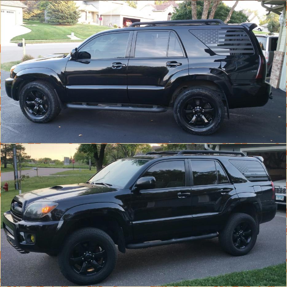

I have the same rig & just replaced everything with a full 2.5/1.5 Dobinsons IMS kit. Slight lift, no more rake & can go bigger in the future if desired. Little more expensive but I'd rather have a slightly overkill setup even if I don't wheel much. Honestly if your XREAS is leaking, anything you throw in there is going to feel night & day difference. Replacing links & bushings, or adding some wheel spacers and control arms is all beneficial but not necessarily for everyone.
Top is stock. Bottom is with IMS & Spidertrax
Damn that is beautiful. I like your choice of rims.
