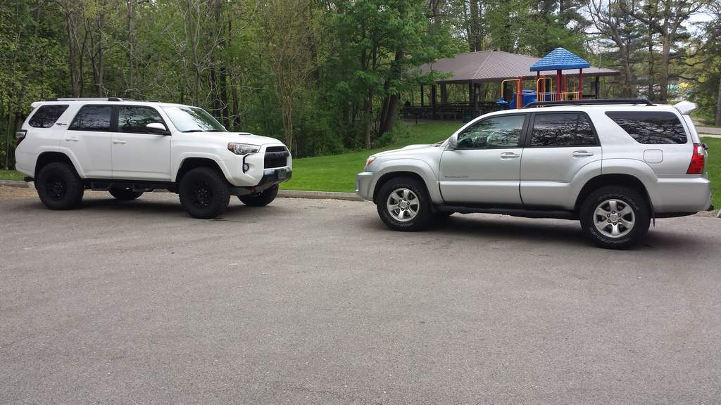

youre very welcome & sorry for the late reply. i have posted before about the lift KYBs provide, it is about 1-2" over stock height in the front due to the fact that the KYB shocks & springs are ~10% stiffer/firmer than the original stock shocks/springs. when i first installed mine it was more like 2.5" above stock but it settled down after about 50-100 miles & now sits as shown in this pic, definitely an easy 1-1.5" lift up front & it has stayed there for 2 years & thousands of miles now.

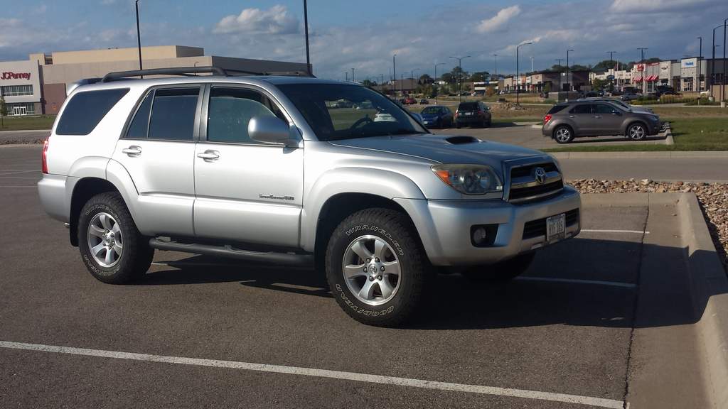

heres another pic showing how it sat when i bought it with 140k miles & original but not leaking XREAS, im using 265/70 tires that are one size above stock height but same width, no rubing at all. im very happy with the height & ride quality of the KYB, if i need it any higher i can buy the lift spacers but i have no need for that as this 4runner is not used for off roading, just a nice daily driver with some light utility use & towing.
