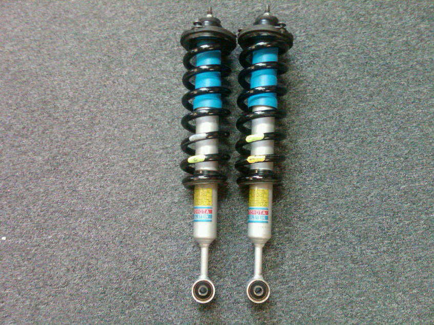

here's the pic. Tell me what you think.

The thing I don't get how some of the posts I've read people say put the longest one on the drivers side but when they are allready put together there is not a longer one because both the shocks are fully extended. It does not matter what spring you have because the shock only extends so far thats why when I measure them there are the same length. So do i have to take them a part to find out for sure?
Might just be my imagination, but from the picture it looks like where the springs start on the bottom are lined up, and on the top the right one is just a tad longer, i just received some FJ springs and shocks and the yellow/gray is just about 1/4 inch longer if you measure from upper pearch to end of spring. So that would go along with what others are saying that yellow/green are drivers and gray/green is passenger
Are yours still together? Mine measure 13 3/8 from the top of the perch top the bottom of the plate the spring ride on. Both are the same.
Mine are still together, but the more i look the more they look similar, might of just been the way they rolled. I think you should put them on and let me know how it turned out so i know how to install when i do it in a couple of weeks.....:) All I can say is it seems other people have did it before with yellow or orange on drivers and gray on passenger and it worked for them.
