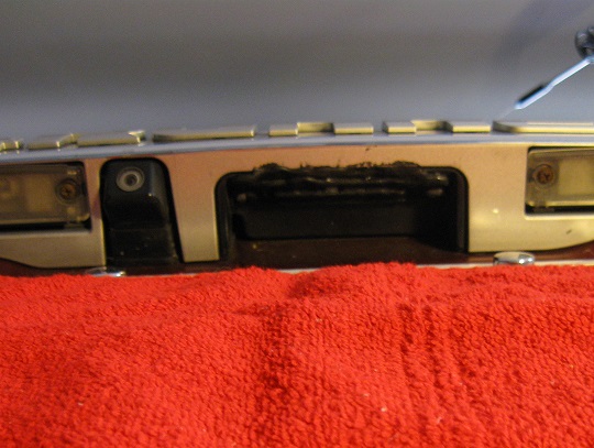

Help: Hatch Handle Melted

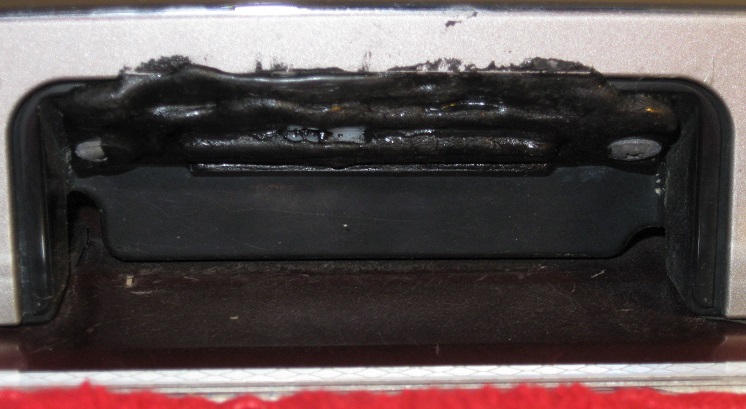

Tacky Melting Hatch Release Cover

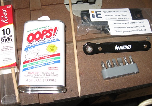

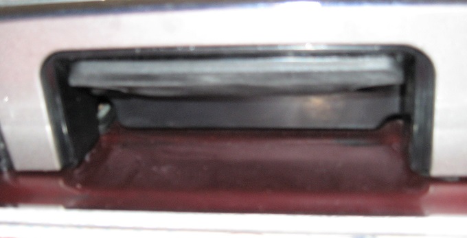

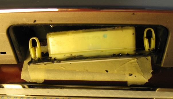

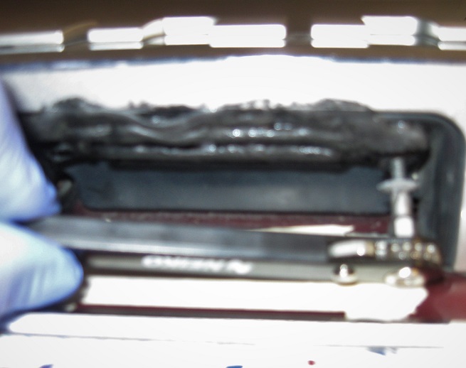

Replaced my hatch switch cover that was melting away, I bought the 2010 Trail used and don't know what caused this cover to melt into goo. I bought the cover from Amazon previously mentioned and a Neiko screwdriver for close quarters. After removing two Philips screws I proceeded to scrape away the goo with a wooden finger nail stick. After a lot of scraping I used some Goo Gone to wipe away some residue. The amount of melted rubber was about 100 percent, I recommend attending to this at the first sign of a tacky feeling. Replacing it earlier would have been so much less effort. Once enough residue is removed along with the two screws the switch assembly can be pryed out at the screw hole area. Once switch is out I had maybe a half inch of slack in the pair of wires, too bad there was not more and perhaps the connector for an easier complete replacement.

Considering the time it took , with 5 pairs glove, 1/2 can goo gone, tape , spudgers , tool and part, I probably have about 30-35 dollars into it. I'll seriously consider a new complete switch if there is a next time and splice wires from outside.
